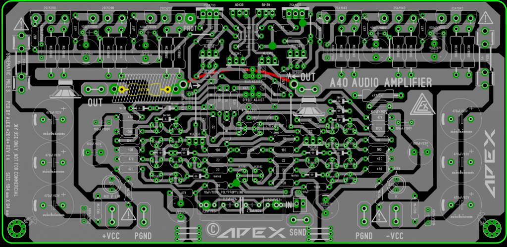

In post #2 there are gerber files for v1.4 Is that what we should order to build the AX40? I ask because I am confused by the additional versions (but no gerbers) in the following posts.

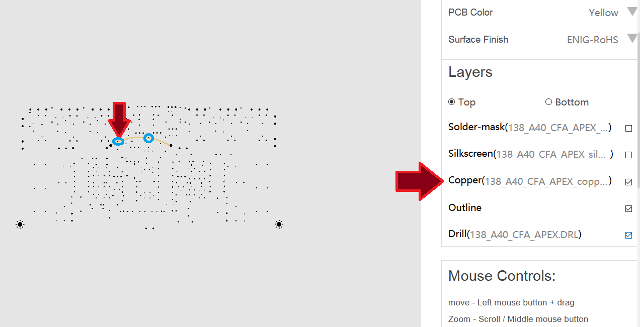

Also the gerbers (see the attached gerber viewer screen shot) seem to only show one copper arc on the top side. But that copper arc intersects four vias including two small ones that I have circled in blue.
Is this supposed to be a single copper layer board? I don't even see copper capture pads on the top copper layer.
I am worried that there is something wrong with the top copper gerber file. (No capture pads and the one copper arc which looks like it would short to two small vias.)
I tried checking with three different gerber viewers.

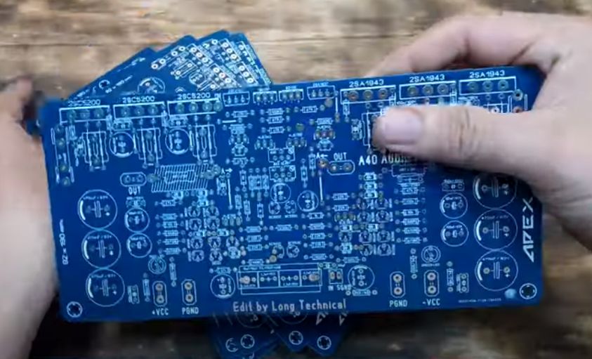

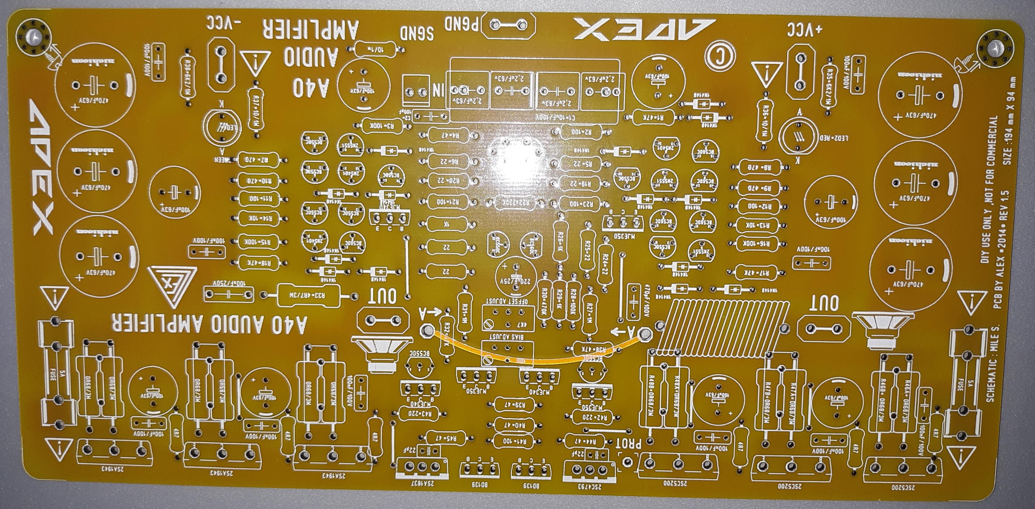

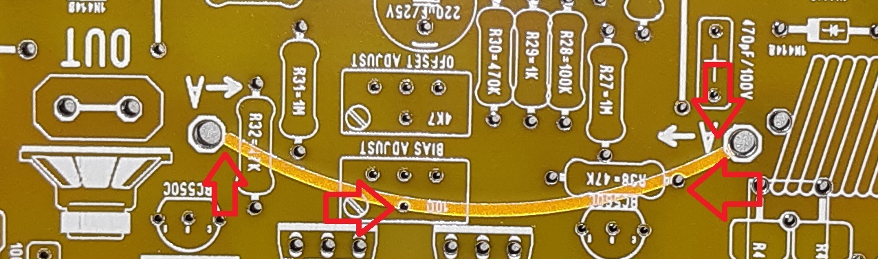

Unfortunately I did not get any replies so I went ahead and ordered the PCB attached in this thread but it looks like there is a problem.
I have attached pictures of shorts on the front side.
I assume I should dremel away the top copper trace. (The gerber files in this thread have a top copper layer with one copper arc.) It looks like the amplifier will badly malfunction with the shorts to the trimmer and resistor.
Perhaps this post can serve as a warning to others regarding the gerbers in this thread. I hope that the amplifier works when assembled with these PCB after the dremel fix. The parts are fairly expensive for two of these boards so I hope the gerbers attached to this thread are good...

Sorry missed that. You will need to cut the traces, or search on YouTube for APEX A40 long technical and download/use those files. Or take your files and correct gerbers in PCB software.

A new top copper layer with capture pads and a rerouted jumper would be nice...
