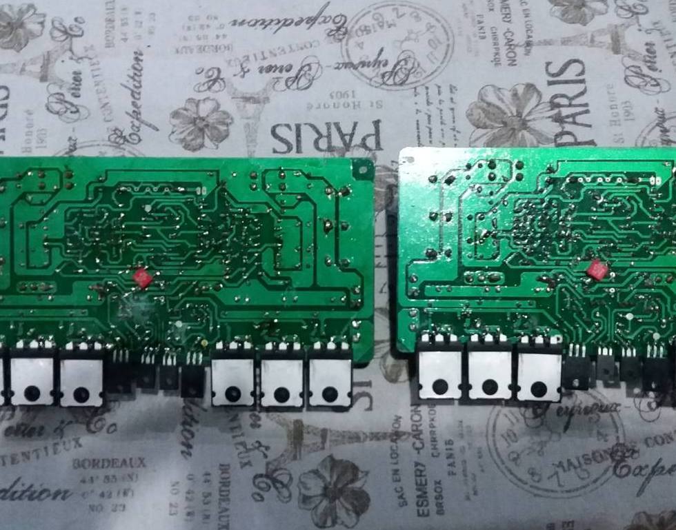

estou com problema de captação de ruído no a40,ja retirei o transformador e a fonte estabilizada do gabinete e nada do ruido acabar,acho que o ruido esta no pcb,o terra está cobrindo os espaços vazios,alguem teve esse problema?

I have a problem with noise capture on the a40, I already removed the transformer and the stabilized source from the cabinet and nothing stopped, I think the noise is on the PCB, the ground is covering the empty spaces, did anyone have this problem?
Please,
Contact me by PM. I faced lots of this kind of problem in Telecom area where the telephone got local radio and PX.
It support will cost you a pair of bare boards for layout evaluation and possible solution related to the board.
Ronaldo

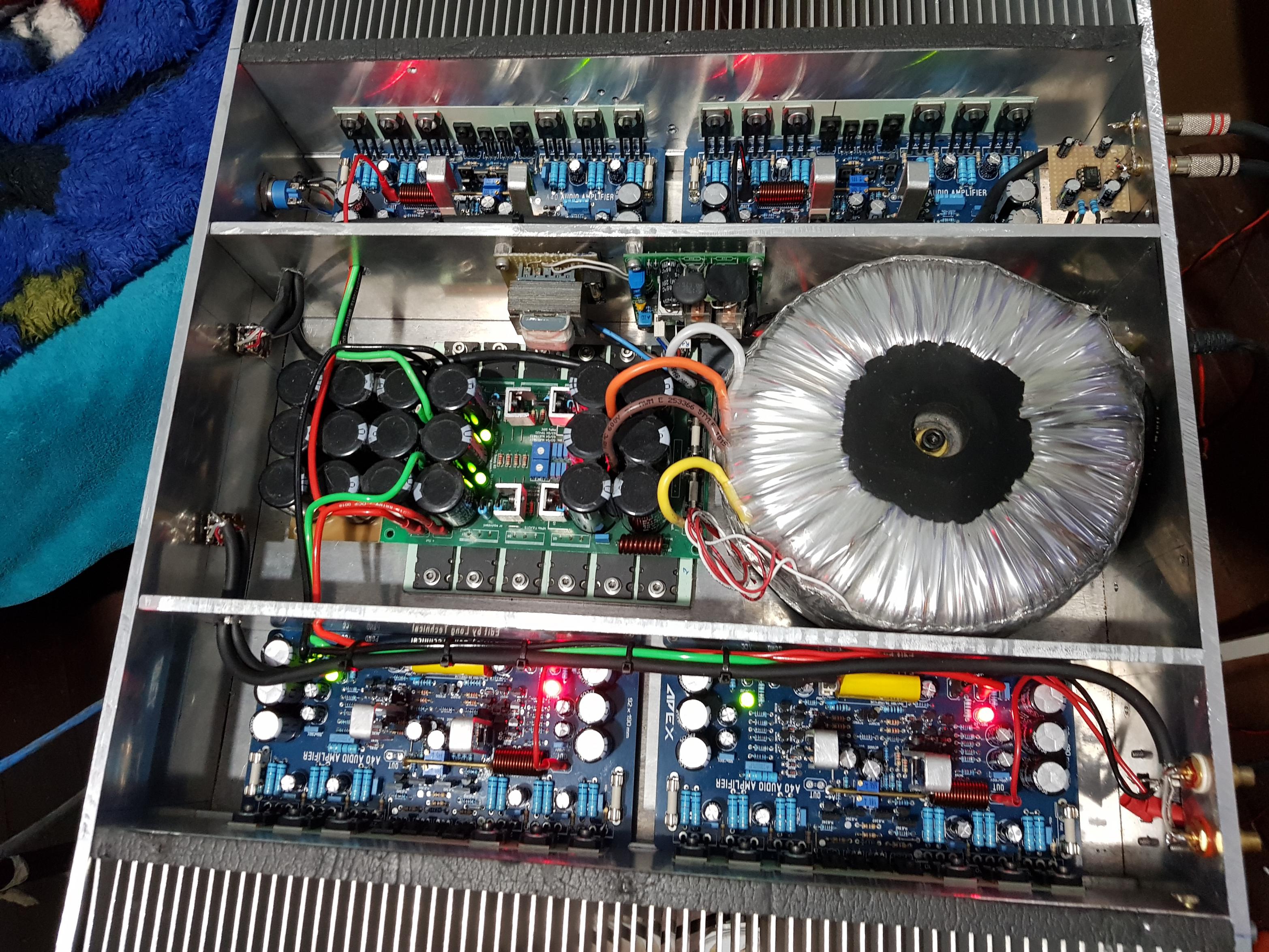

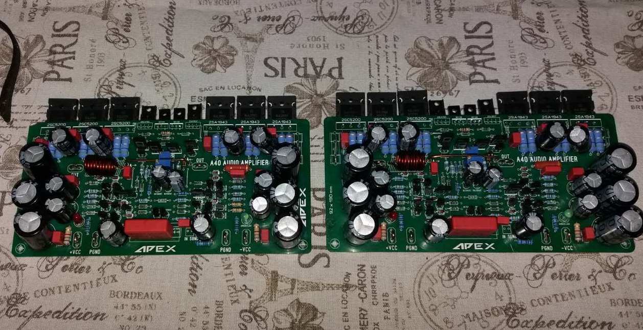

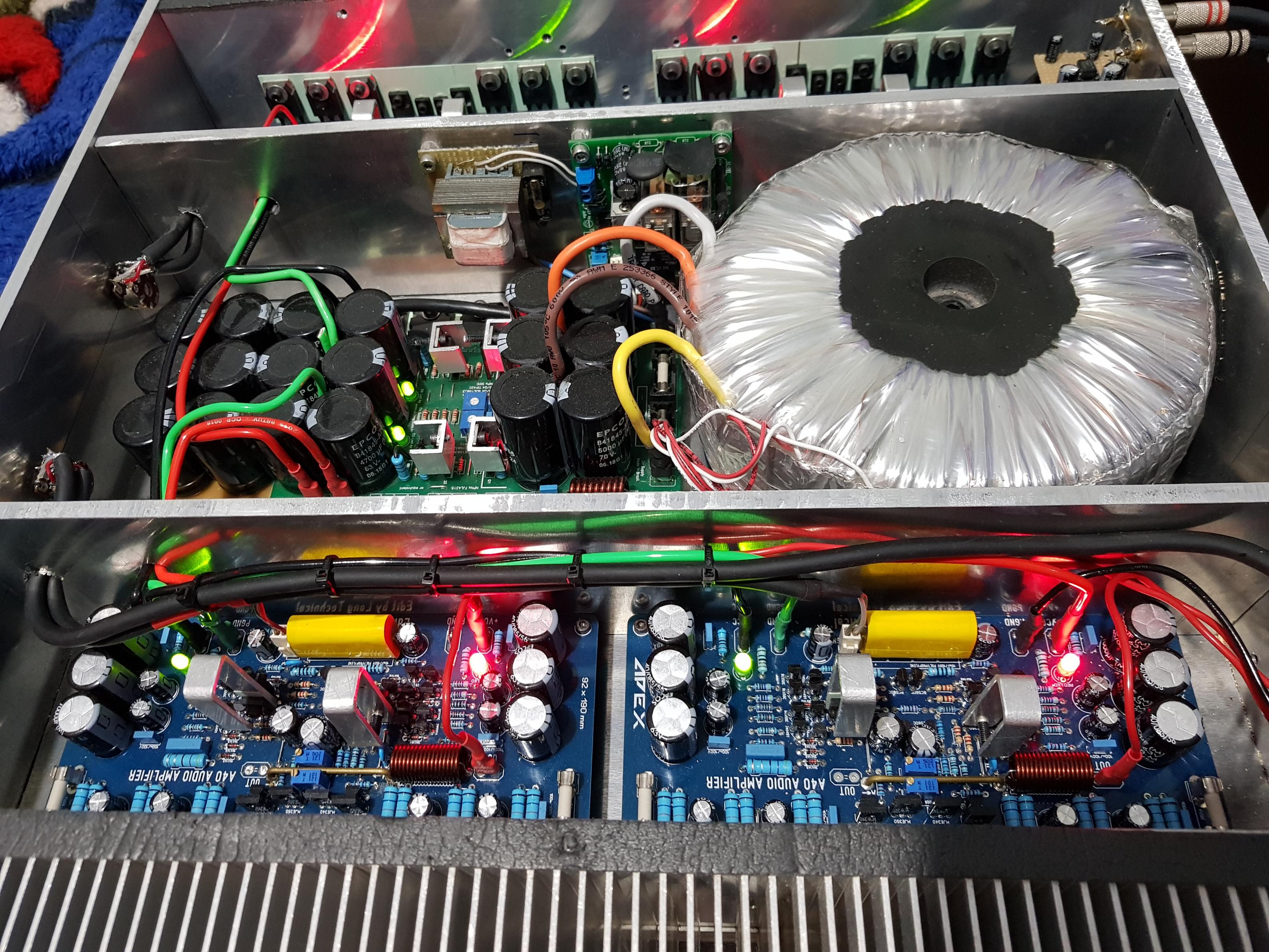

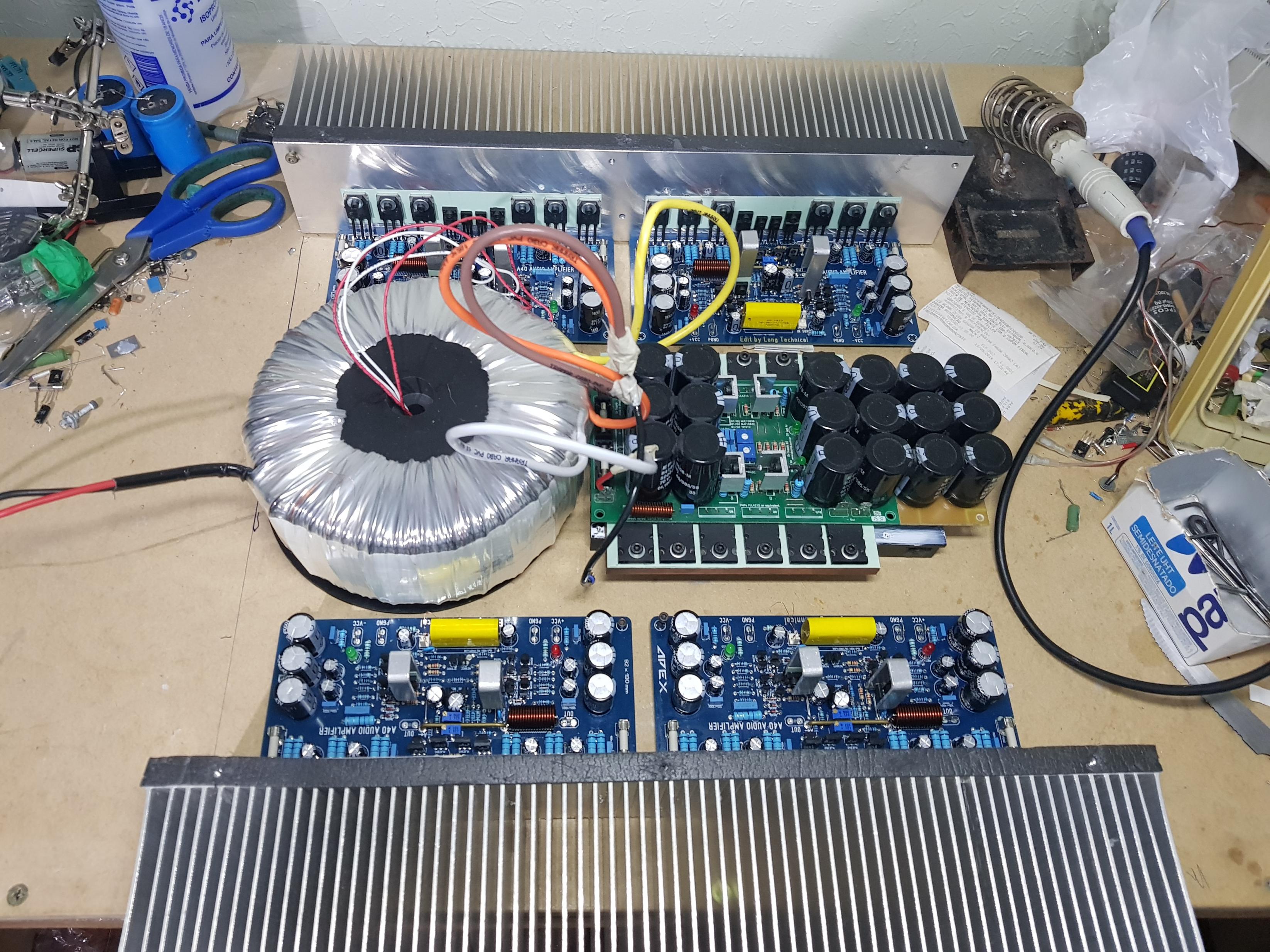

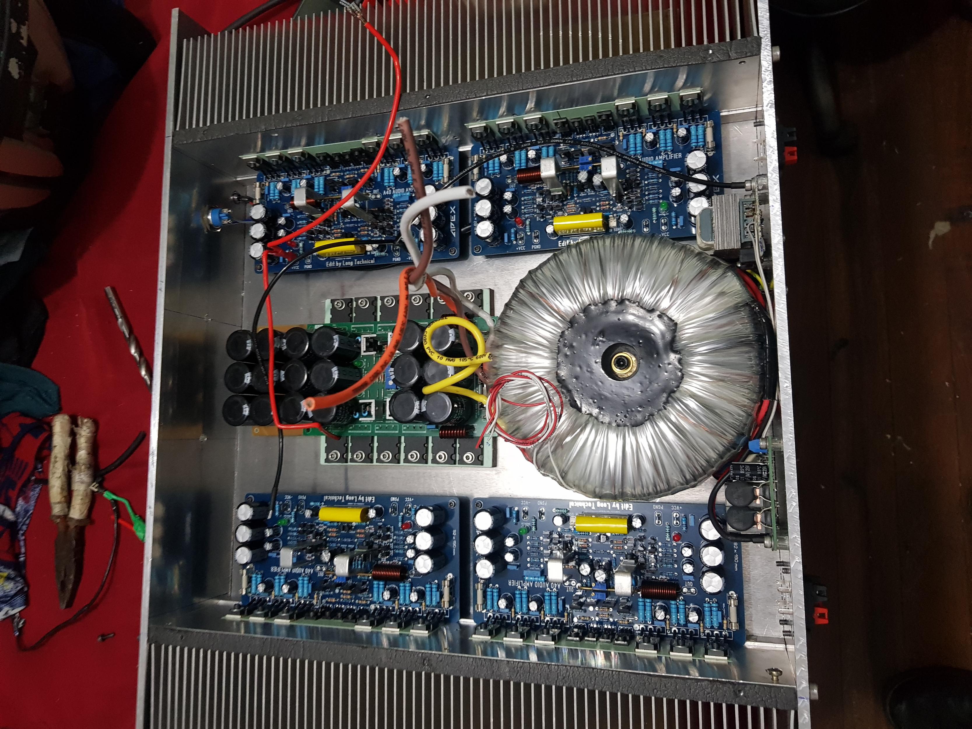

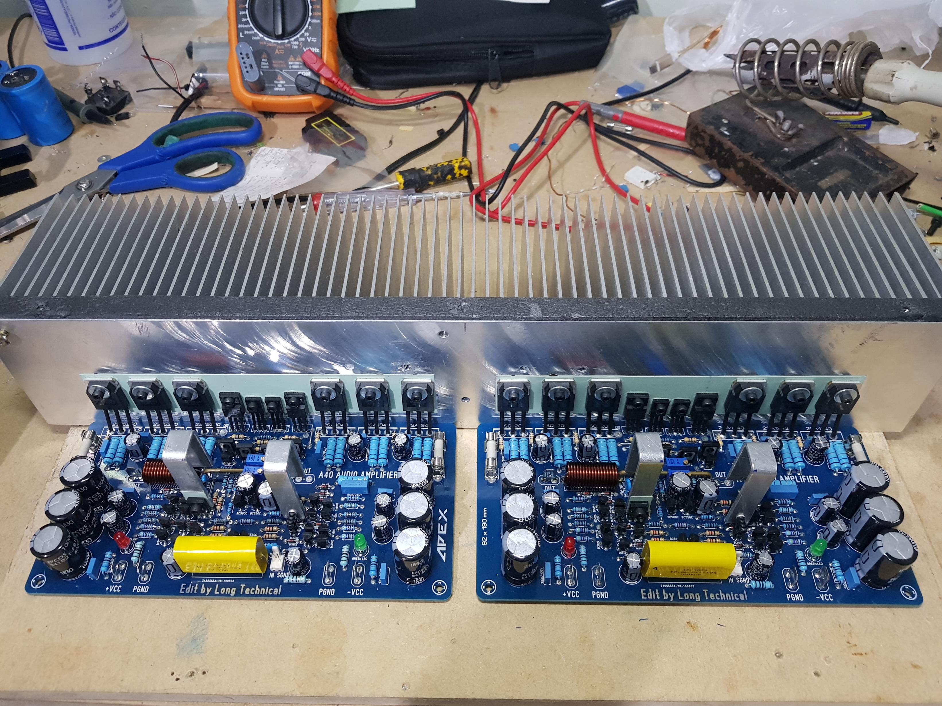

Hello all Apex fans.
I can't wait to show you how we turned the A40 into a real monster.
There is more work to do, but I will show what we have been through so far.
Of course, the concept consists of 2 monoblocks.
We removed the 52 volt power supply.
We replaced many of the circuit board elements ..... terminal transistors, capacitors, resistors .....
We added a 100 pico capacitor to the servo to improve the frequency response of both electrolytes.
We set the rest current to 600mA by putting the circuit boards in 39 watts pure Class A.
2 boards work in bridge mode up to 300 watts.
Sound cannot be described in words.
Control of the speakers is palpable.
When I'm done with the exterior design, I'll show it to you and let you hear it.😀

it looks excellent,but it is not 39W A-class amplifier with 600mA bias. with 8r loudspeaker it is 2,88W A-class amplifier,and with 4r it is 1,44W A-class amplifier. anyway,I have no doubt that it sounds great!Hello all Apex fans.
