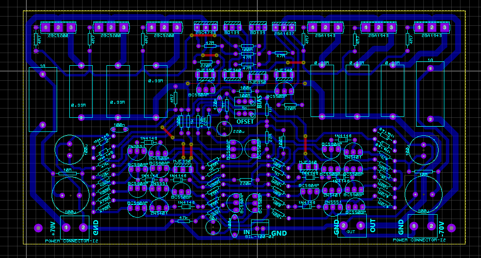

hi sir. i have build A40 a day ago and tested. there is an issue. the issue is with offset pot. when power supply is connected there are some voltage at output and offset pot does not do any thing to offset voltages. other than that two transistors MJE340 and 350 at input stage are heating up without any signal. pcb is my own designed.

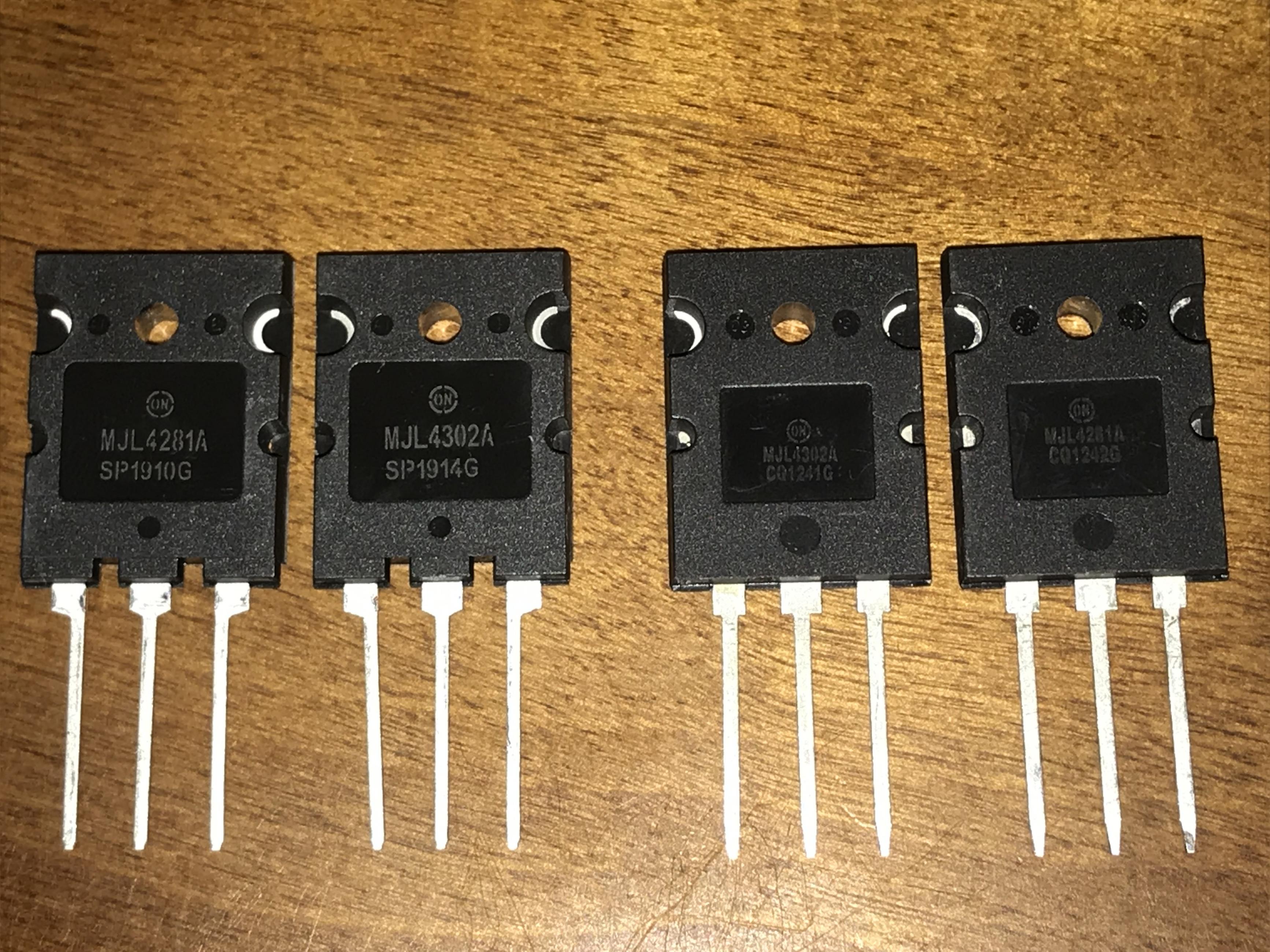

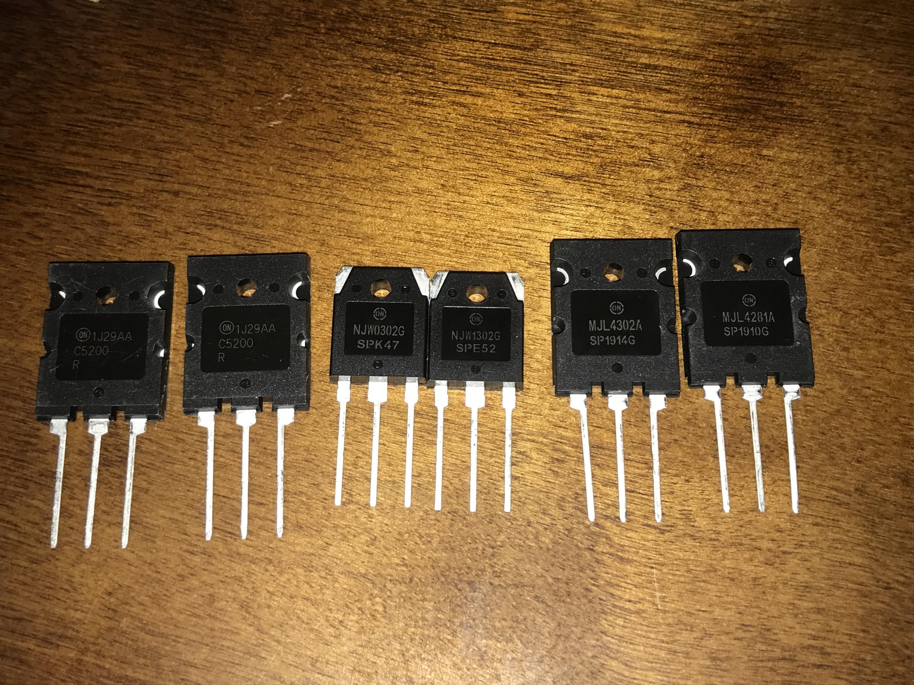

These are some picture of the power transistors could be used for this amp.

I would suggest u to check ur pcb. Yesterday i assembled A40 on alex's PCB , started at first tym. Mjes are in VAS get hot no problem with it. Just review ur pcb its better to use alex,s .
thanks for reply. i have attached my pcb if you can look on it. if you have unmirrored black pcb layout of alex,s pcb then give me please. i realy want to build this amp.

hi alex. i have some issues with my pcb. i cant adjust offset with pot. is there should be 470k or 470R resistor and is it normal for mje340, 350 at input side to get hot even on low operating voltages ?.

rehman.....I do not understand English well, but as far as I understand you have a problem with the scheme.
If the board is executed correctly, there should be no problem, and it works from the first time.
You have to be careful with the bindings and there is no shortage of tracks. It happened to me but I found it.

just one last question please someone solve my confusion.😕😕😕😕 which of the following is 100% working and ok PCB??. which one should i made.?? should there be 470R or 470K resistor with offset pot?🙁🙁🙁🙁
Use 470K resistor with offset pot, but amp also will work with 470R, this is not your problem. You made some mistake on your build, post pictures if you need help. All schematics and pcbs is 100% working.
470kohm is the proper value.

thanks for reply. i will go with pcb i have attached with 470K.
