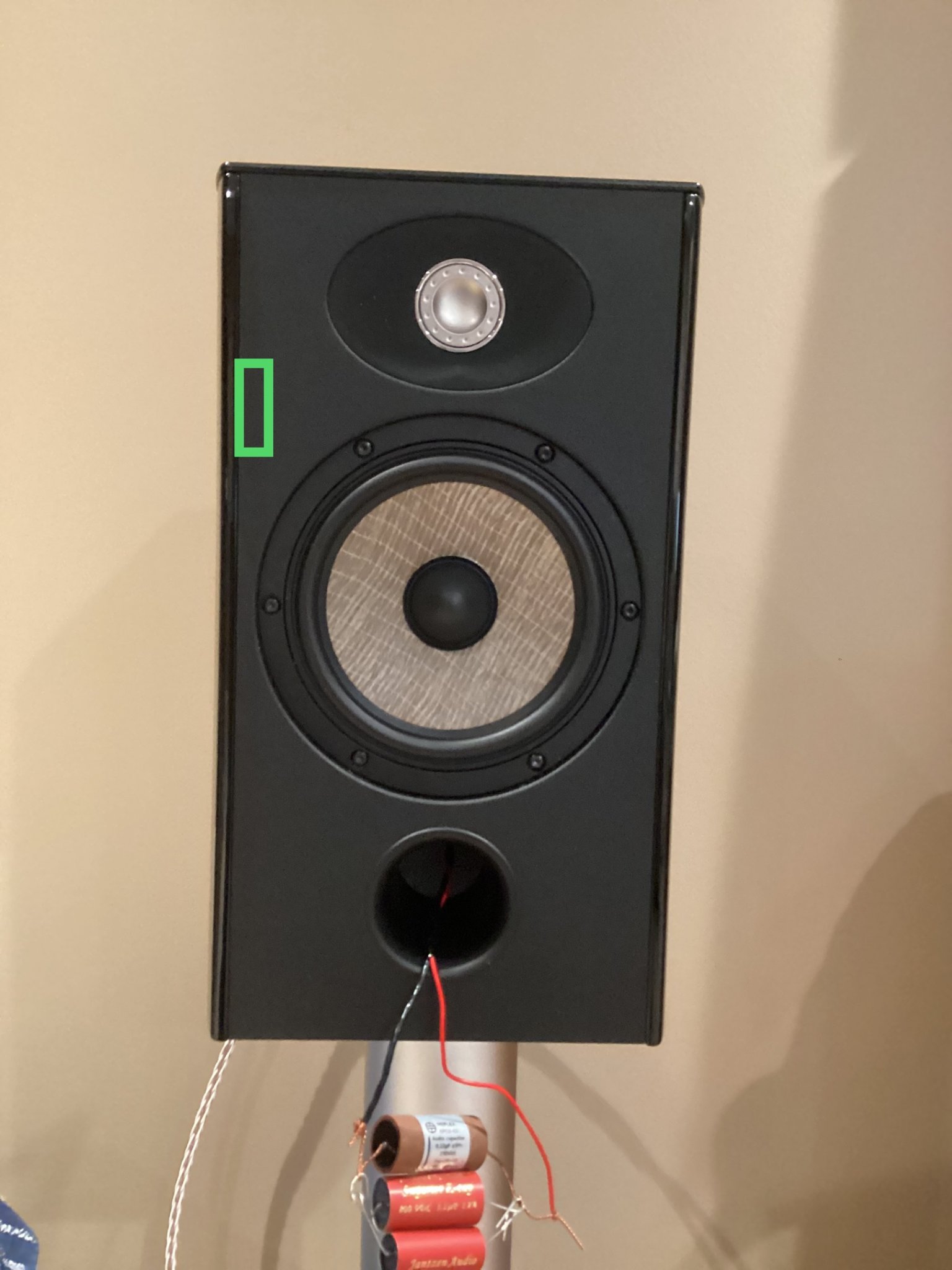

Going to try doing a crossover upgrade on my 906's from 2020
Reading through the thread below is my parts list
Not sure if I could get by without the 0.022uF cap on the tweeter.
Please let me know if anything needs to change on the parts list

I do find that some piano notes and female vocals can quite fatiguing (ringing)
Not sure if its related to the cabinet, and if a 2inch dowel as a brace could help

Cool, I have a 0.22 uf KPCU in the tweeter circuit and it appears to introduce a mild lushness. Cumulative capacitance is roughly factory value of 2.7uf. It’s nice.
I had an interesting observation on cabinet bracing. Speakers have consecutive serial numbers but bracing didn’t match. One speaker had an extra small piece (1.5”x.5”x.5”) at the front and another at the rear both also attached to the side panel.
I went through several bracing iterations. Found dowel front to back killed the sound. Settled on construction adhesive on inside of front panel under tweeter to help dampen the 630hz resonance. In addition a small block of wood (green box in photo) connecting front panel to side panel to further reduce resonance under tweeter. Also construction adhesive on inside of back panel just above the crossover cutout. This one helps reduce the 800 hz resonance.

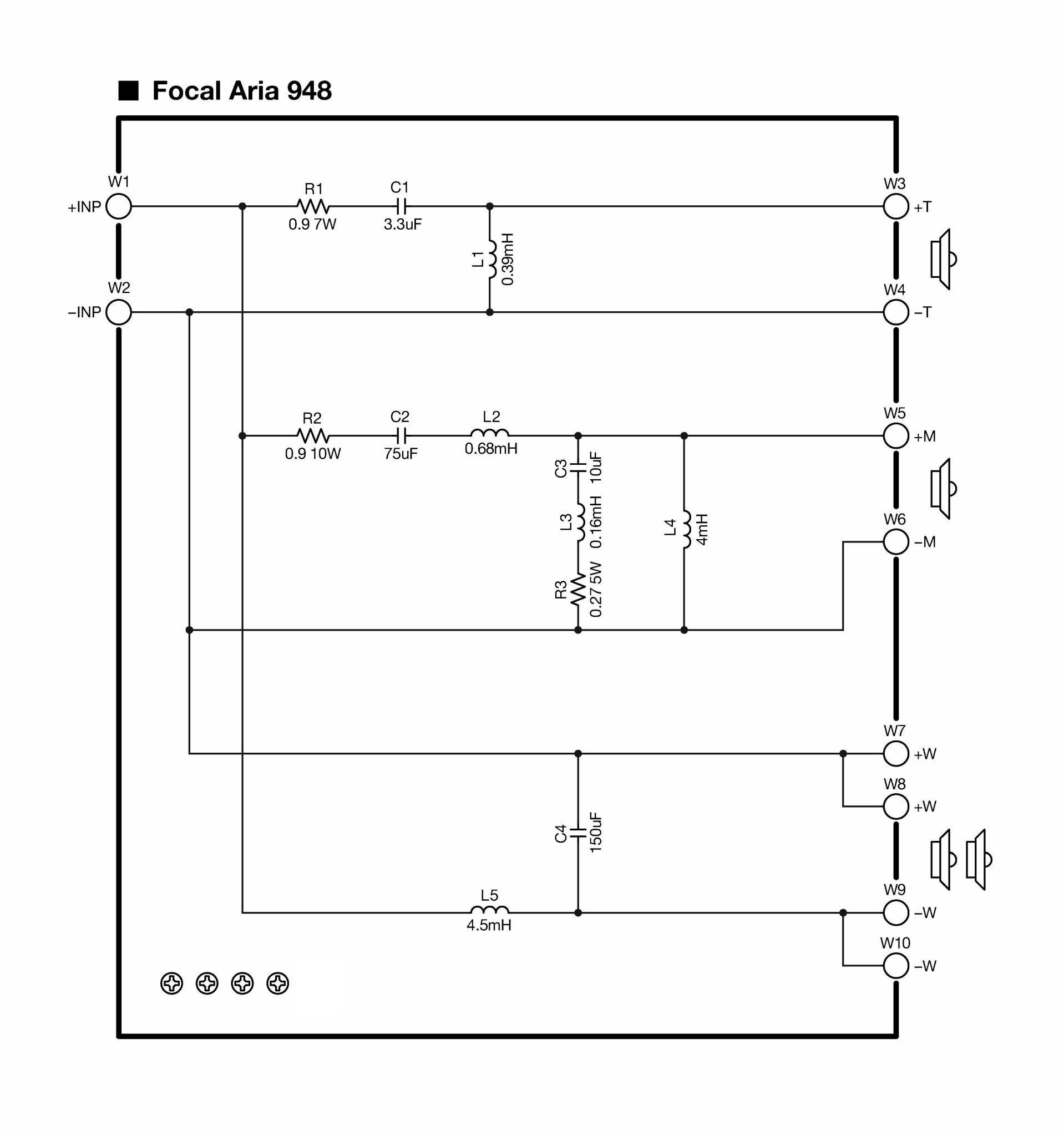

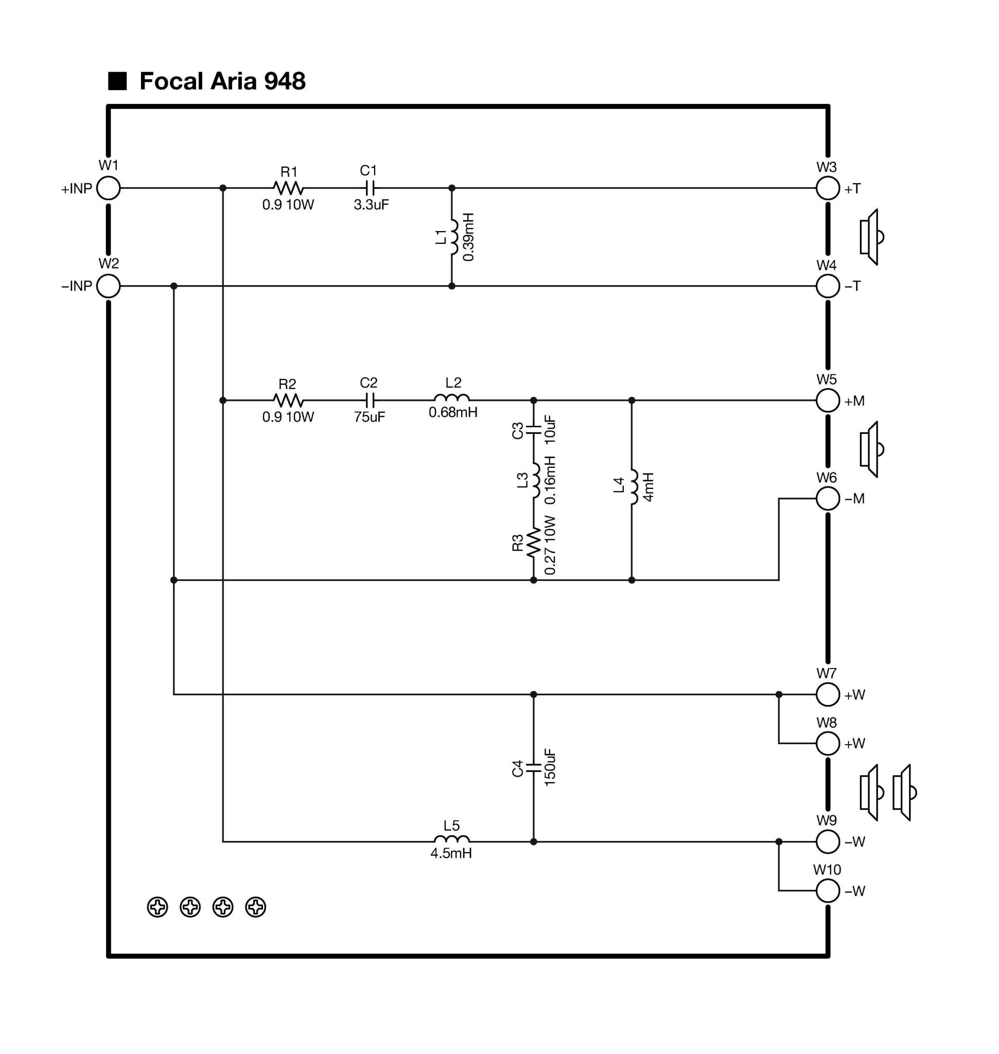

Has anyone done anything similar to the bigger Aria's ? I think they are desperately let down by the lack of a biwiring solution. I'm thinking of making new filters for my 948's.
I suspect the 948 crossover will have some of the same parts as the 906. The question is did focal cram all the components onto a single board? If you can share pics it will likely be straight forward to get a partial parts list/ schematic and next steps for biwiring.

It appears to me these were set up for bi-wiring from the get go, but weren't because of ehm...marketing ?

OK. I should've said 'allegedly modded' though. The poster claims many things, but offers no details, and doesn't reply to comments on his clips.
I'm grad you posted this though. Upgrading my 948's to bi-wiring has been on my to do list for a long time, and maybe this will motivate me to get started.

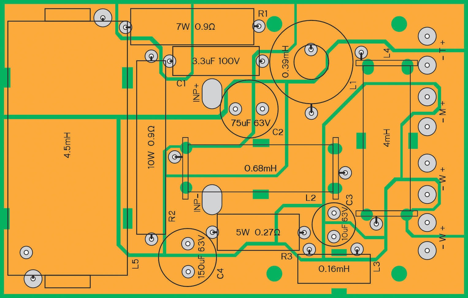

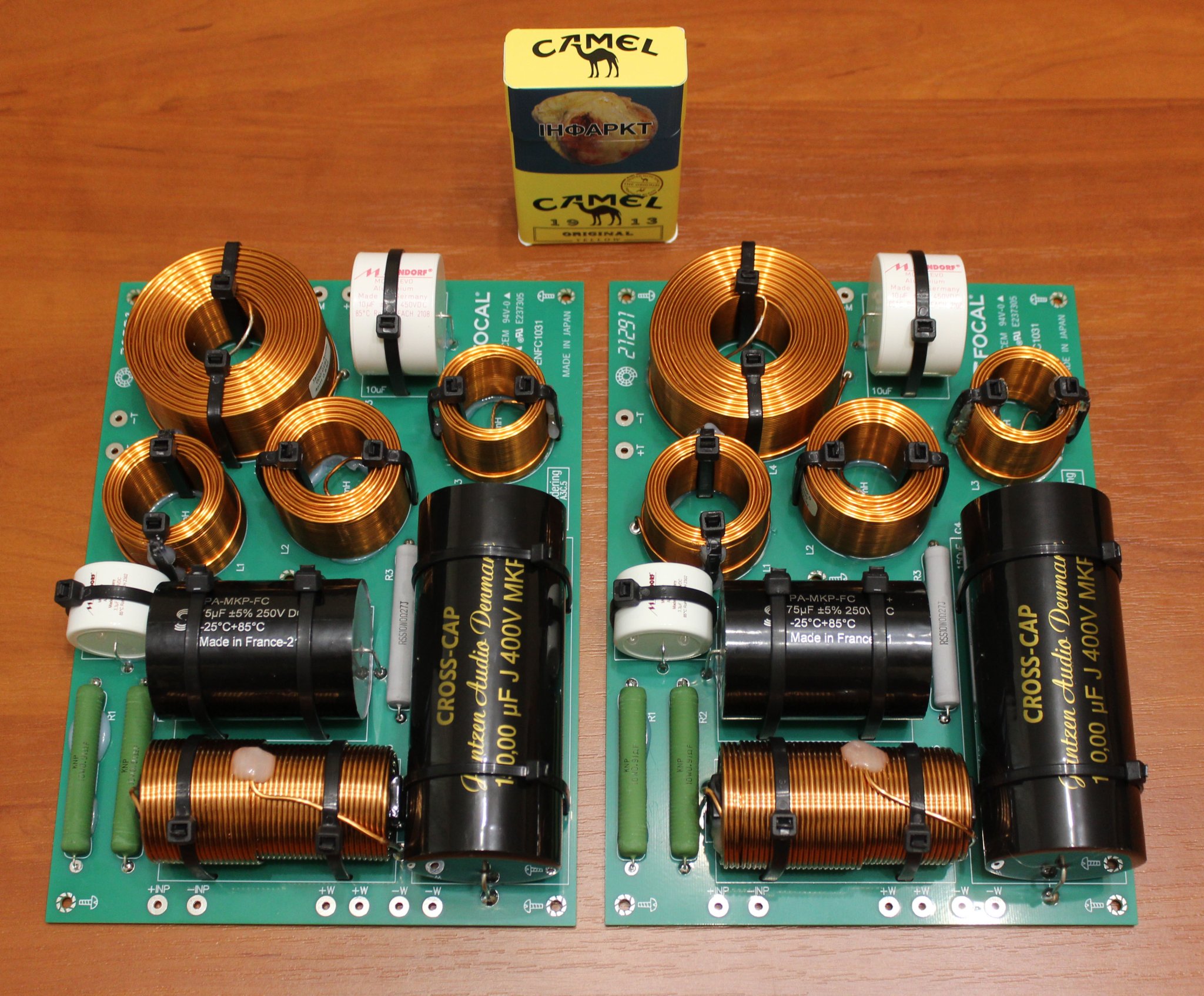

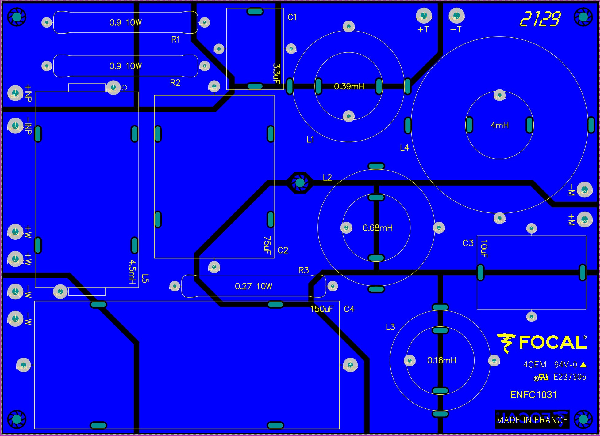

Pre-made a board layout for an inexpensive upgrade (a friend asked me to do it)
Board size: 220x160mm
AIR COILS:
2pcs L1 0,39mH 000-1181 Jantzen Air Core Coil AWG17 0,39mH 0.24Ohm OD41/ID25
2pcs L2 0,68mH 000-1305 Jantzen Air Core Coil AWG17 0,68mH 0.33Ohm OD43/ID25
2pcs L3 0,16mH 000-0232 Jantzen Air Core Coil AWG17 0,16mH 0.15Ohm OD37/ID25
2pcs L4 4,00mH 000-0181 Jantzen Air Core Coil AWG17 4mH 0,83Ohm OD65/ID25
CAPACITORS:
2pcs C1 3.3uF ME-3,30T3.450 Mundorf MKP MCap EVO axial 450 VDC 3,3uF D30-L21mm
2pcs C2 75uF Solen PA 75uF 250V Fast Capacitors D44-L60mm
2pcs C3 10uF ME-10T3.450 Mundorf MKP MCap EVO axial 450 VDC 10uF D40-L27mm
2pcs C4 150uF 001-0294 Jantzen Cross Cap MKP 400 VDC 150uF D45-L112mm
RESISTORS:
4pcs R1, R2 0.9 ohm 002-0148 Resistor Jantzen Superes 1% 10W 0,91 Ohm D8,5-L53mm
2pcs R3 0.27 ohm 002-0382 Resistor Jantzen MOX RSS 5% 10W 0,27 Ohm D8,5-L53mm
WIRE CABLES:
6m red 2.5mm sq 006-0052 Jantzen Audio 2.5mm2-13AWG silver plated PTFE wire, red D1,8mm
6m black 2.5mm sq 006-0051 Jantzen Audio 2.5mm2-13AWG silver plated PTFE wire, black D1,8mm

This is most excellent, thank you. I am going to cut the low/mid-high up for bi-wiring though. Do 2 circuit boards.

The 948 upgrade is an interesting thread. You may want to consider upgrading the bindings posts as well. From what I understand, the biggest bang for the buck will be upgrades to the tweeter and mid circuits. For biwiring one could use the existing board/ components for the two bass drivers and a new board for the mid/highs. It’s just a thought given size and cost of upgraded woofer crossover. Yes, new wiring to all drivers.
