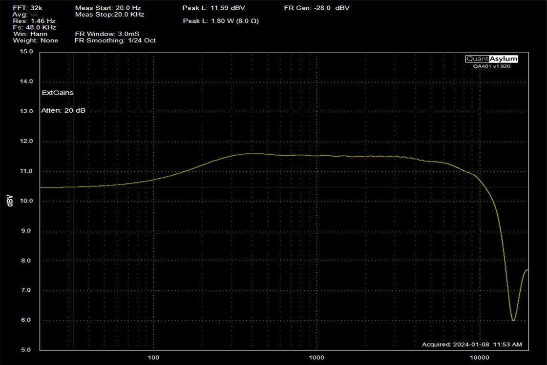

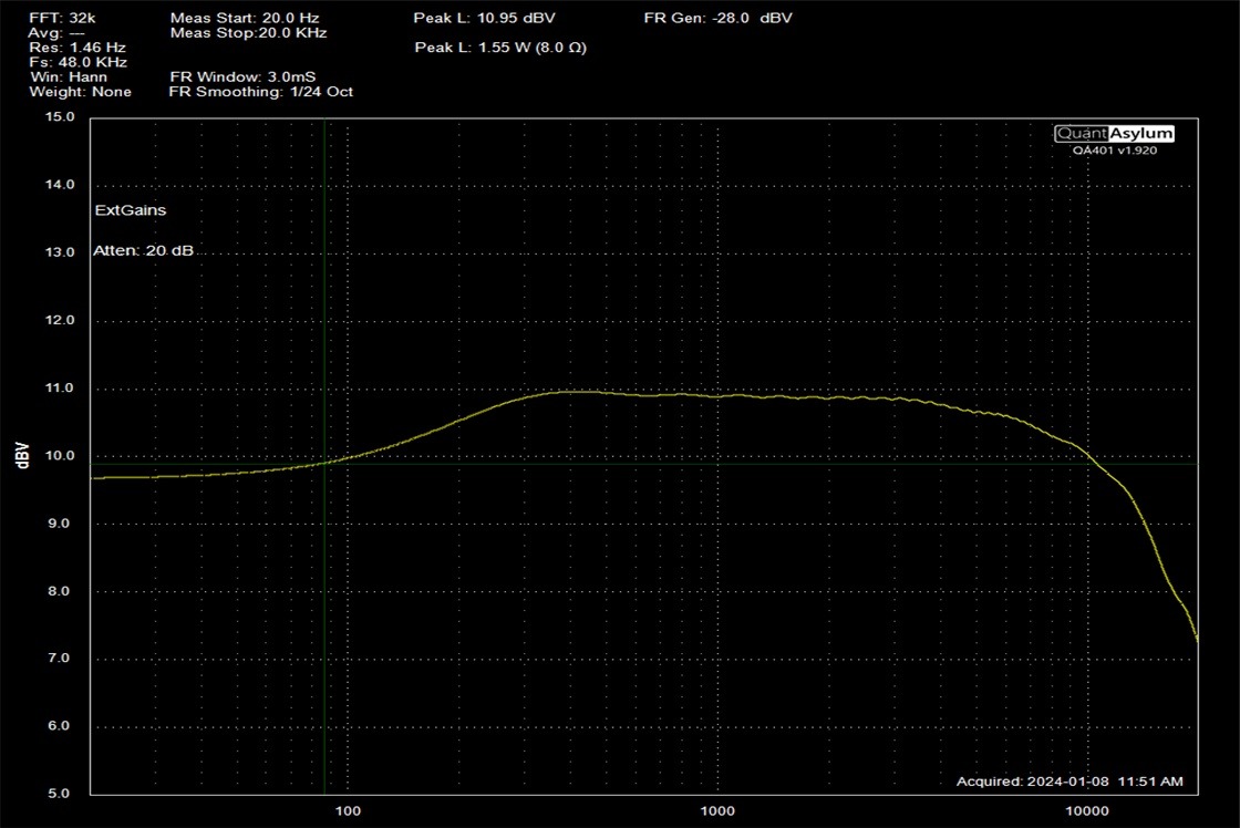

The 304TL has a far lower driving impedance than 1.4K. Really these high frequency response issues are primarily going to be determined by the output stage and whether you have any feedback around the output transformer (which you definitely shouldn't with these!!!).
I'm running 810s at a little more than 800V/150mA.
I also posted a frequency response graph of a Monolith transformer soldered into the circuit temporarily to demonstrate how horrible this Hammond OT is.

I would not get full power with an 8 ohm speaker on the 4 ohm tap. Yes, I would get slightly less THD since the load line will flatten out (at most frequencies at least), but I'll still only swing from B+ to where plate current and grid current are equal, and that just isn't going to move much between 5K and 10K.
I have a 1.4K source by using feedback between the 810 plate and my first stage. (and also by double checking my work with measurements)

Well if you have some really bright horn speakers or a really hard room, these would certainly tame down aggressive high frequency response; I certainly would not be happy with this kind of performance.

My pair of discontinued and flawed 1628SE show a ~4 dB drop at 20 kHz on the 4 ohm secondary loaded with 8 ohms when driven UL. Recent open loop measurements attached. Feedback isn't a panacea. The transformer's reduced HF gain means reduced feedback and increased drive requirements. The cost gets moved upstream.
