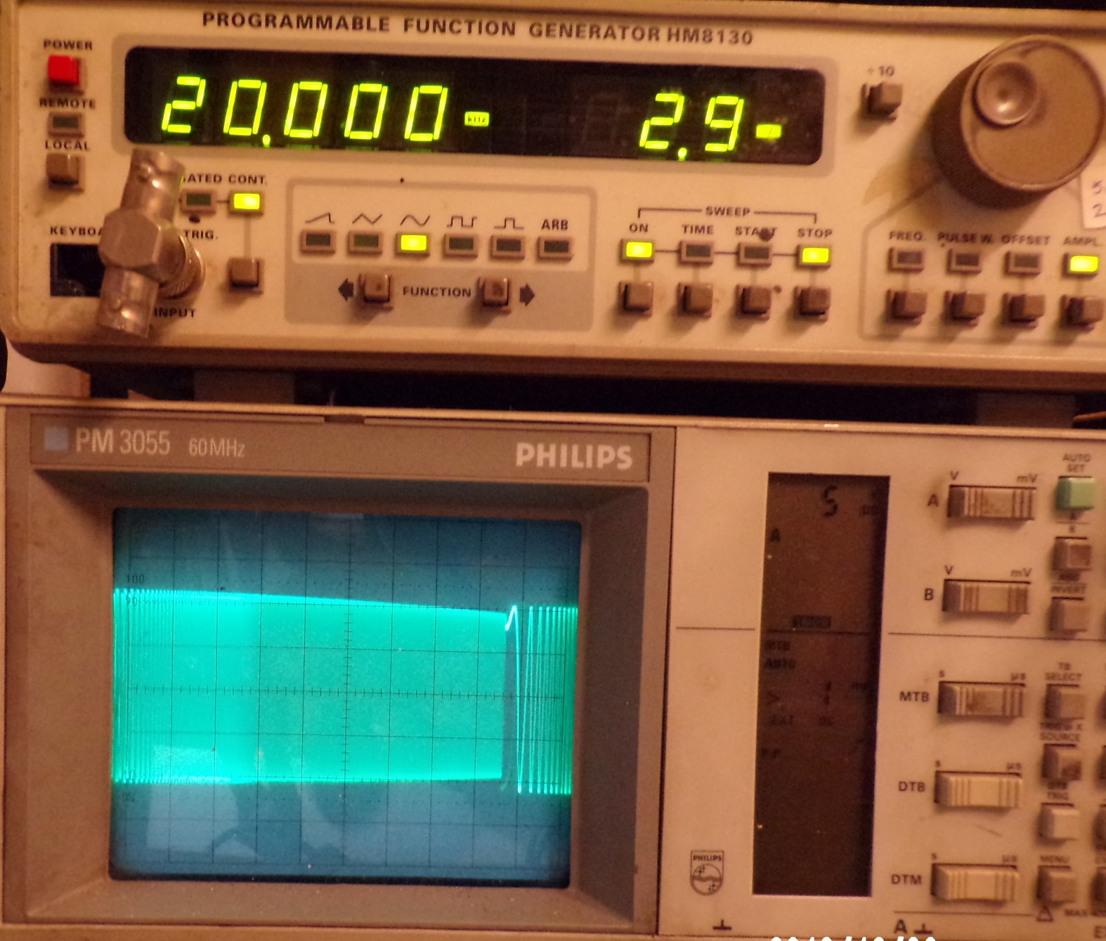

its one old tread but i see only now

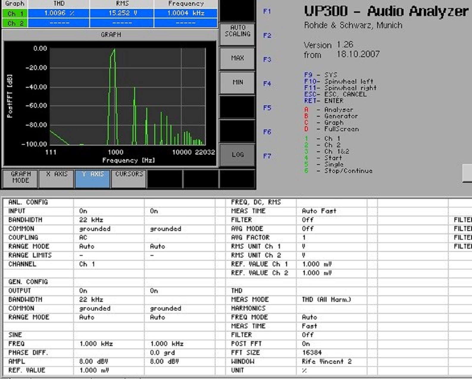

the hammond 1642se its very good i use for 304TL 1K2V @ 02/025A
1%THD @28W and over 75W A2
304TL SE - Google Drive
linearity its not bad and low end great

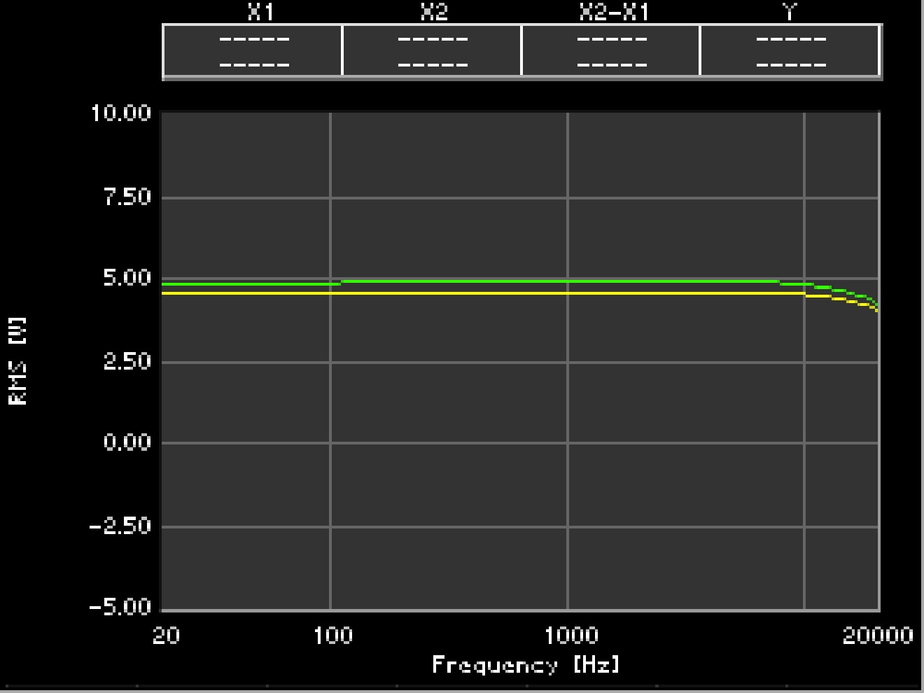

yes -2db@20Khz 5K:8ohm
its no global feddback amp
CF direct coupled 6BX7
jellow and green are channel one and two

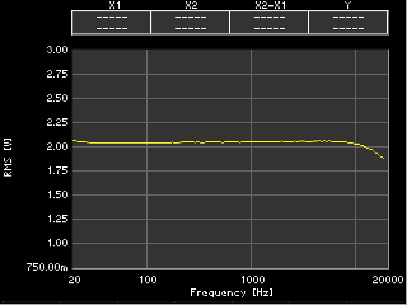

one channel @2V:
one channel @2V:
What's the damping factor of the amp? (Trying to determine what impedance you have driving the TX capacitance)
I do not have the equipment to measure it. I connect the 4 Ohm taps to Mangepan 0.7 and 8 Ohms (between the 8 Ohm and 16 Ohm taps) to Magnepan DWMs with their two 4 Ohm elements in series. It sounds fast and mages well.
will probably take a crude measurement next day off out of curiosity. There is a more interesting measurement I took. Because the curves in the chart fr the 833A are too crude to tell at what plate voltages and grid bias voltages the 833A is most linear I used some household batteries and I already have a DC milliammeter between the cathode and ground.I found that I can pull the cap plug off the grid. Of course the plate cap has a safety collar to make it impossible to touch it for the obvious reason of 1000 Volts on it. Connecting the battery between the grid cap and ground and getting the same increase in cathode current as the decrease I get when I reverse the battery polarity is a poor man's way to verify the 833A is linear at zero applied grid voltage. This is extremely convenient because I don't need a grid bias supply and I don't have such a supply in the signal path for the grid input. The WAVAC833A which costs $350,000 uses positive grid bias if I read correctly what little information there is about it. I also doubt for $350,000 you get polypropylene filter capacitors in the 1000 Volt power supply instead of electrolytic capacitors in such an amplifier you can build yourself for about $2000. I also prefer to drive the grid with the more pulchritudinous 245 triode instead of a KT88 and I want my choke-loaded 6SN7 twin triode directly coupled to the grid of my 245.

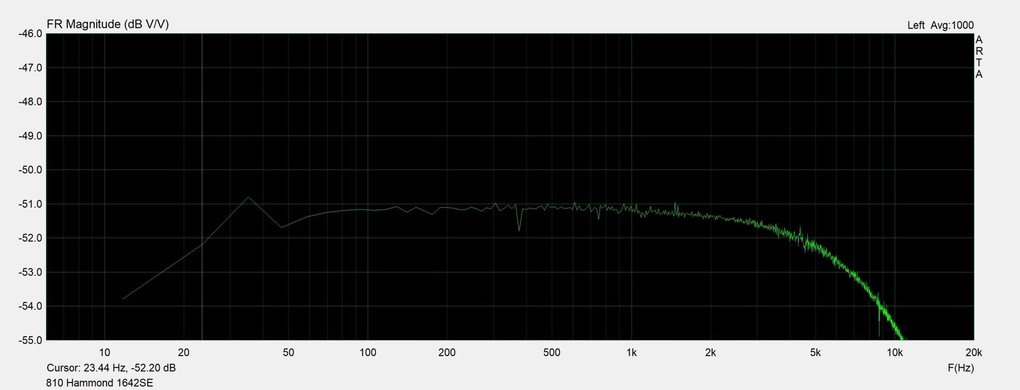

I built a high power SET amp with the 1642 to see how good/bad this is for myself. My source impedance driving the transformer is about 1.4K, so I expected reasonable results into a 5K output transformer, but I ended up with this instead:
This was so bad that I contact Hammond to ask if perhaps they could offer a different part to replace these, then they started making excuses.
Here's the same amp with a Monolith output transformer.
Through my communications with Hammond, I learned that they do not understand the difference between source impedance and the impedance reflected by the output transformer. When I said that I had a 1.4K source and a damping factor of about 3, the QC guy said I must have a 3 ohm load on the output of the amp and a 1.4K source impedance, yikes!
I believe when they are measuring something like the 1642, they are driving it directly with their audio analyzer that has a selectable 25 or 600 ohm output impedance, and then posting that their source impedance is 10K.
