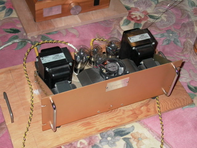

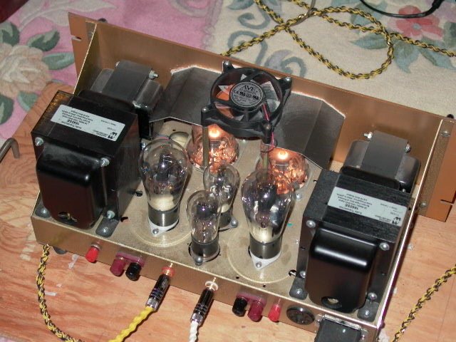

At the time I had visions of building a really big SE amp. I almost did it, but the vendor who had advertized the 1642SE on his web site for a low price refused to honor that price. In fact he wanted almost twice what he quoted on the web site. That project stalled for lack of a suitable OPT.
I have since realized that such an inefficient amplifier would not get much use since I live in a very warm climate. In fact my 845SE amp has not been turned on in at least two years.
There was an article in Glass Audio a few years ago where someone used a Hammond 1650W push pull transformer, sliced a gap with a hacksaw, and used it for a 50W+ SE output. He was very precise about how he gapped it. Not necessary to take it apart, except for the end bells. A little searching would find the article.
The 1642SE is a rather singular monster. One could dream about pairing it up with a couple of GM70s at 900-1000V B+ (not that hard to drive). At the lower voltage, one would need A2 operation to squeeze out the last bit of juice, but w'ere no stranger to that here. Finding someone who actually stocks the 1642 is another matter, as none of my usual suspects apear to. However, if I really got serious about a project like this, I could probably find someone with a little more effort. This is one application where switching power supplies could be of use, transforming a project that would otherwise be a titanic boat anchor (or a huge separate power supply) to a couple of beefy monoblocks. It might be interesting to query Edcor to see what they would charge for a 1642-like transformer.

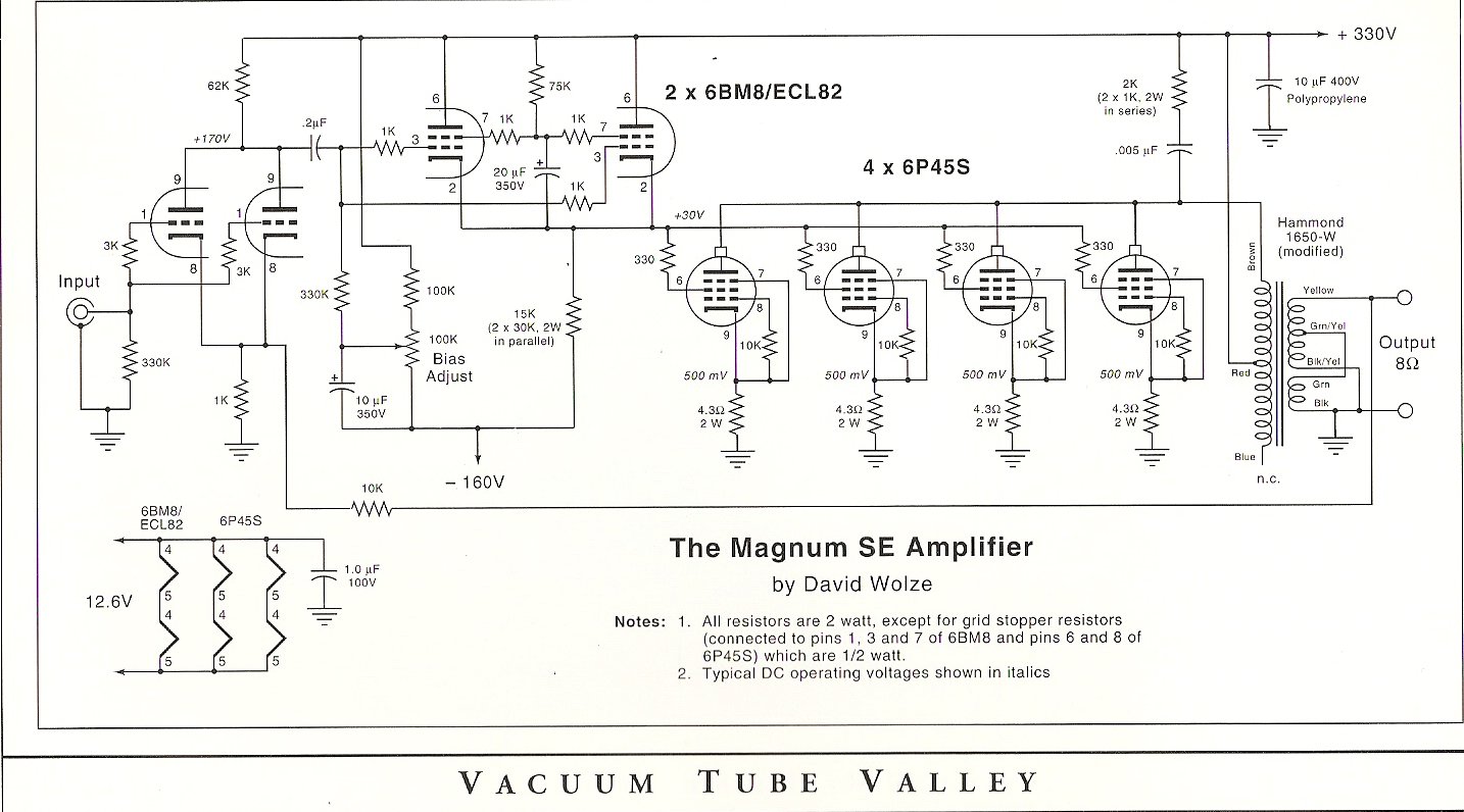

Why use a SE OT at all? The "anti-triode" scheme solved this years ago.
You put the tube on one side of a P-P OT, and a high gm HV Mosfet on the other side of the OT primary. Then a CCS tail below them both. The tube gets driven by the audio, and the Mosfet gets a quasi static DC bias. The tube will generate some inadvertant DC imbalance with large signals due to its 2nd harmonic distortion, so some provision is needed to dynamically adjust (below 10 Hz audio band) the Mosfet gate bias to keep the DC in the OT in balance.
This gives twice the power output as the single tube alone would give, and the CCS tail along with the high gm Mosfet guarantee true complementary current in the opposite OT primary phase. The high gm of the Mosfet keeps the voltage on the tail constant, so the tube operates in a SE environment. (normal P-P split phase operation cancels the even harmonic distortion by dynamic (audio band) variation of the tail voltage, which is not allowed here.)
I think the only high voltage high gm FET that will stand off 3KV+ is another 3-500ZG. Doubling the b+ current is also pretty impractical for an amp that will burn a kilowatt at idle. The balancing current could be from a low voltage buck regulator on another winding, or maybe the filament current.
I bought a pair of 3-500Z's 20 years ago. Maybe I'm old enough now to not kill myself hooking them up. If there are performance issues with the 1642SE, Is anyone interested in a group buy of a custom at Stangenes? Places I've worked for have gotten great service and customs from them.
