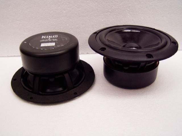

Peerless (india) SKO-130-PL-SH-8 5.25" Woofer / Midrange 4 ohm
Any one know the specs for this woofer? Is it similar to a woofer that the specs are known for? I can't measure specs myself i think :Popworm:

I don't know about Peerless India, ostensibly a different company but still with some kind of ties to Peerless Denmark, but Peerless Denmark, when they custom make a driver, assigns it a part number. Even though the driver is made for one company only.
When that company stops making the model the driver was custom made for, the drivers get released on the surplus market with the Peerless number-but the specs are impossible to look up.
They were never made for public consumption, you see, so the specs are not published at all.

Yes, I think it would be complicated to measure the specs, no? I bought these woofers for a friend. They were cheap woofers to go into his car, but we did not get around to it, so I kept them. I would like to put them in a ported or TL type box. So I was wondering what the specs were.
I also have some Peerless tweeters to go with them and they're are both shielded, so I thought they would make good computer speakers. I built other speakers, but only use them for my computer and I can't put them next to it. So they are behind me, not optimium I would think.
They say Peerless Acoustics LTD. and then a address in Richboro, PA on the back. Which I reckon does not help.

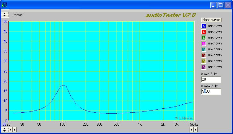

The above post is inaccurate as many of my posts are 😀 The DCR of my woofers is about 5.5 ohms when measured with my analog multimeter. So I think the SKO 130 Poly specs might be correct, although it seems like the back of the cone is paper. Another issue I have is that if my DCR is 5.5 ohms my speakers nominal impedance would be 8 ohms not 4, right? Measured with audiotester it seems to be 4 or 5 ohm nomial, but the scale says db not ohm, I guess I will post a pic now.
I have tried Audiotester and Speaker workshop to measure impedance. I think Audiotester and Speaker Workshop do not like my microphone input (I got new sound card drivers, it didn't help). In Audiotester you can change the input to line-in, but in Speaker Workshop I'm not aware that this can can done. I have not broken the drivers in or mounted them properly for testing but I get a resonance peak at 95-100 Hz in Audiotester. I have also not found or maybe there is no way to approxiamte T/S specs using Audiotester.
Can you change input from mic to line-in in Speaker Workshop? Or can you approximate T/S specs in Audiotester?

Interesting! They're ~just around the corner from me. I knew they carried Peerless, but assumed it was the originals, which is what they used to carry AFAIK. Anyway, I wouldn't pay much attention to these specs since they are too far off from calc'd BL/Mms/Cms.
Yes, these would be nominally 8 ohm drivers. Can't help with the testing programs, but breaking in a driver typically only lowers Fs ~10%, so your Fs measurement is way off if they should be down around 50Hz.
