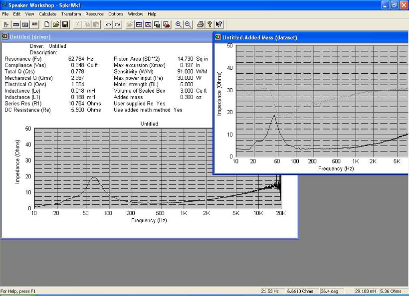

I read about measuring impedance in free air and with added mass, then measured those two. The specs I got did not seem to be very accurate, here's a pic .
Maybe it did not account for the wire inductance or capacitance correctly. Qes seems to be off by the most 1.05 instead of .43 from the specs on the page given before, http://www.mindspring.com/~audiolab/peerlspc.htm
I did not calibrate my sound card also.
A couple things, you said you read 5.5 ohms using your voltmeter. Is this a digital voltmeter, and what do you read in terms of resistance when you just short circuit the leads of the voltmeter? Usually you will read something like 1 ohms by just shorting the measurement cable leads. So you need to substract that amount from what you read when you measure the driver's DCR. I think there is something wrong there. From your picture of SW results it says you entered the Re value. Try also extracting the T/S parameters letting SW decide the Re value, and compare this value to what you measured with substracting the lead resistances. I would guess they would be close, and it would be somewhere or less than 4 ohms. I think you also said the model number on the drivers say it is 4 ohm model.
Another thing, I think you have the paper cone version, not poly. I think they coat the paper cones with a special coating that make it look like poly from outside, but as you said the back of the cone looks paper.
It is a good thing that you are measuring the T/S params, it is not unusual that production specs are off from published specs. But such Qe value makes me think that there is something wrong with the Re value entered.

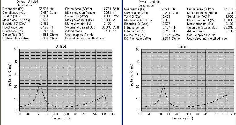

You guys are going to like this, I can feel it
The specs for the woofers don't match each other they also don't match the specs on this page http://www.mindspring.com/~audiolab/peerlspc.htm
They should match these specs somewhat fot the SKO130, I think, and each other.
I did the measurements a lot of time with two different sound blaster cards and the woofers still come out like this. So I guess my question is - what does this mean?
It looks like you have SKO130's. IMO the T/S params on the left of your picture matches very well with http://www.mindspring.com/~audiolab/peerlspc.htm.
The difference between your two units may not be that important when you model the box. The unit on the right has higher Fs, but at the same time a lower Vas, and higher Qts. These differences may cancel each other in a box. For example, if I remember correctly, for a sealed box if the ratio of Fs/Qts remains same, box volume stays same to give same box alignment. So I would suggest you to model the box with the T/S parameters that are on the left of your picture. Then change the driver parameters to the right ones, and look what happens to SPL using the same box. It may turn out the end result will be very similar between the two units.
