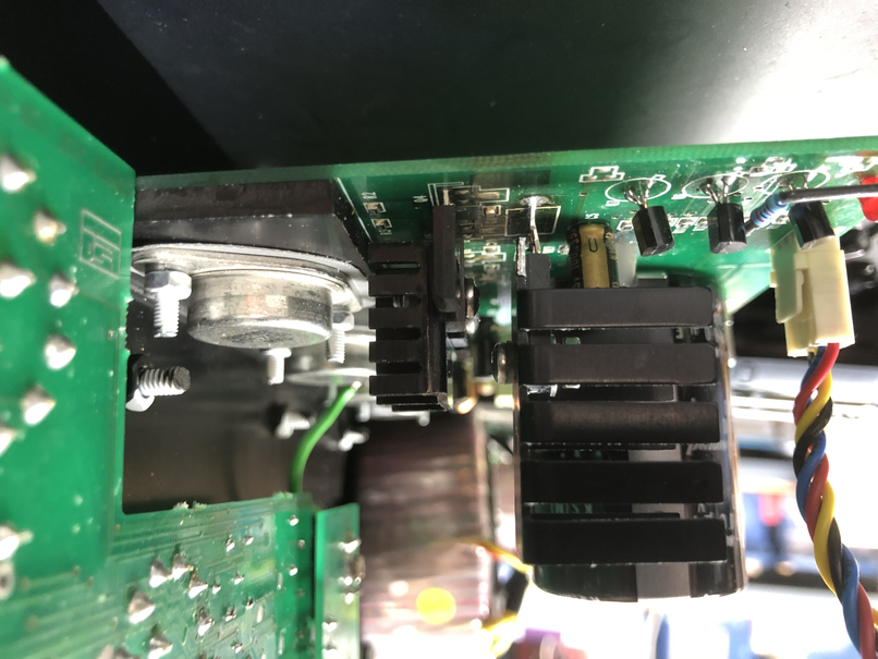

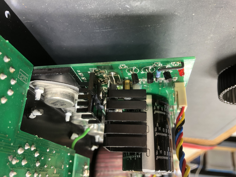

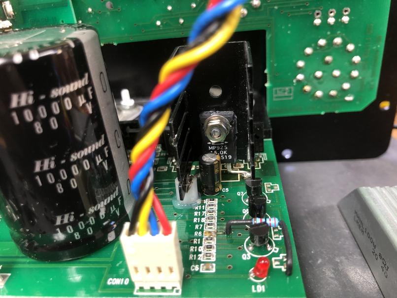

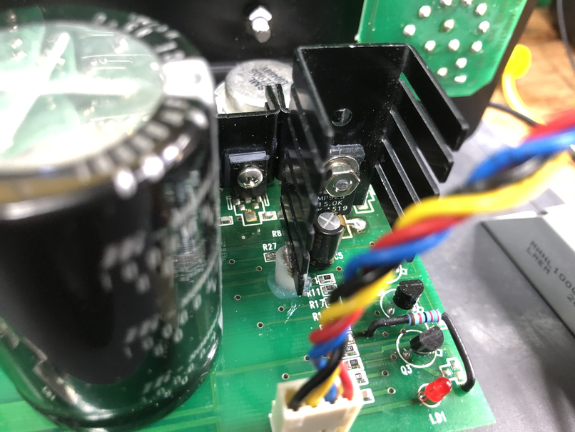

Okay, so I'm a little bit slow, but here's another Storm III board that I just serviced.
- Recapped all electrolytics with Nichicon UKW1V101MED 100uf 35v and Nichicon LKS1K103MESC 10,000uf 80v, including the hidden 100uf on the preamp PCB.
- Changed Q4, Q5 to MJE350, and Q9, Q10 to MJE340. Added Aavid 577102B00000G heatsinks to Q5 & Q10 (I also changed Q13 to MJE340 and Q14 to MJE350 while I was at it)
- Changed R6 (SMD 10k) to 22K, 1/4 Watt, 1%
- Changed R8 (12k, 2 Watt) to Caddock MP925 15k 1% 25W TO-220 resistor with Aavid 504222B00000G heat sink (Snap off one leg to clear Q7 if necessary. Notch a nylon spacer and glue between heatsink and pcb with epoxy or neutral cure silicone RTV)
Temps with music playing (all measured in open air)
- Q5 & Q10 80-85F (up to 135F previously)
- R8 100-110F (up to 160F previously)

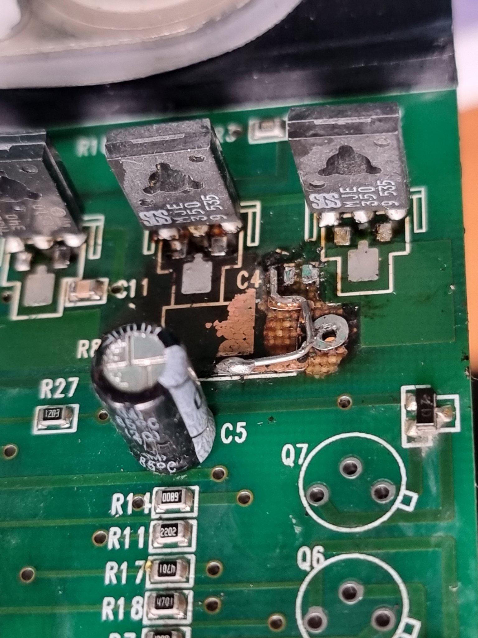

Hi everyone, thanks so much for all the helpful information in this thread.
I have a Strata III that was beginning to show signs of age -- whooshing, weak signal, crackling. I had the amp out and on a shelf for about 10 years (!) and I finally got around to thoroughly cleaning the power switch and replacing R8 with a 12K 3W 2% Dale resistor. Mounted it WAY off the board (like about an inch) and am hoping this helps keep it cool. May do the whole rework and cap replacement later.
