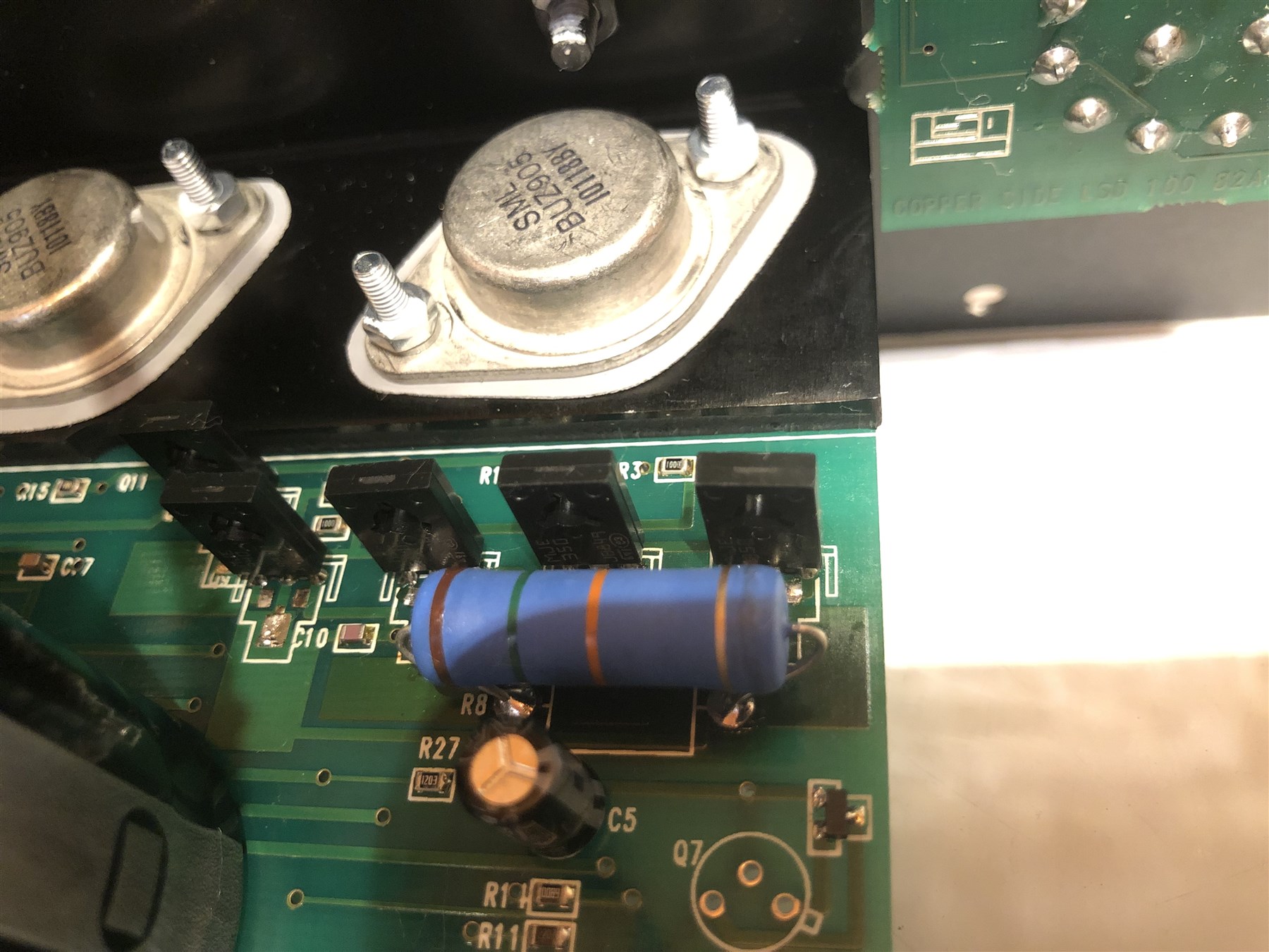

@Dabble, thanks for the suggestion about the resistor - I will look into that. Also thanks for confirming (and explaining) the popping behavior.
Is this true that I should not use a wire wound resistor and instead use a metal foil resistor? If this is the case I can source a Vishay
CPF312K000GKB14 (12K ohm, 3w, 2% tolerance). Would this be preferable?
It doesn't have to be a particular brand, but your reference is to a metal foil resistor, which is better still than the metal film I mentioned.
Metal resistors are a little more expensive, tend to be lower tolerance, smaller, more reliable, longer lasting, and are quieter on the signal path than carbon resistors. I read that the thermal noise is the same, and current noise varies with the resistance material. I refitted my R8 with a carbon resistor as I'm not too fussy, but I wouldn't risk a wire wound resistor which will obviously introduce some degree of induction.
As you are fitting R8 as 12k, I presume you haven't changed the transistors from the originals.
I have not changed the transistors. Only R8. Not that I am looking for trouble, but I do not think there is currently any other issue with the unit.
Is there a reason to consider changing the transistors?

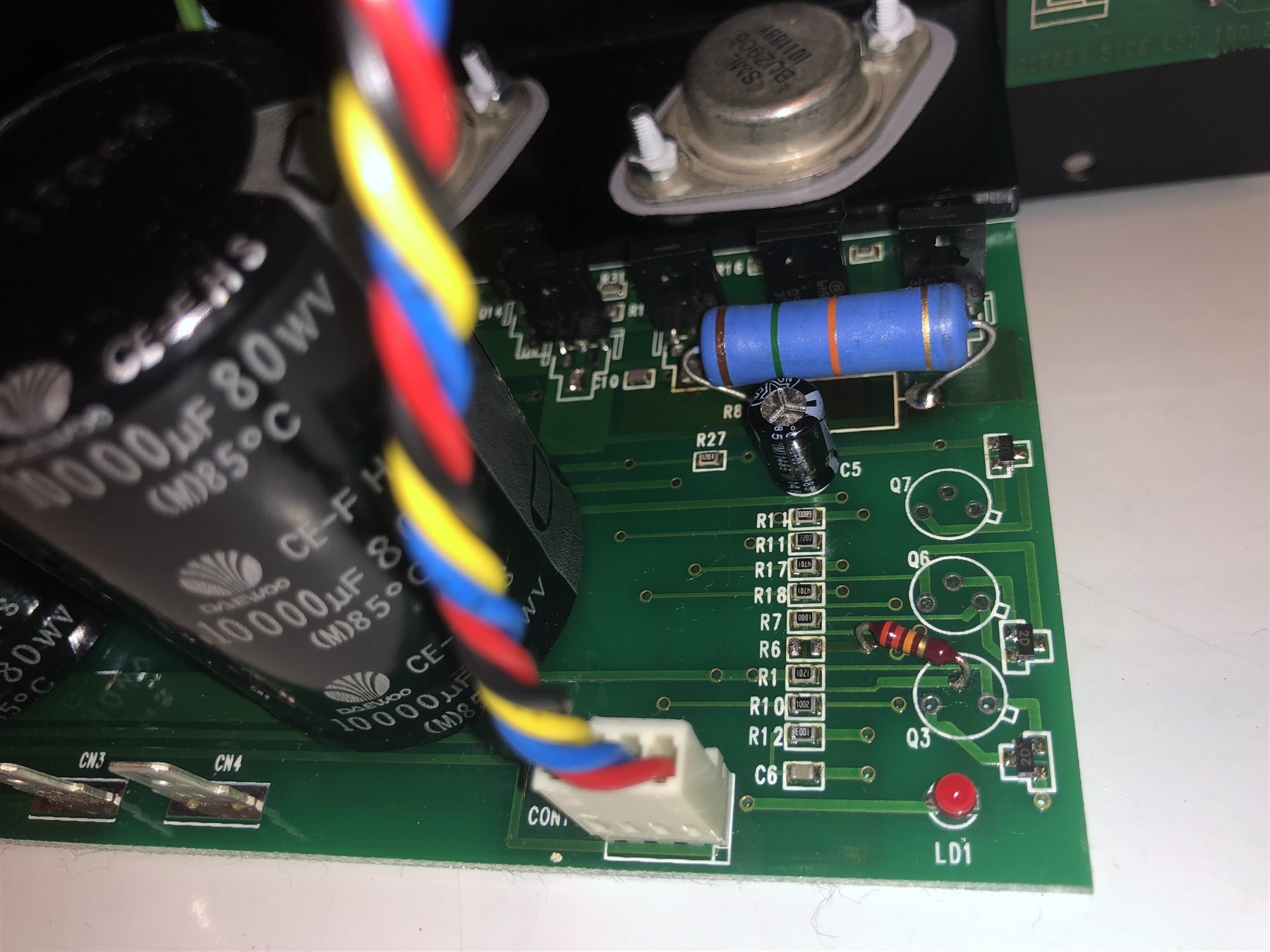

Got info directly from REL today.
This is the repair, remove and replace with
Q4,Q5 - MJE350
Q9,Q10 - MJE340
R8 – 15k ohm 3 watt
R6 – 22k ohm 0805 resistor
Also check R1 (1.2K), R2, R3, R7 and R19 (100ohm), R17 and R18 (4.7K). Sometimes these will drift and cause bias problems in the driver circuit.

I have 3 Storm III's. I run two of them, configured in stereo, on my main system, and love them. I ended up with a spare, so I use that one on my bedroom music / tv system.
One of my main system SIIIs started failing a couple of months ago, with random wooshing sounds. And also occasional whumps when unmuting my preamp.
Upon taking the amp out, it has the typical R8 thermal damage.
Per the excellent, detailed info on this thread, I just rebuilt it myself as follows
- Changed SMD Q9 & Q10 to MJE340
- Changed SMD Q4 & Q5 to MJE350
- Changed R8 (12k, 2 Watt) to 15K, 5 Watt, 5% (I uprated it to 5w per Dabble's comments on 18-Mar-2017)
- Changed R6 (SMD 10k, 1/8 Watt?) to 22K, 1/4 Watt, 1%
- I had a bunch of extra MJE340/350s, so for the heck of it, I replaced Q13 to MJE340 & Q14 to MJE350 too.
Just as a point of interest, I measured R8 after removal, and it was still within spec. But of course I measured it cold, so perhaps it was misbehaving at operating temp. Or perhaps one of the other replaced parts was on it's last legs.
I reconnected the amp to the Storm III, without buttoning up the cabinet, in case of issues, and also to check out the temperature of the new parts.
The good news is that the repair was a success.
However, after letting it come up to temp, with music playing, I noticed that R8, Q5 and Q10 are too hot to touch (for more than a fraction of a second).
Per my Fluke IR gun, the 5W R8 is 160F at it's hottest point. Is that any cause for alarm?
Q5 & Q10 are also too hot to maintain contact. However, I can't get a good angle on the exposed metal surface to measure them with the Fluke.

Were you measured your components on the circuit board outside the cabinet? If it is enclosed, the ambient temperature will be higher. Most resistors will start derate at 70 degree C ambient at full load.
@tangoextreme, I just noticed your response...
Good to know. R8 was running as hot as 70C in open air.
So yes, as mentioned above, I am concerned that the temps will go even higher with the cabinets buttoned up. Especially in the Summer time with higher ambient temps.
Since my last message, I did some further changes, which have helped significantly:
1) Changed R8 to a 25W TO-220 resistor, and added a heat sink
www.digikey.com/product-detail/en/caddock-electronics-inc/MP925-15.0K-1/MP925-15.0KF-ND/3013536
2) Added heat sinks to Q5 & Q10.
R8 is happy now.
Q5 & Q10 are much better, but still on the hot side. I intend to upsize the heatsinks on these 2 components when I have a chance.
I'm not working on this continuously, so it may be a while longer before I'm done. But I'll report back with pics and final results when I'm finished.
