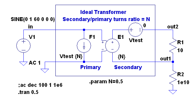

Okay, here's a fix for that problem. Since I can't see the model in my head, I had to look up the circuit matrix again. This time, I used the G matrix. The controlled source model of the G matrix has a current source on the primary side. This makes it possible to model the mains as an ideal voltage source if needed. The G matrix equations look like:
I1 = g11E1 + g12I2
E2 = g21E1 + g22I2
For a turns ratio N, the G parameters of an ideal transformer are:
g11 = 0
g12 = -N
g21 = N
g22 = 0
The model ends up looking as shown in the picture below.

andy_c said:
And here is the simulation file with the mains simulated as an ideal voltage source (not the best model, but the easiest). Transient works okay now, since there is no loop of voltage sources.
Thanks Andy,
and when you change the voltage source to the Sek and the RL to the Prim the same problem occur :xeye:
Ohhh, and the same happens with my circuit when I exchanged load and source 😡
The simple solution : Add a resistor in series...and all 3 circuit went fine 🙂

Andy,
Thanks for taking so much time to respond.
In the LT-Spice transformer model that I attached to my previous post, I included a tentative AC Mains model, using Heinz's kindly-provided example of having 0.4 Ohms in series with 800 uH to model the mains.
I suppose that if only the mains WIRING were to be considered, it would be trivial to estimate the series resistance and inductance for a given length of a given gauge of wire, maybe using some "average" length for the wire between the power supply and the pole transformer. I 've no idea, though, really, and haven't done even a rough estimate to see how it might compare to the 0.4 Ohms/800 uH.
And, although I didn't put it into the model I posted, this way, I assume that both the hot and neutral should have the same series inductance and resistance (assuming they're made with the same type of wire).
By the way, just to let you know: I did have to tweak your ideal transformer model, ever-so-slightly: I needed to add another large resistance to ground, so that both windings have that. Otherwise, there was some definite "weirdness" possible, with the voltages on either side of the ideal mains source, especially when the transformer model was wrapped around it, and higher voltages and currents were present, and depending on where grounds were connected, etc. It even varied very significantly with the spice timestep size. There was lots of distortion and noise, huge spikes, oscillation, etc, sometimes, and possible extreme asymmetry between the two sides of the ideal AC Mains voltage source. It seemed to only affect the voltages, not the currents, around the AC source, and never affected the output voltages or currents at all. I never did understand what caused it, or what it even was. I almost have to assume that it was some math/solver problem, inside spice. But that's all gone, now, I hope. And, I also inverted your definition of the turns ratio, N, to match what was used in the appnote that I was basing my transformer model on.

Hi Tom,
Wow, that sounds like quite a circuit you're working on.
I saw your simulation file. It looks like the 1000 Meg resistors you added are just standard SPICE procedure for preventing floating nodes. Or was there something else needed? If so, give me a holler so I know I'll need to add them too.
Back in the early '90s I used to work on radar receivers that had multiple identical channels and high gain. We'd always put a choke at the power supply pin of every RF amp. Depending on the frequency the receiver operated at, we'd often be able to choose the choke value so its parallel resonant frequency was near the middle or high end of the operating bandwidth. There's nothing like a high series impedance in the power supply at the operating frequency for preventing crosstalk between channels and between amps in the same channel. Also, we had some circuits with gain over 70 dB at around 600 MHz. If a decent sized AC signal got on the power supply and was picked up by the amplifier all the way back at the input, boy did some strange stuff happen. So it doesn't surprise me that you're seeing improvements with chokes in the supply lines. The high series impedance of the choke in the transient condition can really do wonders for preventing one circuit from interacting with another.
Regarding the transformer with shorted secondary, here's one thing I thought of. Suppose you loaded the secondary with a small resistor and grounded one side of it. Then you could look at the voltage on a scope. By slowly bringing the variac up, maybe you could find a secondary current that was just below the point where distortion could be seen on this voltage. From the turns ratio, you'd also know the primary current. Then, knowing the series primary resistor and assuming almost zero Ohms on the primary with secondary shorted, you could figure out what the variac voltage should be. Just a thought - I'm not experienced with power magnetics, so I hope to use this thread as a learning tool. That article by the guy from OnSemi was a big step in that direction.

So, I shorted the secondary with a jumper and raised the variac's voltage until the voltage across the resistor was 5.877 VRMS, and then measured the voltage across the primary winding to be 3.061 VRMS. From those measurements, I calculated Lpsshort = 0.5037 H (for Step 3 in Post #14 of this thread).***
Tom, this is OK, for this test (leakage inductance) it´s only
important that the primär voltage is small.
Thanks, Heinz!. Next time I do such measurements, I will try to be at least a little smarter about it, and take at least three data points, so I can see the measurements' variation versus operating point.
About 5% from the nominal value is good to avoid influence from the magnetized iron.
It sounds like you mean that the primary's test-voltage should be something like .05 X nominal operating voltage. Is that correct? (I ask because, normally, I would think that "5% from..." would mean "0.95 X...".)
I´m a little bit surprised that the leakage inductance is 10% from Lprim...that is unsual high.
Has the bobbin separate chambers?
It is a "split bobbin" type of construction, advertised as follows:
"Low profile, split bobbin with top shroud design."
"Dual winding secondaries, non-concentrically wound."
"Low primary to secondary coupling - no electrostatic shield required."
Here's a thought: I was purposely trying to get a model for only ONE of the dual secondaries and one of the dual primaries. So I only shorted ONE of the secondaries, when trying to measure the leakage inductance of the one primary, and only applied the voltage to the one primary; the one with pins opposite to those of the secondary I shorted. I did it that way because it "appeared" (looking at the bottom of the transformer, where the pins are, and the bobbins are visible) that each bobbin was for one primary and one secondary, only.
But maybe I was completely wrong! And it seems that if there was _any_ coupling between the one primary that I tried to measure, and the secondary that I did not short, then the inductance would measure too high. Is that correct?
I don't know how "good" these transformers are, really. I used them because their SIZE was right for my enclosure, and because they are PCB-mounted, and also because I can have the primaries switchable to run from 115v or 230v. They're cheap, too. Their current price at http://www.mouser.com is $21.80/1 or $174.40/10.
Tom, you should reduce the "mains impedance" because it´s calculated for a 230V socket!
Oops! Will do. Thanks!
- Tom Gootee
http://www.fullnet.com/~tomg/index.html
andy_c said:
Hi Tom,
Well, it's been "evolving" for a long time. I would hate to admit how much time I've spent, on parts of it. But I've rationalized it as a learning experience. 🙂 Even though I was, originally, an EE, I don't have the lifetime of work-experience with circuits, that a lot of EEs have, because I did mostly (non-EE) software, for decades, and, actually, did mostly control-theory stuff even when I WAS doing EE work, way back when. I started dabbling again only less than ten years ago, but didn't get serious about it until about two to three years ago. However, I figure I've put in at least five or six man-years, since then. 🙂
Yes, the extra 1000Meg resistor on the primary side is the only thing that needed to be added. But it wasn't a "floating nodes" problem, necessarily (no error messages like that, at least). Try removing it, and having no other grounds on the primary side, and plot the voltages on both of the primary inputs. Then see what happens if you copy the ac mains resistor and inductor and have them on both sides of the ac source. Then reduce the timestep to .001 amd look at the primary's input voltages again, even zooming in on them. And then look at the voltage across the load.
OH! I just-now did all of that, but then changed the plot of V(pri_1a) to V(pri_1a) - V(pri_1b) and got a good sinusoid! So, it looks like it technically "works", either way (i.e. with or without the 1000Meg on the primary side), especially as far as the output is concerned. But without the 1000Meg to gnd, for the primary side, it's "appearing" in a "differential mode". That should probably make perfect sense, if I thought about it.
Perfect! Now I wish I'd "just asked".
That sounds like it must have been some fun stuff, that you were doing!
I worked on defense aerospace stuff, back when I was a new EE, in the early 1980s. I sometimes wish I'd stuck with it, instead of striking out on my own, mainly because it was so great to work with the other people who were there. I've been working alone, for years now, and have to watch out for "cabin fever", heheh.
Thanks, Andy. I can try that, too. But as I said in my answer to Heinz, last night, I think I might have simply goofed-up the whole thing:
My split-bobbin transformer has dual primaries and dual secondaries. I was under the impression that I could treat them as two separate single-pri/single-sec transformers, for modeling (and measuring) purposes. But now I'm not sure if it can be modeled well, that way, and, even if so, I don't know if my measurement methods were valid (probably not), especially for the leakage inductance, since I only shorted ONE of the secondaries, to measure what I thought was the "corresponding" primary.
At this point, I can't say that I even know whether there IS a valid way to measure them, "separately". But I'm just going to try it again, at least, and see what I get for one primary with both secondaries shorted. The comparison with the previous result should be enlightening.
While I've got the measurement setup in place, again, I'll also take measurements for both primaries together, in series and in parallel, with both secondaries shorted.
I think that I'll also do all of the other measurements again, for the two cases with 1) paralleled secondaries and paralleled primaries, and 2) paralleled secondaries and series primaries. I will also have to go back and see if a different model (and probably some extra measurements) will be needed, for either or both of those cases, rather than the simple two-winding model. I guess that I might have to use the three-winding model in the referenced appnote, at least for the series-primaries case. I kind-of hope that I don't have to try to find or develop a four-winding model. (Or maybe I should just use a transformer that has only one secondary.)
I only wanted to treat them as two separate transformers so I could more-easily simulate different primary and secondary configurations. But, for this project, all I truly need are two models, both with the secondaries in parallel, and one with the primaries in parallel and one with the primaries in series.
I'm sorry if I have wasted other peoples' time, by not clearly-defining my transformer configuration, versus how I thought I could model it. But, by considering only the two-winding case, I have at least learned some of the basics.
One thing that I should probably also think about, right about now, is finding out if there are any easy-enough ways to VALIDATE any resulting transformer models. I haven't given it any thought, yet. So don't laugh, if the answers are obvious. 🙂 I guess the trivial case would be to simulate the original measurement methods and make sure the model gives close to the same results.
But I'd like to also validate things like the transient response for load changes, and try to get an idea of whether or not the startup behavior is modeled well-enough. I guess that might be difficult, without a storage scope. I'll have to check to see if I still have a working one, around here somewhere. I do also have some working analog X-Y plotters, and some strip-chart recorders. I think that one of the HP X-Y flatbed plotters that still works is quite fast, and might be able to stretch some fraction of a second of a signal across 15 inches or so of paper. I'll have to check the strip-chart recorders' speeds, too. I do have "a bunch" of old scopes, here, left over from when I used to buy and resell surplus equipment. And there's probably a storage scope among them. And I have an old Tek 564B that needs a cazapitor replaced, somewhere. I guess that, either way, though, it'd be something like a whole day spent, to get a working setup put into place, unless I got extremely lucky. More decisions to make... 🙁
Thanks again, Andy! I'll do some more research and try to sort all of this out, and report back.
- Tom Gootee
- Tom Gootee
Tom, yes 5% from nominal voltage means :
100% = 120V --> 5% = 6V...
and for valid results it is necessary to use ALL windings on the core !
Much success,
Heinz!
