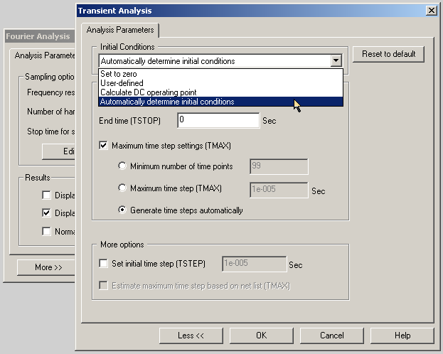

And here to my question:
Running a Fourier Analysis in my sim will not work good.
Because of this time taken to reach a warmed up and stable output.
Is there any simulation settings for the fourier test
that I can modify, so to get a good analysis?
( I use EWB MultiSim )
lineup,
I don't know about EWB MultiSim. But, in LTSpice, too, everything must be stable for the Fourier results to be accurate. If a simulation takes "too long" for that to happen, I sometimes use the .ic directive, to set the Initial Conditions, such as cap voltages, inductor currents, etc, etc, so that steady-state operation is reached much sooner (since it's basically already there, if I set enough of the initial conditions correctly). There's also a way to automatically set the initial conditions, from the results of a previous run, IIRC.
The accuracy is also affected by the timestep size. I seems that I usually have to use .0000001 second or less, to get the very best results. In general, if I'm interested in good accuracy, I usually just keep lowering the timestep size until the results don't change much, any more.
- Tom Gootee

There are 4 different selectable
analysis choices.
See my attached MultiSim capture!
The default works okay when Fourier and using ideal DC voltage supply.
And of course is no problem run THD analys.
Because this will approach a stable value after some time Run.
But Fourier is sort a 'momentary capture'
and so it wont work good, unless there is, like you say, 'stability' in circuit.

lineup,
I hope that someone else, who has experience with EWB, will comment, because I have no experience with it. The most I can offer is probably to relate how I can do some of these things in LT-Spice (which is a free download from Mixed-signal and digital signal processing ICs | Analog Devices , and is very, very good).
In LT-Spice, after a "Transient" (i.e. time-domain) simulation run is completed (OR if I have interrupted it), the main remaining result is usually the set of plot displays that I have told it to generate, showing various voltages, currents, power dissipations, impedances, or whatever I selected, graphed versus time.
I can then tell LT-Spice to generate and display a plot of an FFT (Fast Fourier Transform) of any or all of the displayed waveforms.
Also, if I want to first "zoom in" the display, so that the display-window shows the waveform(s) for only a smaller portion of the original run-time, then I can use the mouse and drag a rectangle around the portion that I want to see magnified. If I THEN select "FFT" (i.e. after magnifying, like that, in order to see only a smaller portion of the original waveform display), then the FFT dialog also offers a choice between calculating the FFT over the entire run-time, or only over the currently-zoomed window's displayed portion of the run-time. It also always allows setting #points used, etc etc.
There is also a separate and completely different Fourier "command", which can be used to automatically calculate THD. It must be entered onto the LT-Spice schematic, before a run is started, and has a format like .four freq #harmonics #cycles signal_name , where the #cycles parameter is the number of signal cycles that will be used, which are always taken from the END of the run-time, from the signal "signal_name". For that one, too, I have to be careful that the signal has reached a completely-stable "steady-state" condition, if I want the most-accurate results.

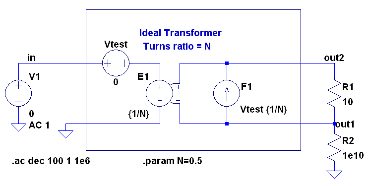

Now, see the schematic in Figure 8 of the appnote (AN1679-D.PDF from onsemi.com, linked-to above).
Note that the transformer in Figure 8 is an IDEAL transformer.
For the Spice model of the ideal transformer, I labeled the ideal transformer's input nodes as "ID1+" and "ID1-", and had no downstream connections to them. For the ideal transformer's output, I used a "bv" (behavioral voltage) source, and set the voltage to V=0.15517*( V(ID1+) - V(ID1-) ), where the 0.15517 = 1/N, using the N calculated in Step 1, above. i.e. 116VAC RMS input gives 18VAC RMS output.
Created schematic as shown in Figure 8 of appnote, with ideal voltage source input (Used 164V @ 60 Hz, since 116VAC RMS input X 1.414 = 164V 0-peak input): Connected Rp, Lm, and L11 in series (from ideal voltage source's + to - terminals, in the sequence just given), across input source. Node for input source's "+" terminal and top of Rp was labeled "ID1+". Node between Lm and L11 was labeled "ID1-". Inserted bv (behavioral voltage) source to the right of nodes ID1+ and ID1- (but NOT connected to them). Set V=0.15517*( V(ID1+) - V(ID1-) ), for bv source (by right-clicking on bv source, clicking on "Value" field, and entering the V expression just given). Inserted Rs and L12 in series, from bv source's "+" terminal to overall output terminal 1 of 2. Connected bv source's "-" terminal to overall output terminal 2 of 2. Inserted a 1000Meg resistor from ideal input voltage source's "-" terminal to Ground, so Spice wouldn't complain about "floating nodes".
It works!
Unfortunately, using the behavioral voltage source for the ideal transformer model, the way I did, means that the conditions at the secondary winding cannot affect the primary winding in any way. There should be a way to model the ideal transformer so that the coupling would work in both directions. But I couldn't immediately think of one. If anyone knows, or can imagine, a better way to try doing it, please let us know.
- Tom Gootee
http://www.fullnet.com/~tomg/index.html

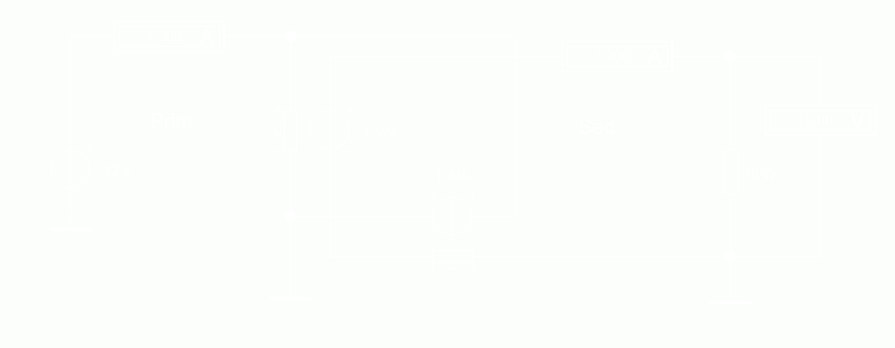

Hello Tom,
your measurement of the primary inductance is by far too low!
The u of the lamination is very nonlinear and rise a lot with higher magnetization.
So you must do your measaurement of Lp with 60Hz and about 110V.
For modelling I think it´s better to use the coupled inductors but with k=1 and further parts,
because your try can transfer DC currents.
If I like to simulate this I use the arrangement you can see in the attachment (1 : 1 "DC" transformer).
Regards
Heinz!

Well, I see Heinz has already posted something on this, but let me add a little bit also. I looked up the two-port parameters of an ideal transformer. The z and y matrices are undefined, but the h matrix is well defined. The parameters are:
h11=0
h12=1/N
h21=-1/N
h22=0
where N is the turns ratio.
Putting these into the two-port model with controlled sources gives the circuit pictured below.
powerbecker said:
Andy,
thank´s for "dc-trafo", but please look to the left side :
2 voltage sources are switched parallel , E1 against V1 .
Wow, that really threw me off 🙂! And yet if you do an AC sim, calculating V(in)/I(Vtest), you'll see that the impedance looking into the primary is 40 Ohms over all frequency. That's exactly as you'd expect for the turns ratio and load on the secondary. But how can the impedance into a voltage source not be zero? If you follow the chain of dependencies for E1, its voltage depends on the secondary voltage, which in turn depends on the current through Vtest (first term in F1). So the voltage of E1 depends indirectly on the current through it. Its impedance might be zero, but only if the secondary is shorted. So E1 is really looking like a 40 Ohm resistor here. Of course, the impedance looking back into the secondary is zero because of the zero Ohm primary impedance.
My stems from my old ewb5.1 simulator.
I'd expect there would be several equivalent controlled-source models of the ideal transformer. My tattered old network theory book shows an F, G and H matrix for the ideal transformer. So I'd expect there'd be at least three different but equivalent models. I just did the one for the H matrix because I couldn't remember what the F and G matrices were.
I think you'll find that this model transforms the voltages, currents and impedances correctly.
