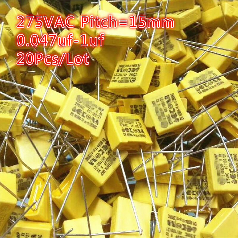

Anyone familiar with these caps?
Self healing is not the reason why cheap capacitors lose value ... they are poorly made , thats all
And made in china by a western company does not equal to some local "entrepreneurs" copying that stuff in a shitty factory across the road .

I spoke to my colleague - the capacitors tested were on the AC power line and measured less than half the nominal capacitance. They removed them and dissected one - that is my data point for one failure mechanism for X2 self-healing caps.
The attached images show testing of generic yellow-cased X2 caps using a Fluke 289 (factory calibrated). The histogram shows the measured capacitance of a handful (17 as it happens) spilled from the bag of 50 and tested.

The photo shows X2 metallised polypropylene caps under test, and the the first chart shows the results of testing 17 of those X2 caps. All were very close to the nominal capacitance - I recall that I stopped testing, willing to accept the small risk that one of the remaining 33 capacitors in the bag would deviate from the nominal value by more than 2%.🙂
