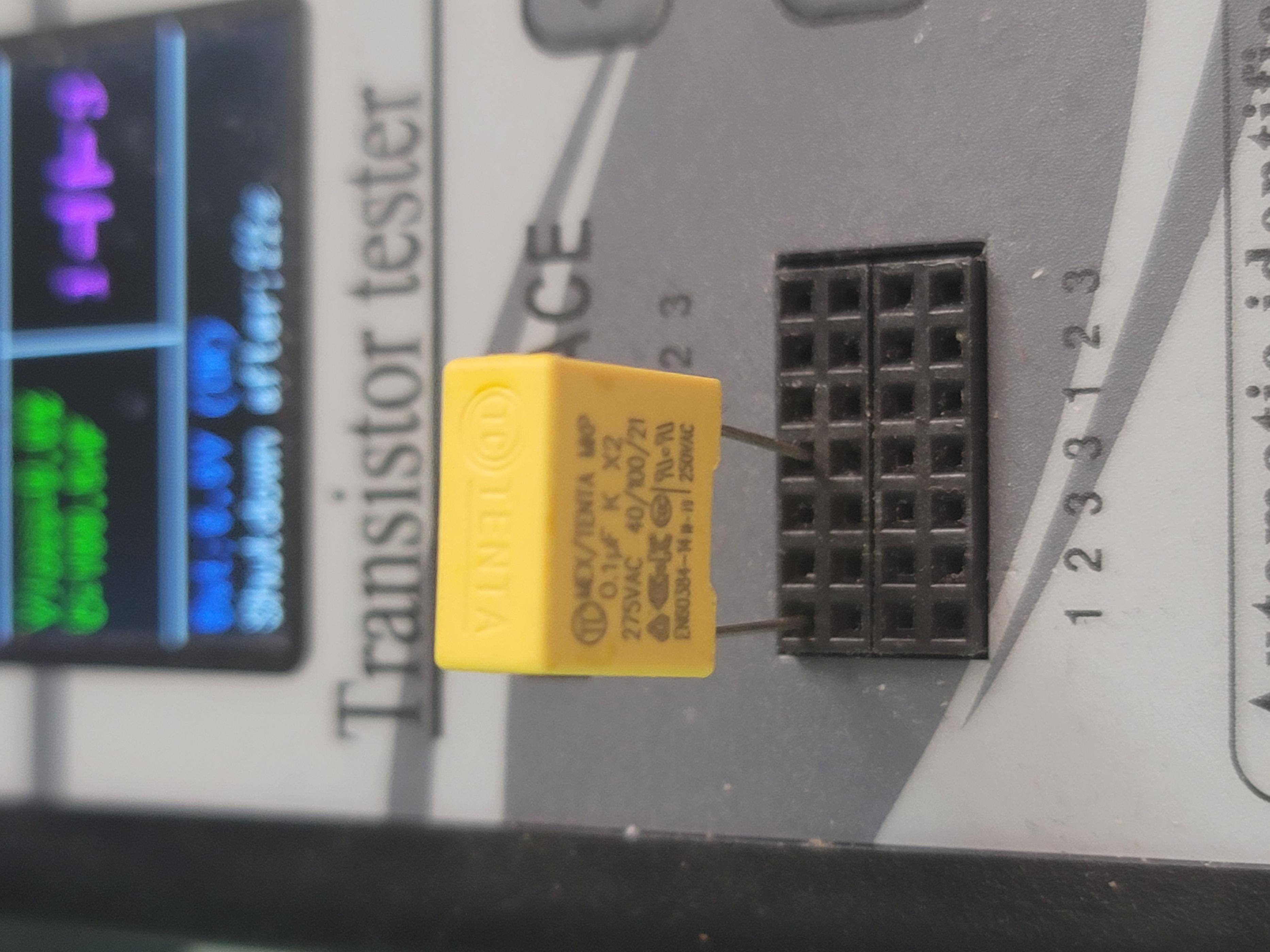

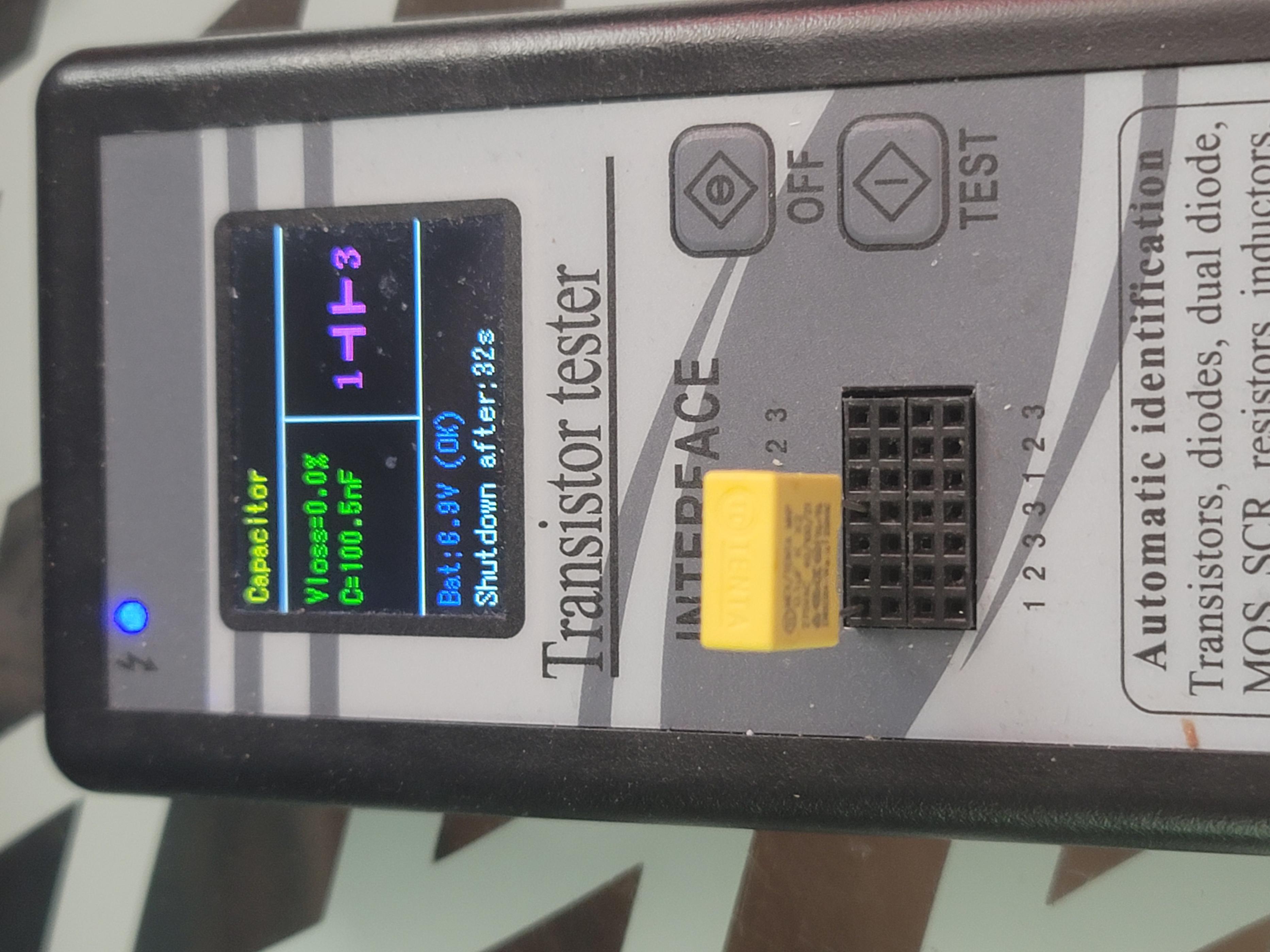

Anyone familiar with these caps?
Used many of these caps in my builds over the years. They are perfectly fine.

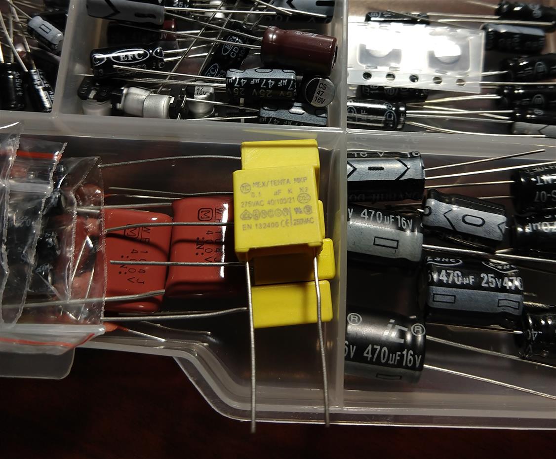

These are the exact caps I received; looks like I ordered 100 nF and not 220 nF.
I wanted something small enough to go in my travel kit, just in case I needed some high voltage coupling caps while away from home base. You can always put "good" caps in later, after something is finalized and working.
