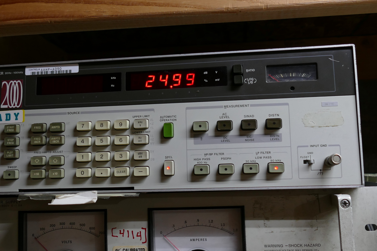

I think as I implemented them I'm getting 22~25 watts or so with basic DMM and a calculator load testing off of test tones. All I know is that I never run it loud enough to use all that reserve in our setup at home.

My amp testing regardless of intended application involves multiple methods of torture. Just as I blast a guitar preamp through my HiFi amps (yes even the 300B stuff), I use the same set of test equipment for power output, THD and frequency response.....

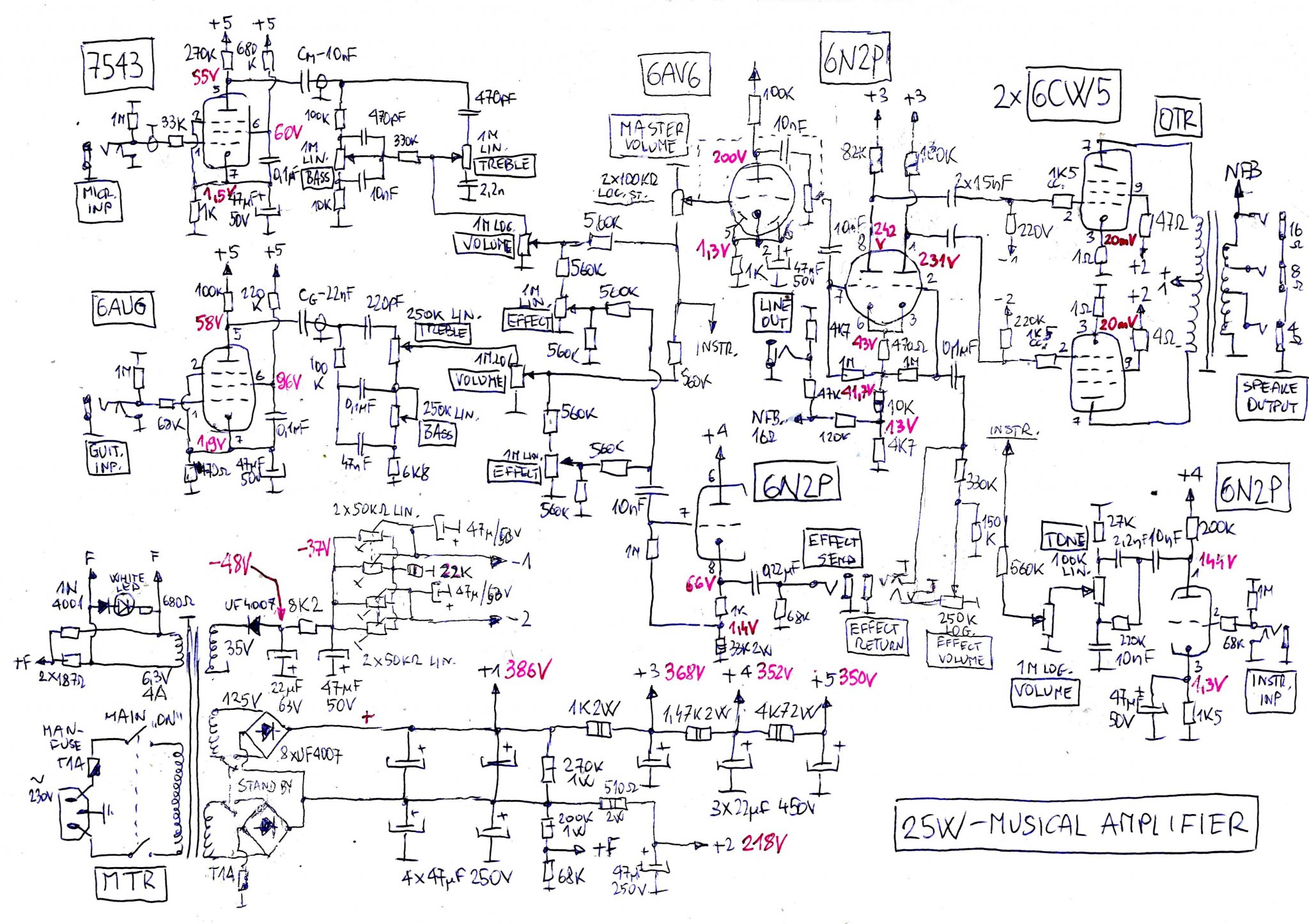

Hi Davorin,PP integrated amp with EL86/6CW5.
what is the final B+ voltage at he EL86 tubes?
Regards
330-340VHi Davorin,
Regards

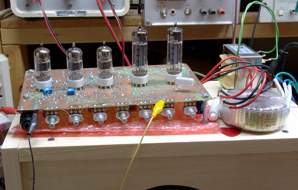

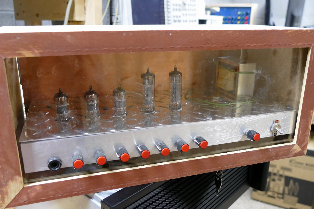

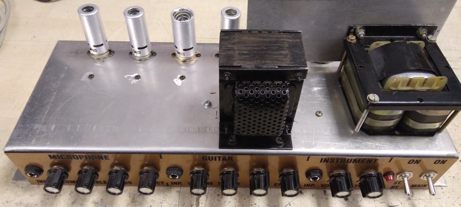

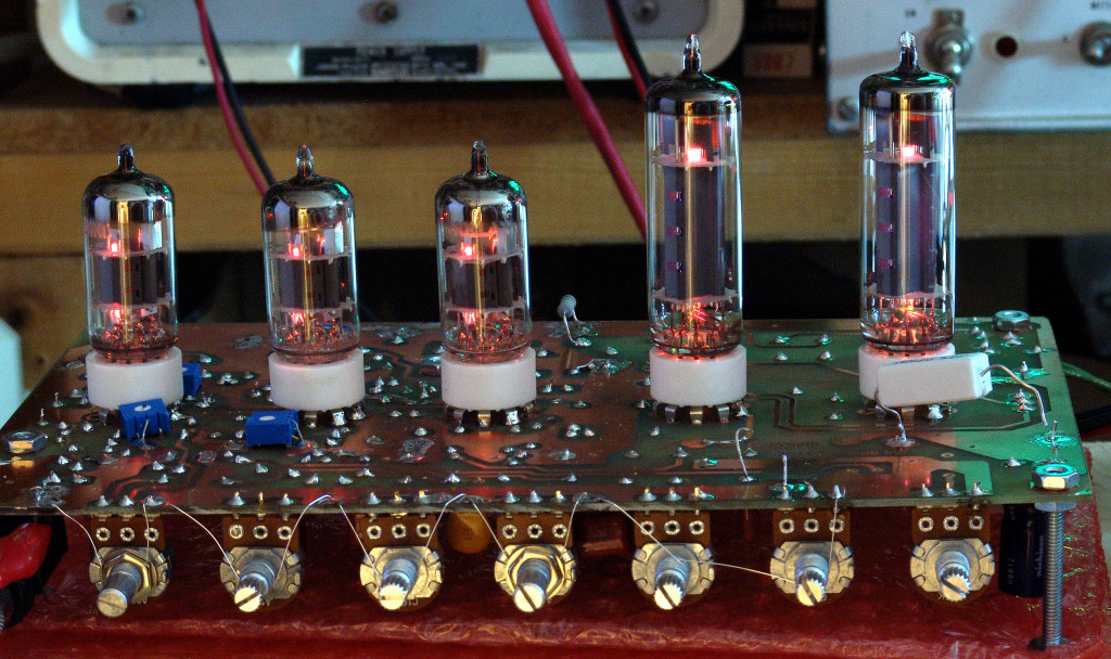

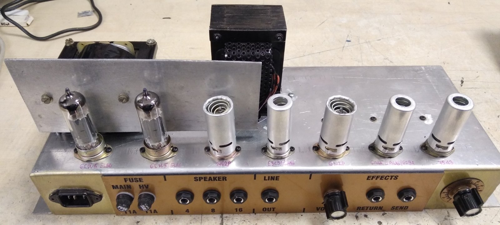

In the meantime, ~2 years ago, I made a guitar amplifier where the output stage uses a pair of 6CW5/EL86 (EI-Niš) at an anode voltage of over 380V. The amplifier works stably with no signs of overheating or oscillation, and the output tubes show no signs of aging despite working at such a high anode voltage. Although this type of amplifier belongs to another topic, I am publishing the schematic and a couple of pictures for illustration.
The primary impedance of the output transformer is Raa=4.2 kOhm, and the quiescent current of the output tubes can be seen on the diagram. The voltage measured on the cathodes of the output tubes was 20mV without a signal, and since the cathode-measuring resistor is 1 Ohm, it means that the quiescent current Ik=20mA for each tube.
