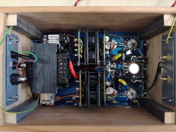

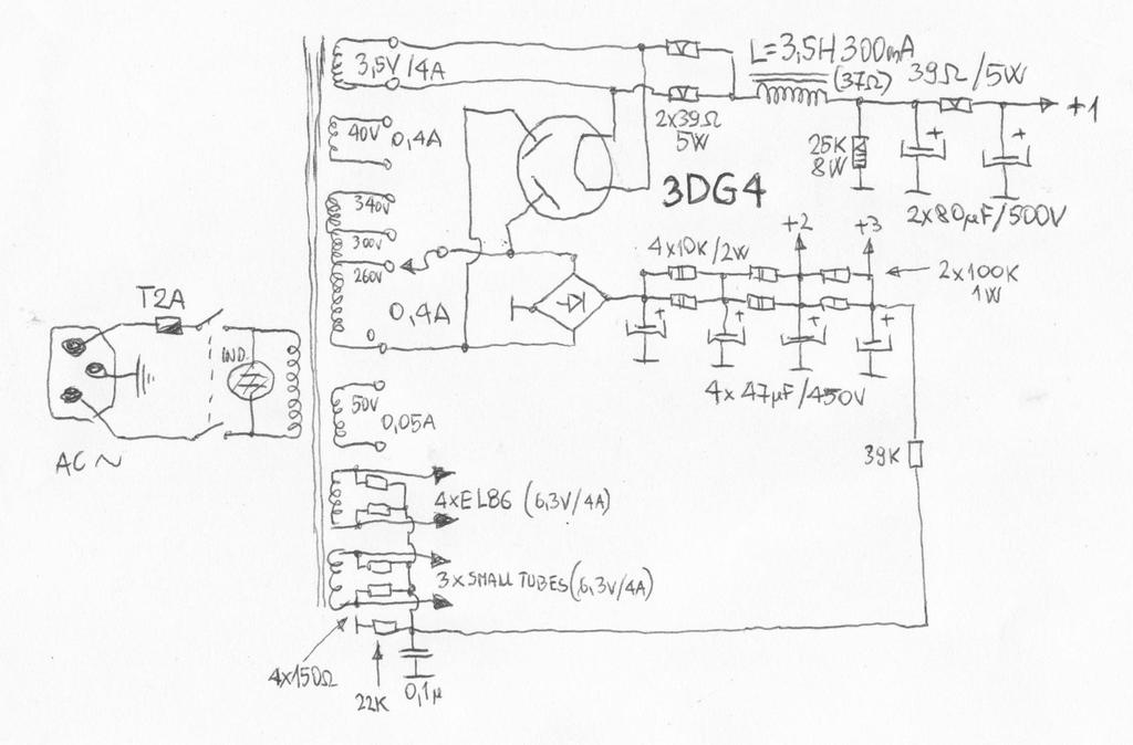

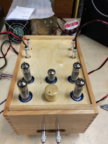

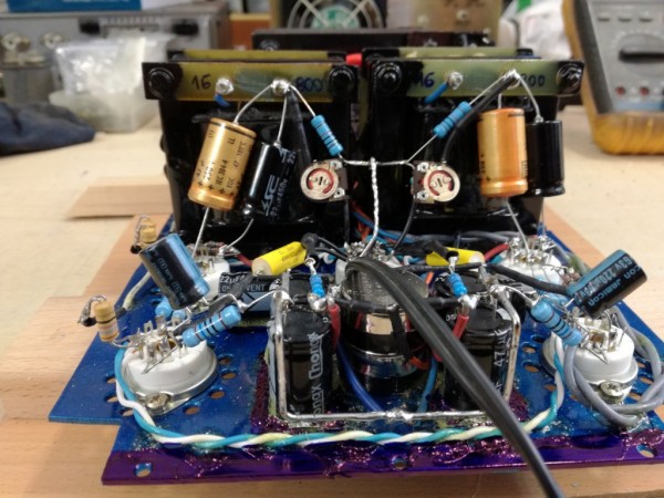

PP integrated amp with EL86/6CW5.

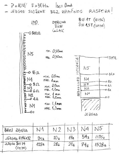

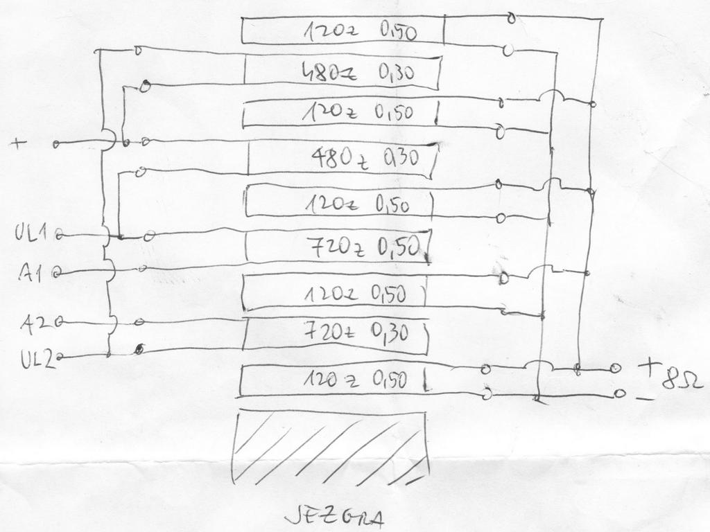

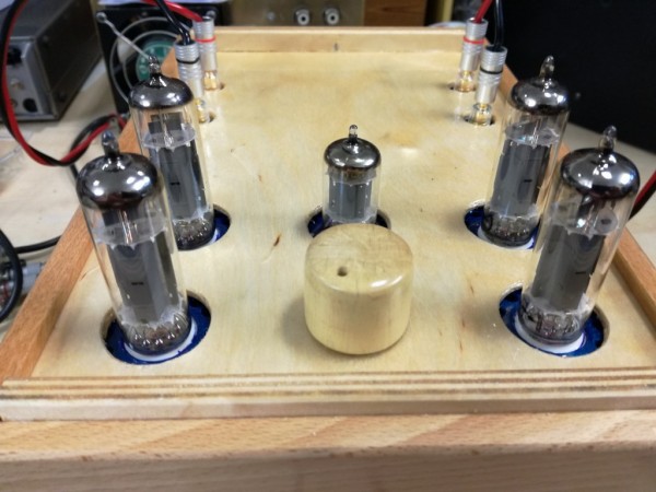

Hello Davorin,
I was searching for good designs of amps with EL86 power tubes and discovered your post. Very nice work! I especially like the chassis, wood and cover you made.

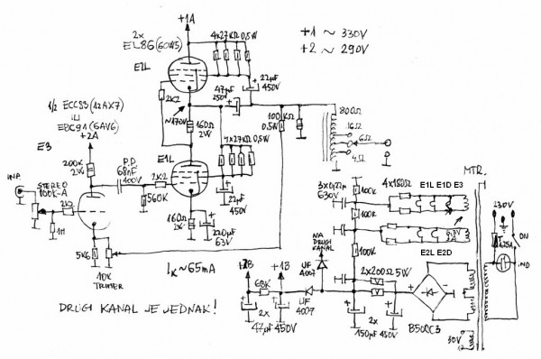

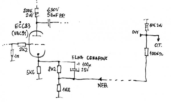

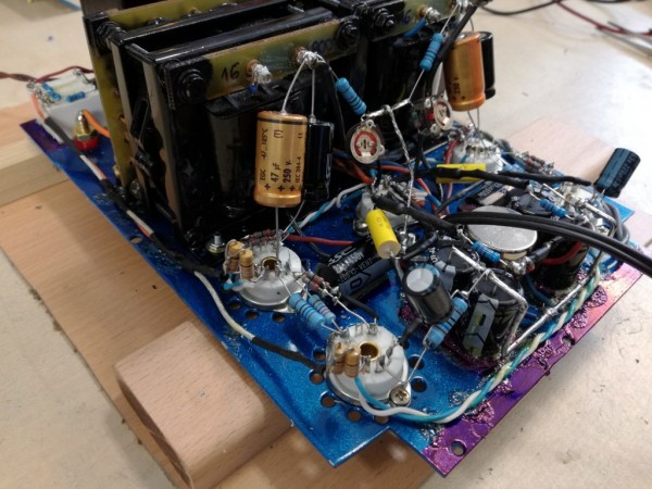

Looking at the schematic I wondered what tubes you used in the position of E1 and E2. I noticed you had an earlier design using EL86 and 6J6 front tubes. Is the later amp better, and do you perhaps a more recent update?

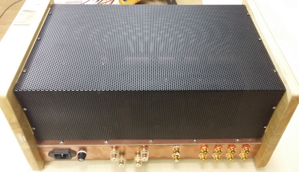

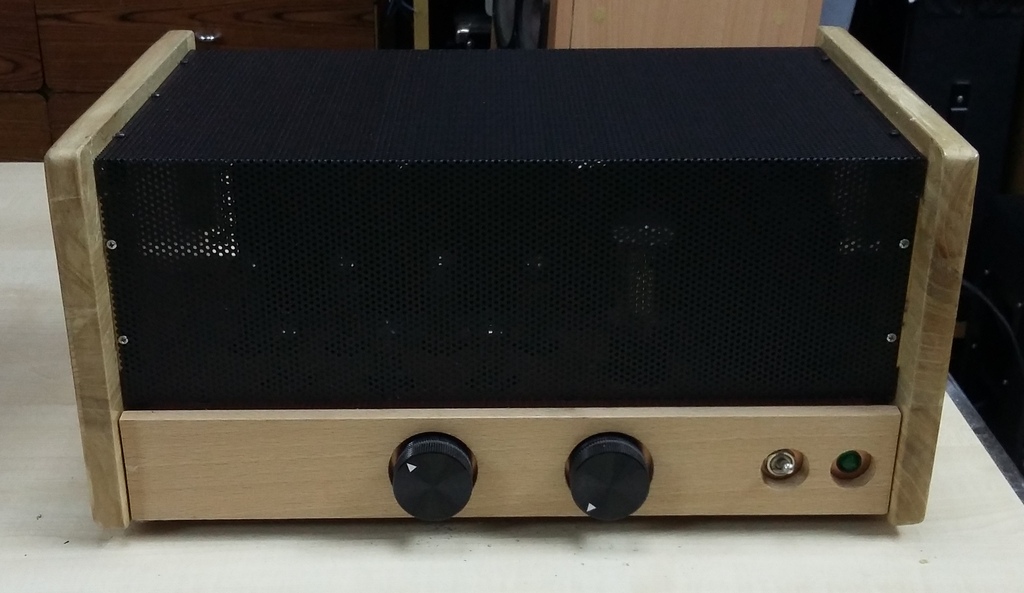

Simply and cheaply stereo integrated amplifier with EL86/6CW5 and ECC83/12AX7 (or 2xEBC91/6AV6):
I'd suggest returning the upper screen 'lytic to the upper pentode's cathode instead of past the output coupling capacitor.
Best regards!

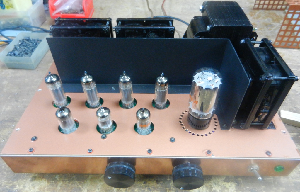

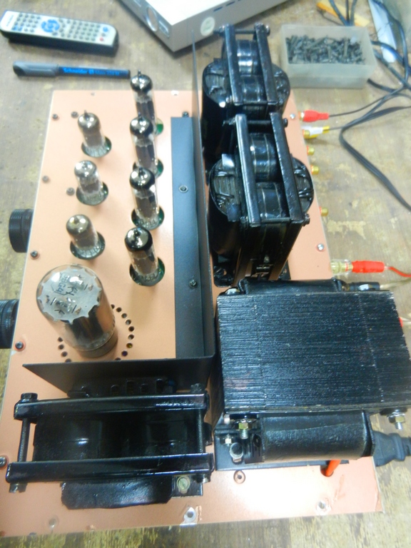

I have just finished a clone of the Tubelab SPP, using PL84, which is a EL86 variant. I have one on the PCB, and this was a way to get some practice creating a point to point wired amp, with the PCB as a reference.
After one teething problem - due to the difficulty reading the colours on those tiny 1/4 watt resistors (I am going to start to use 0.6 watt to make it easier) - I had a living, breathing amp, producing sweet music. The sound was comparable to my 6P14P (Russian EL84) one.
However after 20 minutes or so I noticed the tubes were starting to take on a orange-ish hue, the dreaded red plate.

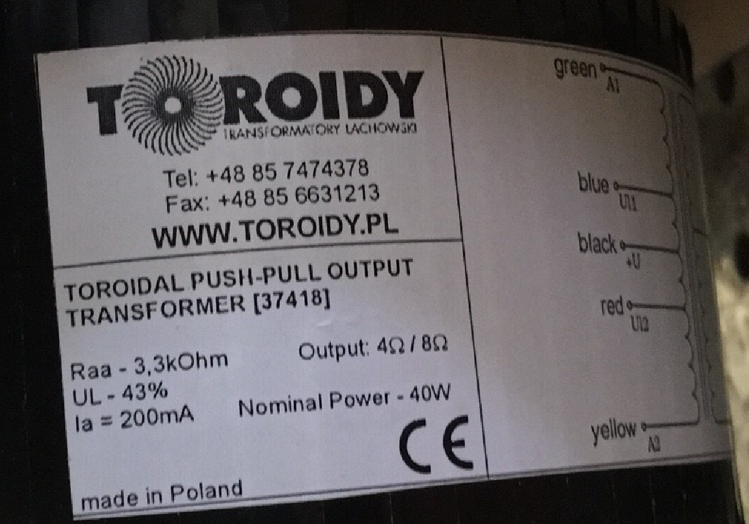

In comparison with 6BQ5, the 6CW5 needs another OPT with much lower (about half the value) Rpp! Did you respect this?
Best regards!
Best regards!
Yes, it is a special transformer for EL86:
3.3k ohms Raa, UL 43%, 200ma, nominal power 40W.
It is Toroidy - and I have noticed that they are quite big on EL86 solutions in Poland, and EL36 come to that - maybe more of a culture of exploring cost effective solutions? They also sell Polam EL86's on their site n their quite small selection of tubes.

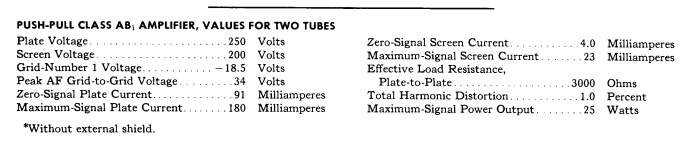

It has proved to be quite difficult to find anything definitive in the tube data sheets. It should be that 200V is the upper limit of screen, according to some data sheets.
The most comprehensive data sheet is for the UL84:
http://www.r-type.org/pdfs/ul84.pdf
There is a curve for Vg2 = Va = 200V, but I do understand that the SPP would be right on the limit.
But it does look like Rk is different in this documentation when comparing with EL84. Looking at that curve I mentioned, there is a point for a grid voltage of -17v, but it is on the bottom of the curve, which is non-linear, and looks like I(k) should be much higher - something like 150mA.

It puts 200v on the screen as the design limit.
AIUI I can increase the cathode bias resistor somewhat so that V(g1) becomes more negative relative to V(a), so V(k) becomes 20v and V(g2) ad V(a) are around 190v. That would put V(g2) into safer territory.
I've tried to find some other examples of EL86 (or similar) in a UL PP setup, and I can't find any schematics, which is unusual.
Is it something to do with the conditions changing when the tube is under load? The screen voltage will have the signal from the OPT in UL? Is UL a realistic topology with an EL86, due to te screen voltage limitation?

E1 is 5963 and E2 is 5751.
Both amplifiers work well and it would be difficult to decide which one would be best if tested just by listening music.
Amplifiers work at my friends homes without any problems and failures for years, and on the second amplifier I have built an octal socket for powering a gramophone preamplifier (MM + RIAA Correction with E80CF).
