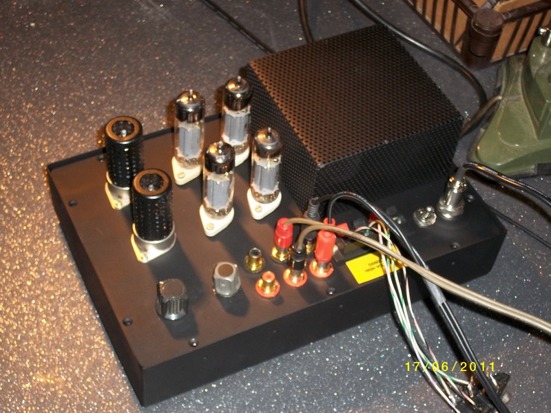

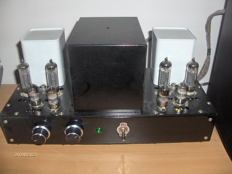

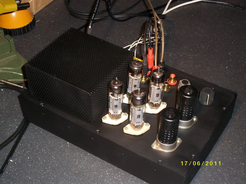

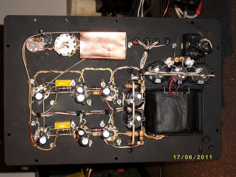

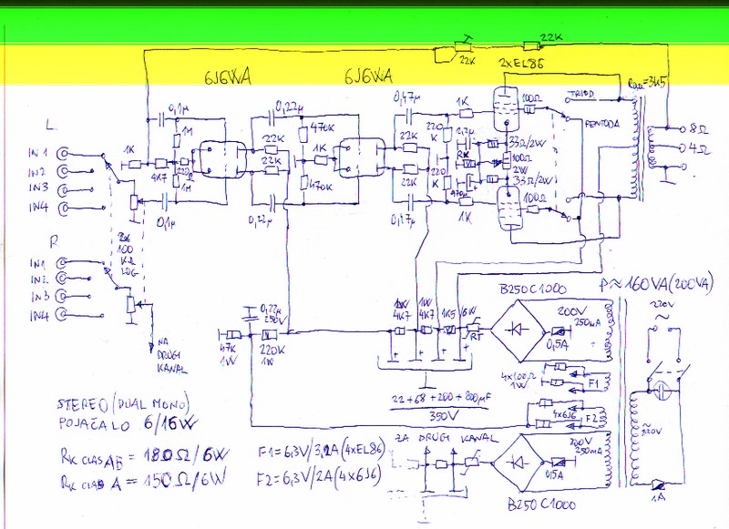

Hallo guys!
I make this amp with ECC88, 2XEL803 per channel, with some modifications for working point.
Of course, I made boxes with ellipsoidal, full range speakers 5W 600 Ohm, especially
for this purpose. Amplifier have very flat frequency response and low distortion, smooth and
warm tone. I use schematic for some old Phillips black&white TV set.

EL86(6CW5) works very well in guitar amp. at Ua~350-380V with fixed bias, but UG2 must be under 200V in this case. Output power was over 25W (Push-Pull classAB, Ua=370V, UG2=185V, UG1~-18-20V, Ia0=25mA) with OT impedance Raa~4kOhm, with THD~4%. Also work perfect in small HI-FI amp (2x6W, Push-Pull ClassA/AB, Triode conected with Raa~3,5kOhm, and Ua-k~230-240V) over 5years with 6CW5(EL86) from "EI-Nis"-manufacturer.
