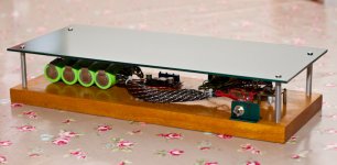

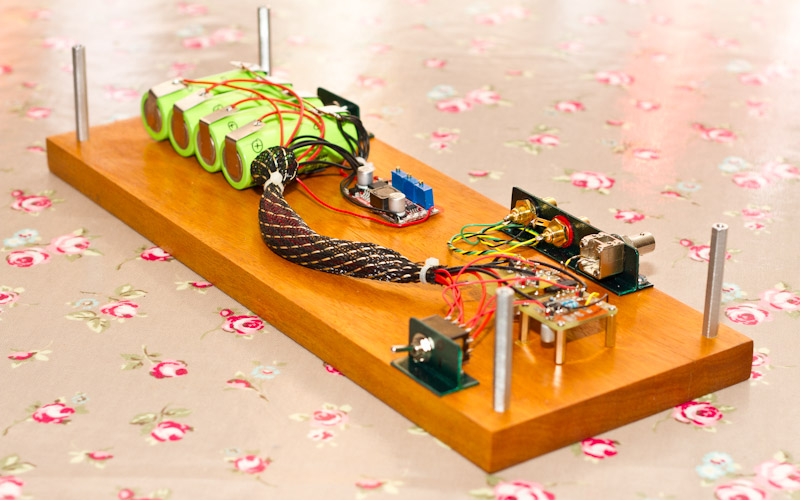

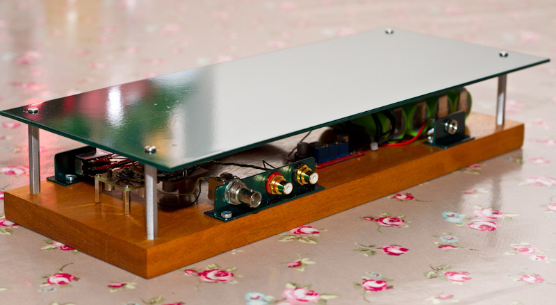

As I mentioned, I decided to do a little bit more work on housing the DAC. So here are a few pics. I need to add a little bit of acrylic for the front face .....
EUVL, its a pity I cannot wire as neatly as you can etch and build!
Wood, may I ask where you source the batteries from? Also, what scheme do you use for charging etc.?
Patrick, looking forward to seeing your website go live. 😉
