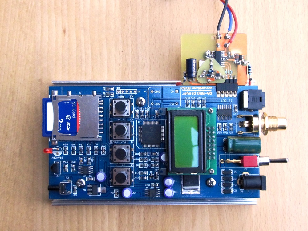

I tested the QA550 today with the TCXO removed, and directly driven by the divided clock signal from the ES9022 XO (45.1584 MHz).
http://www.diyaudio.com/forums/digi...ng-new-ess-vout-dac-es9022-2.html#post2458187
Sounds wonderful. Need some more serious listening.
So have to give John this one. Synchronuous with one XO for all remains the best solution.
Patrick
