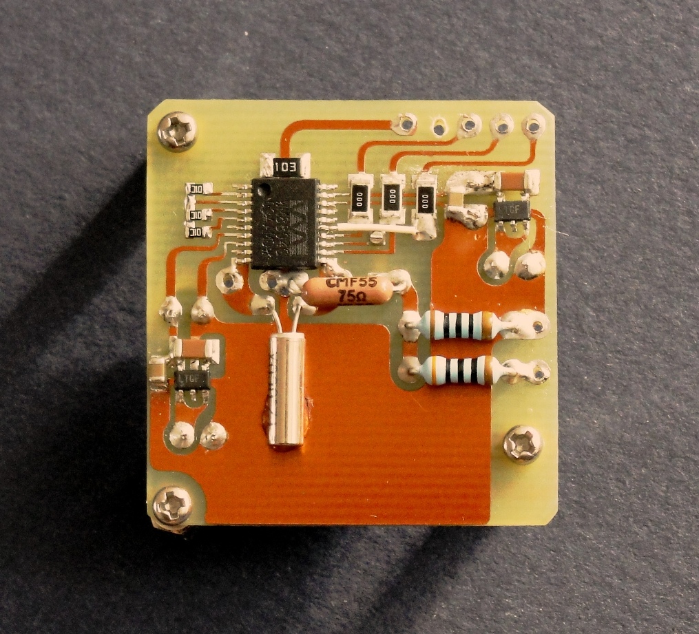

There is enough information from the photos for any true DIYers to copy the layout and make their own PCB in a similar fashion, if they so wish.
Patrick
so there is, but I have only just bought my first materials for making PCBs and i'm not going to start with a dac. I still have to get the process down first with more simple layouts
