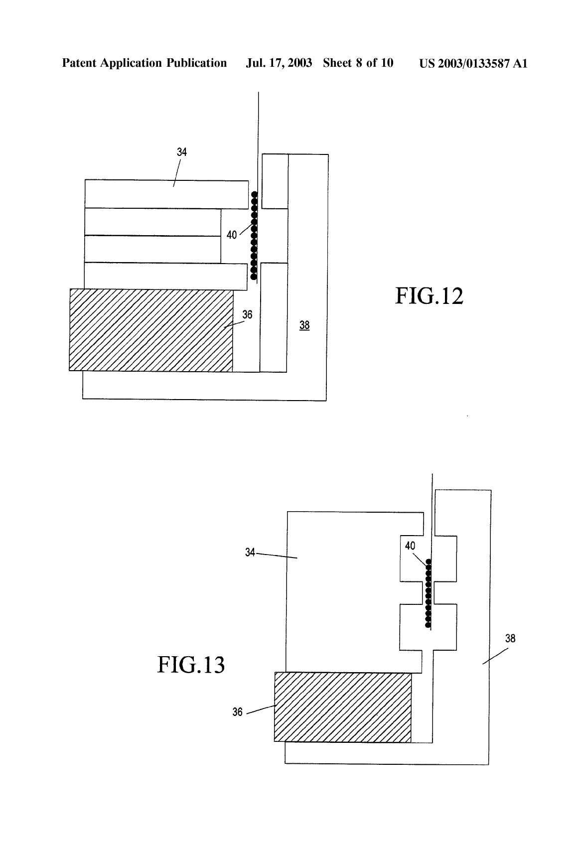

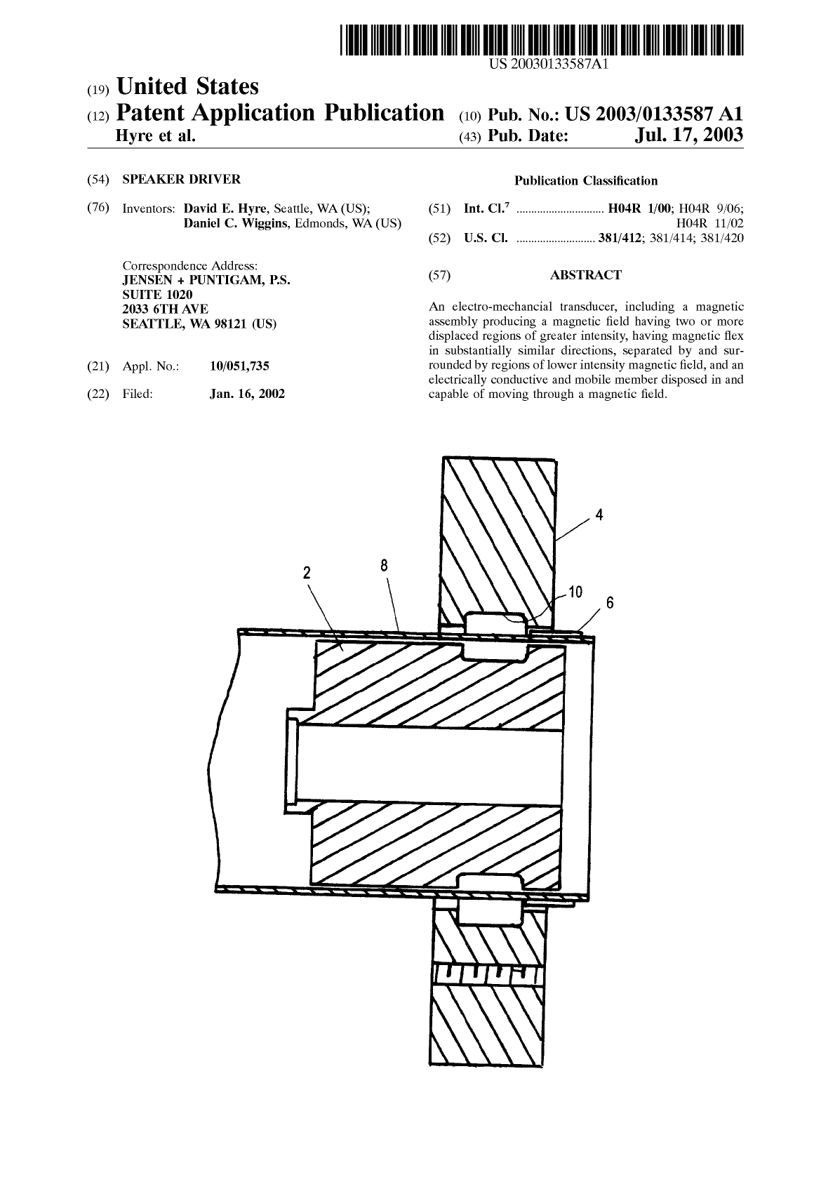

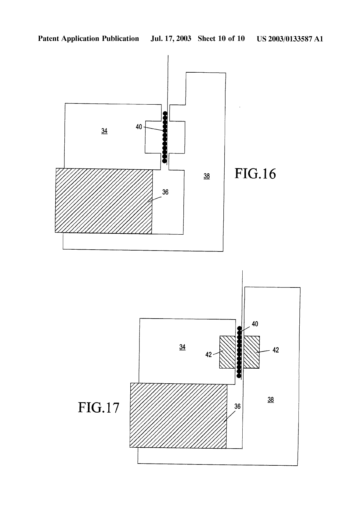

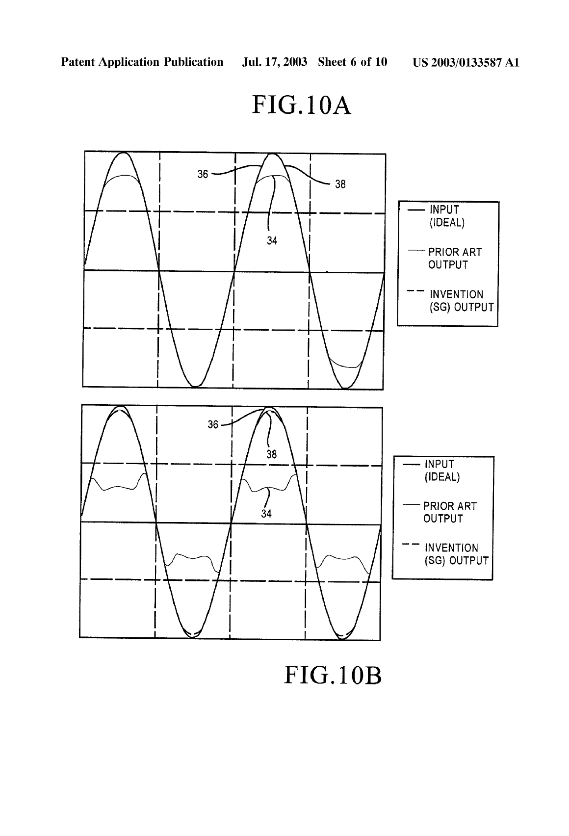

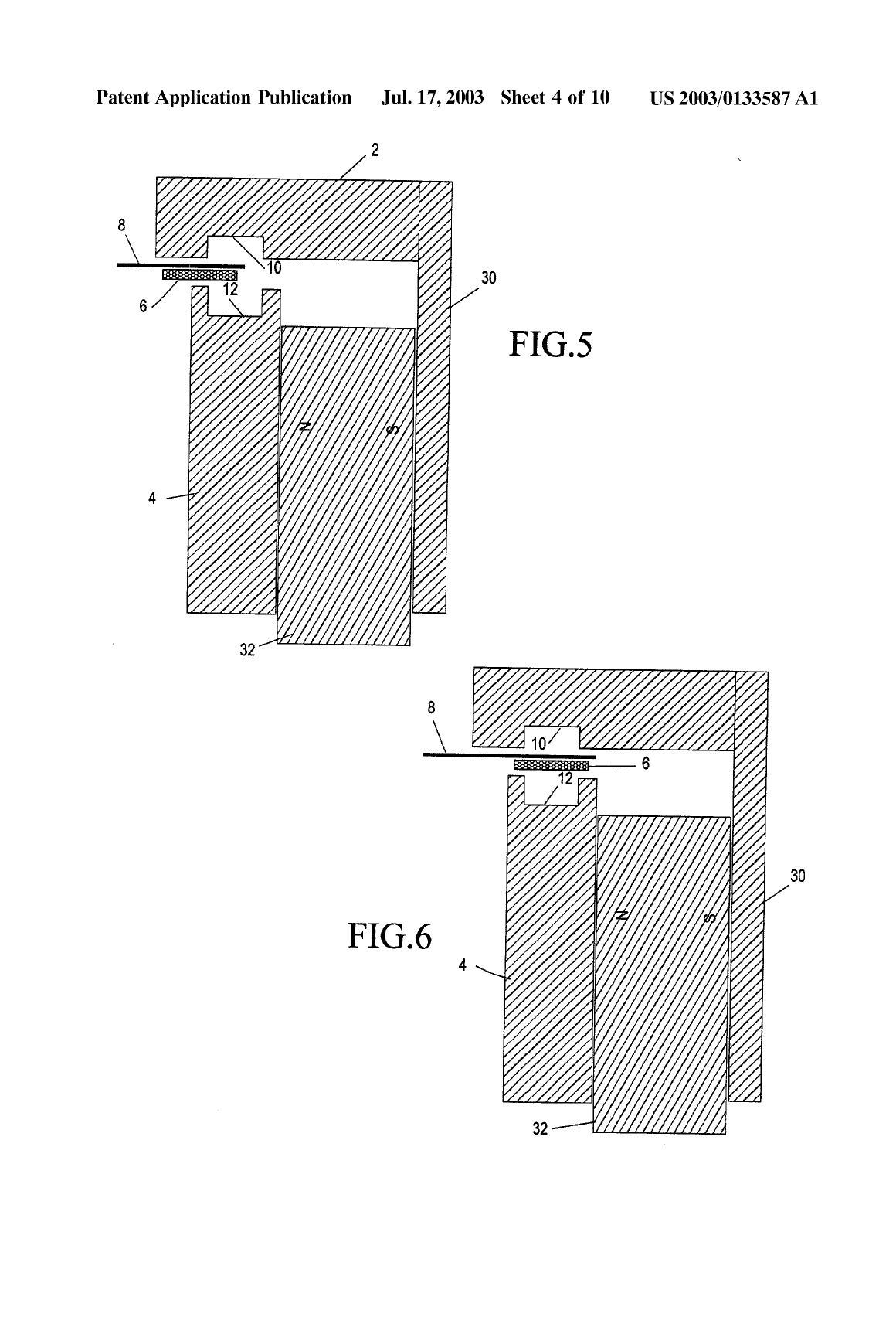

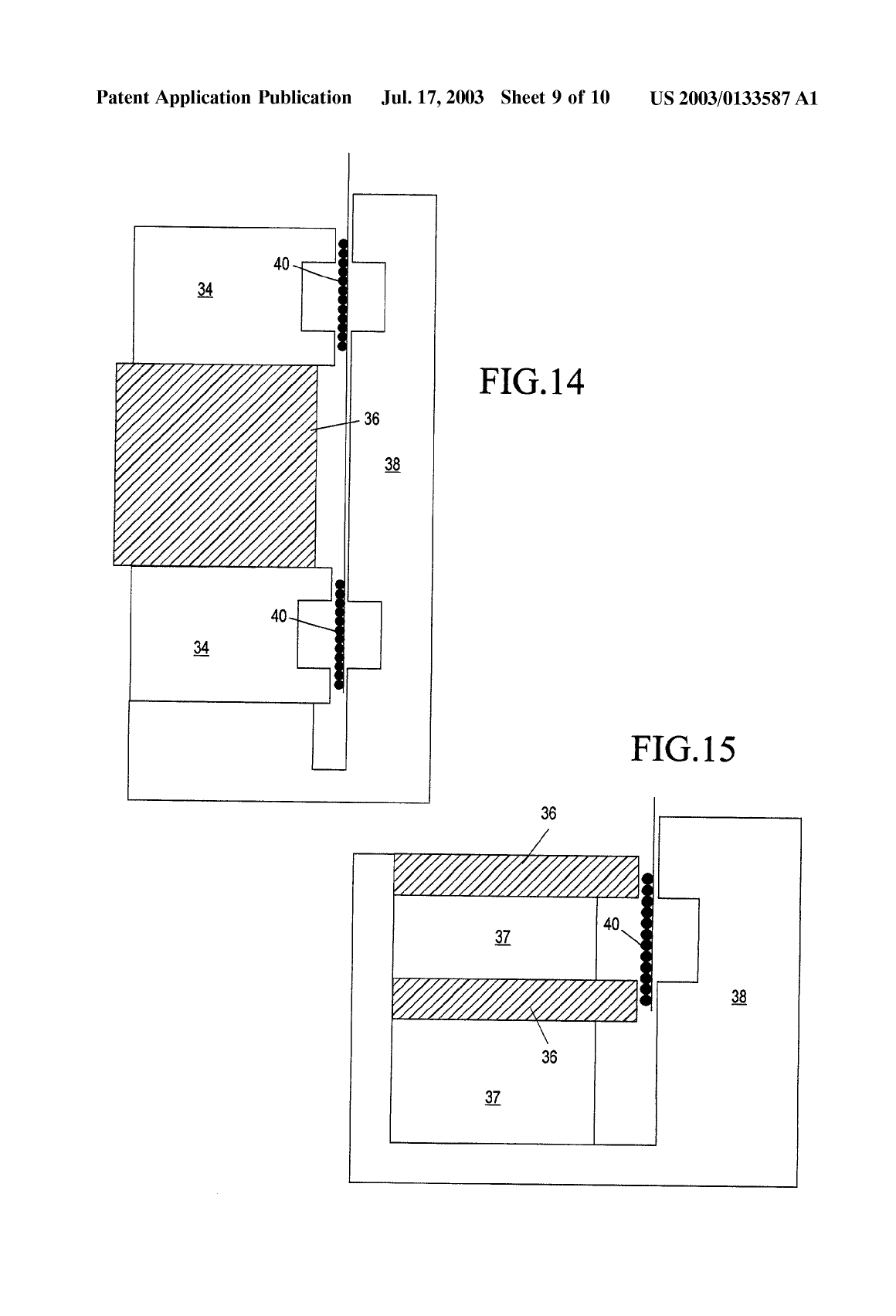

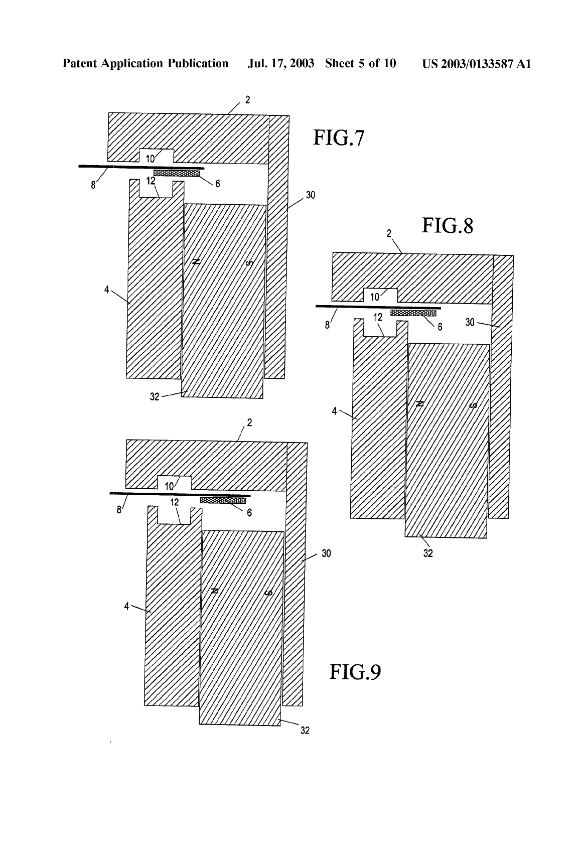

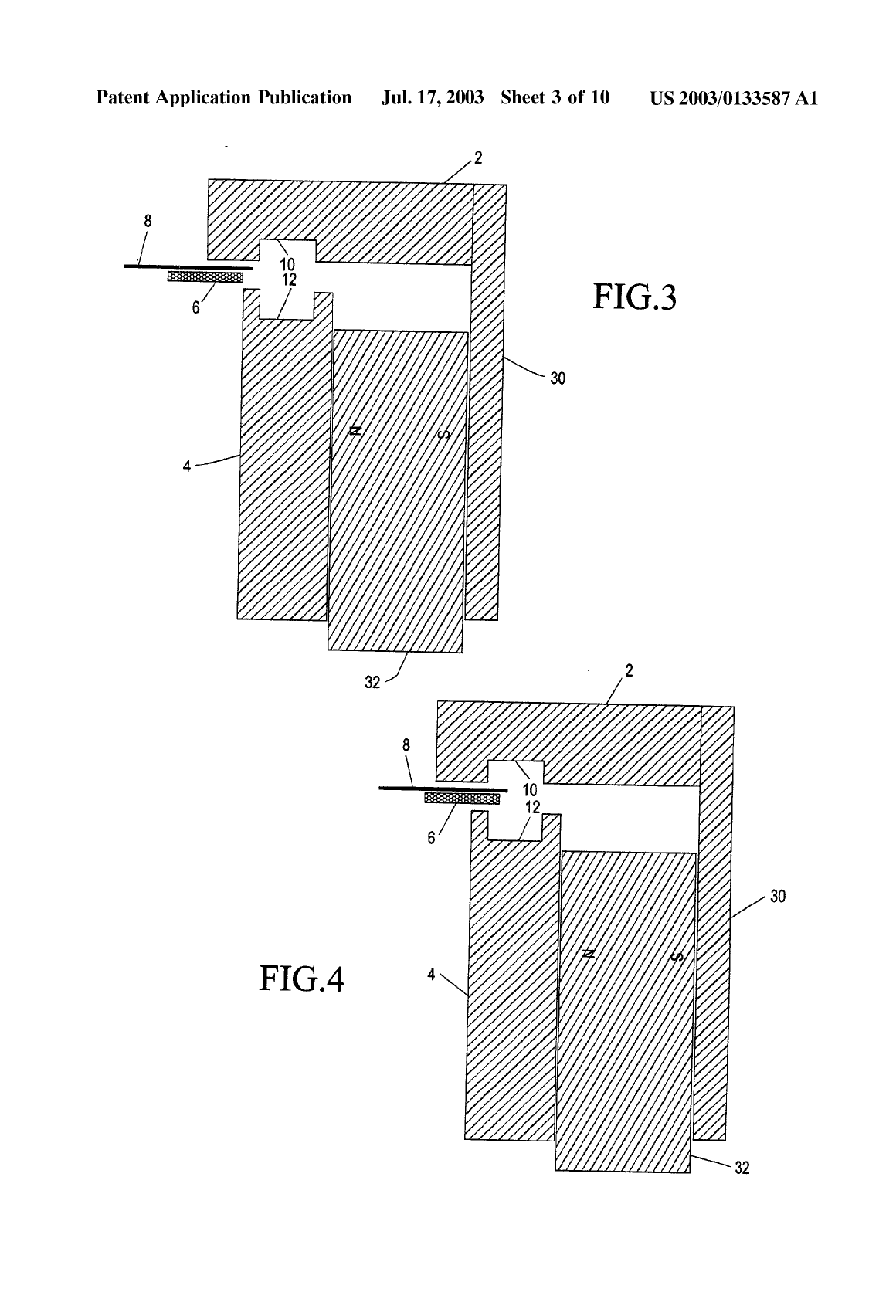

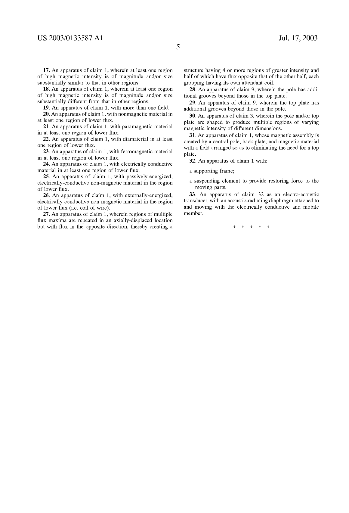

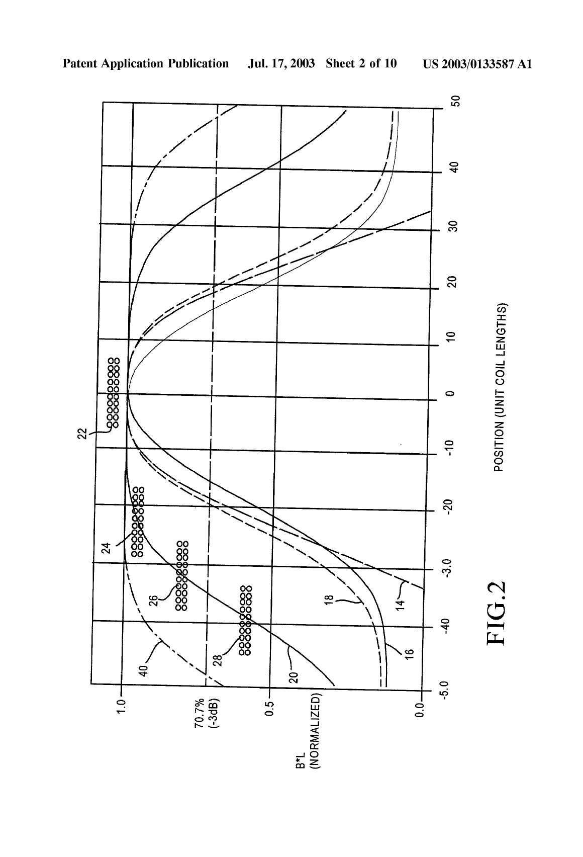

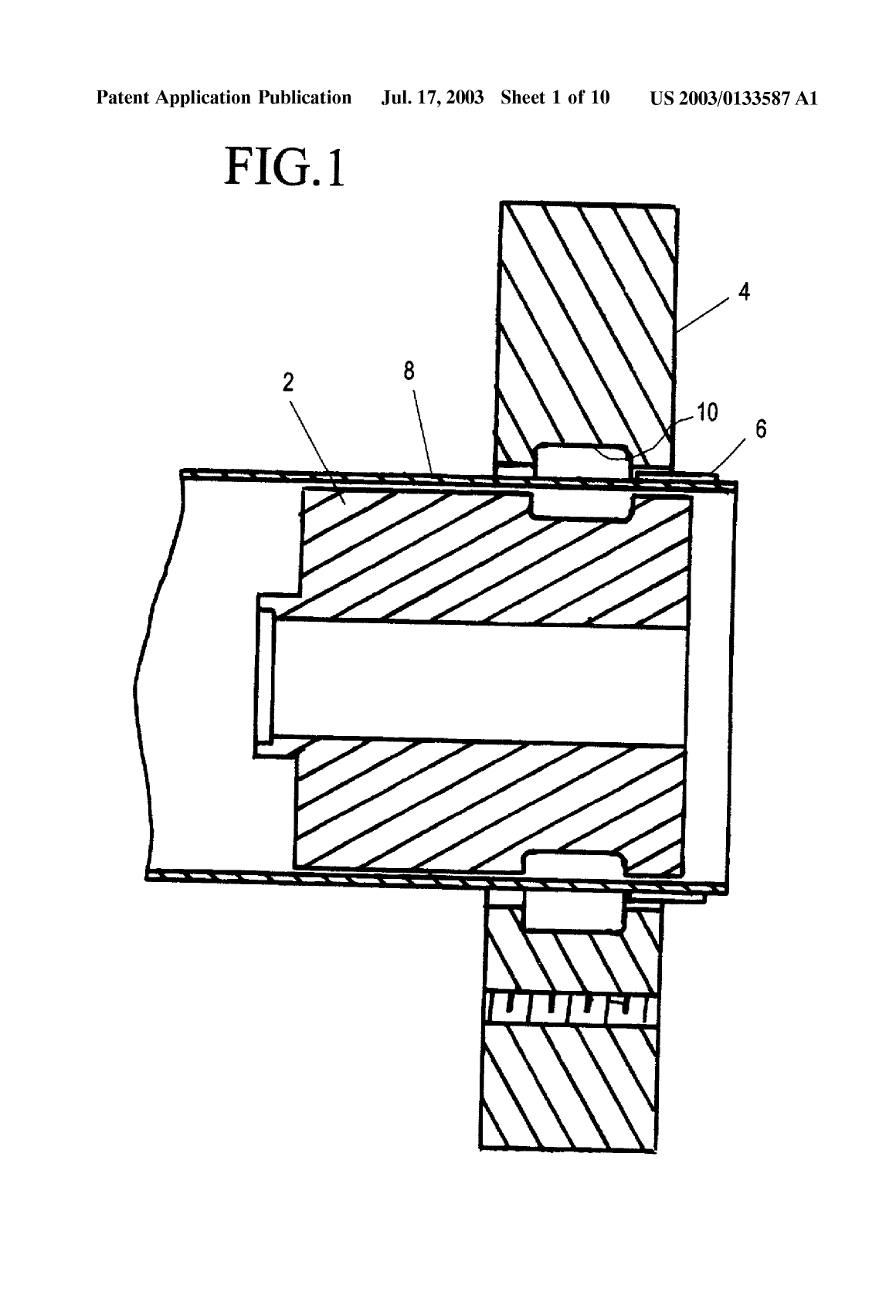

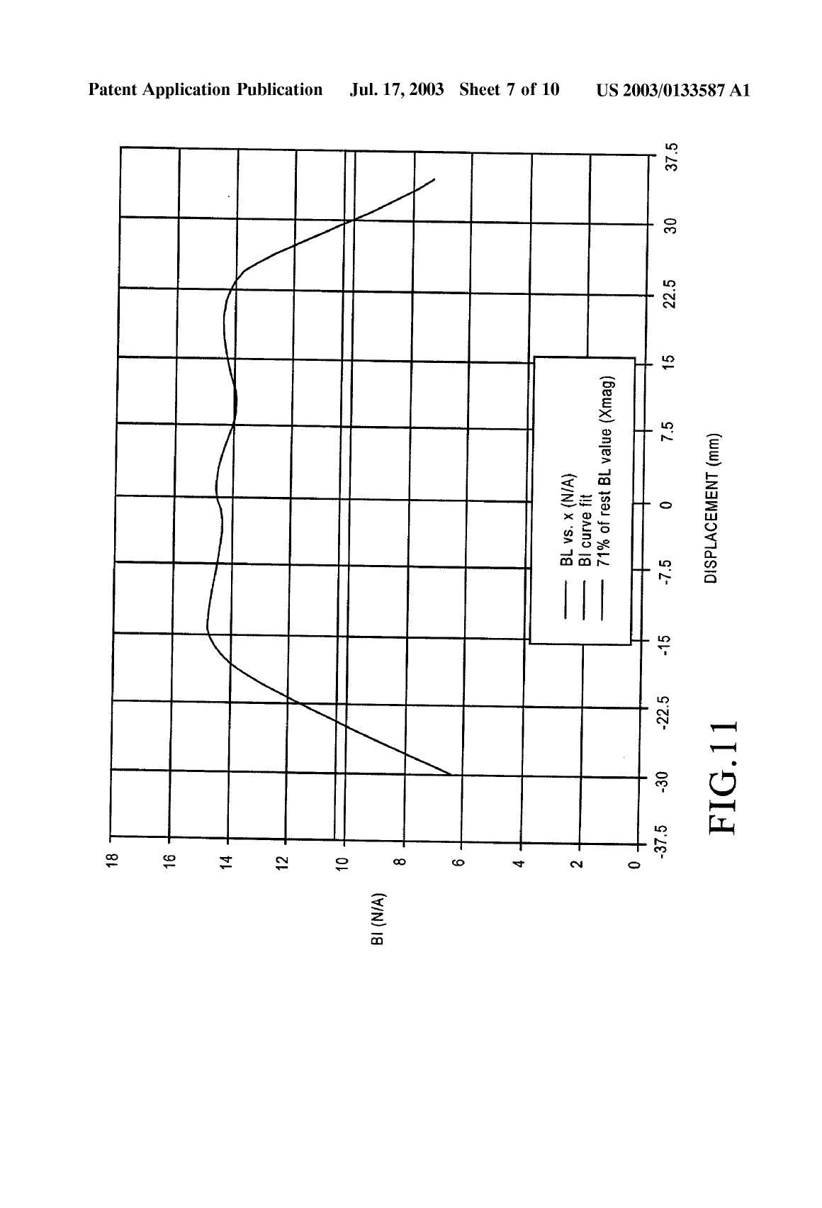

If you want to know the nitty gritty of XBL2 then read the patent application.
Search for 20030133587 at:
http://appft1.uspto.gov/netahtml/PTO/search-bool.html
Its titled 'speaker driver'.
Go to the bottom and click 'Images'. Its quite an interesting read.

Black, thanks for the link. I can't get the image link to work. Has anyone else had this problem? I have tried it with both IE and Mozilla browsers. Everything just freezes. Has anyone downloaded successfully who would be willing to email it?

I've now tried it having installed the latest version of Quicktime with internet explorer, and it works fine now. It doesn't seem to work with Mozilla.
For those interested in viewing the patent images who use Mozilla/Firefox, or may be having difficulties with Quicktime or other .tiff image plugins, I took the liberty of converting them to the more universally-usable .gif format and hosting them as a matter of convenience.
The file sizes are still reasonably small (ranging from 40 - 150 kB) and I scaled them down a bit so they should be viewable on most systems with a minimum of scrolling and such. They won't print out at a useful size without some fuss though.
