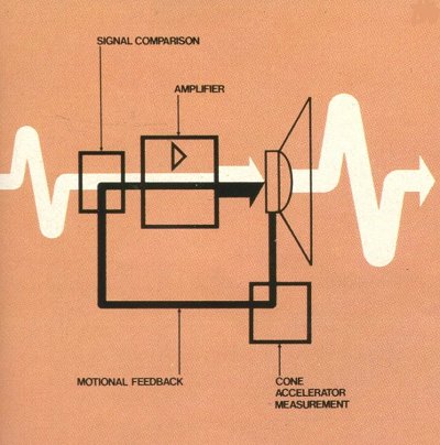

I had a set of Philips MFB loudspeakers in the 80s, Philips developed the first motional feedback loudspeakers in 1978.
At the time they did not sell that well because of the high price for small loudspeakers, a couple of years later Philips stopped production and sold the concept.
Here in Eindhoven they seem to have a tradition in selling their technology: CD-DVD-Plasma tv's
Today still, these MFB loudspeakers are wanted items, $ 400 for a 20 year old set is not unusual.
The IC in your Velodyne plate amp is the comparator of the motion feedback signal and the entrance signal, not surprising that it is a Philips programmable.
I added a block diagram pic for the Philips MFB below, it probably matches the Velodyne's.
The feedback circuit on one of the MFB's i had disfunctioned, without it the loudspeaker sounded no good.
At the time i had a relative working at the Philips development lab who fixed the feedback for me.
MFB makes it possible to use a class D amplifier on a woofer that normally would not be able to have sufficient control over the speaker.
Velodyne builds awesome speakers, my guess is that the one you've shown needs quite a hefty amplifier to make it sound promising without MFB.

Yep, thats what i said.
I am sorry if i gave the impression that you should not bother.
Maybe with less bulky drivers these amps can be fun, the switching powersupply is impressive.
The idea of MFB was to have better control over the driver, putting less emphasis on the amplifier.

i have good news too. i ended up taking home that driver that i was taking pictures of. im not sure what's wrong with it, but i guess its blown or something, so we were just going to toss it. im going to hook it up tonight and see whats actually wrong with it (pray for NOTHING), but im sure something is wrong with it.
but either way, i can see what the accelerometer looks like... i think its hidden under the dust cap. i could probably melt down the frame and sell the metal to build a tank
going to test the amps with the driver too and see which of the amps i have are confirmed to work. hooray, early christmas!
