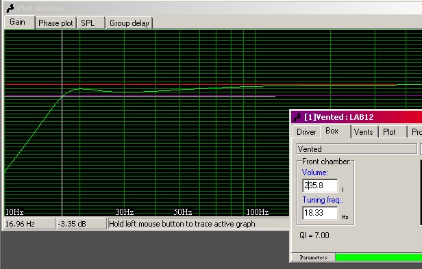

If you don't fancy the pro subs or the importing costs then you could try a -long- session going through the better brands of car subs and modelling them in winISD. The later version has loads of car subs in it's database. Watch the x-max figs on them, some are low excursion compared to the adire etc stuff..
Just did an 18" JL in a ~300L (might have been nearer 400 on second thoughts) box. Did your -3dB @ 15Hz requirement.
btw - don't forget about room gain when you model, unless you actually want a boomy response in room. - For example in my room a sub would need to be modelled to -10dB @ 15Hz to be measured flat 'in room'

How about the lab12 drivers? A bit of a fudge but 'kind of' near your f3 of 15Hz..
