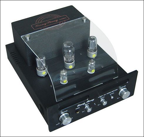

After powering on with the Russian GU-50 tubes, a purple haze appeared inside the tube and I heard loud hissing in my speakers. Is this arcing?
This phenomenon happened to both channels, so it's unlikely there's a defect in the tube. They are OTK certified too, which is the highest Soviet military standard.
I also own this amplifier. The purple haze you are seeing in your tube is most likely a vacuum leak. Check this website:

The power transformer appears to be wired for 220V operation. The manufacturer simply added a 110V to 220V transformer in front of the original power transformer. There's nothing wrong with this. It just makes the voltage switch on the IEC socket useless.

The schematics of the amplifier.

I suspect there may have been a vacuum leak as well. I am trying GU-50 tubes from another USSR factory to see if there is the same problem.
That schematic is close, but it's missing the initial preamp stage with the 6N1P.
The 6N1 should be the driver tube, see my post #54

I was going to draw up a schematic for the Peach but I'm happy to see someone has already found one. Where did you find it siqdiz? I can't read any of the values in your image, is it available online? So far I'm still very pleased with this amp, as far as I can tell some quick mods might include replacing the 4 suspicious "WIMA" coupling caps in the input/driver stage, replacing some of the resistors in the signal path (about 6 of them) and repositioning and shielding the signal cabling (it is neatly zip tied to the power feeds from the factory
). Without a complete schematic I'm still not sure how the 6n1p driver tube is able to work effectively as the anode voltage at the socket is very low for that tube(~129vdc). With such a low voltage at the anode I figured I'd pop in one of the many 6n6p's I had in the closet. I'm sure the circuit isn't close to optimized for the 6n6p but it works and sounds very good, it has less gain than the 6n1p so its a little more relaxed, cymbals, snare drums and brass sound great. Even after hours of use, at levels loud enough to hear a room away with the shop vac running and the miter saw going the power transformer is just slightly warm to the touch, the ouput transforms never warm up.

The schematics I pulled from the Xiangsheng HeiFei website (manufacturer of this amp), they also produce the Music Angel. This is the best version I could find.
