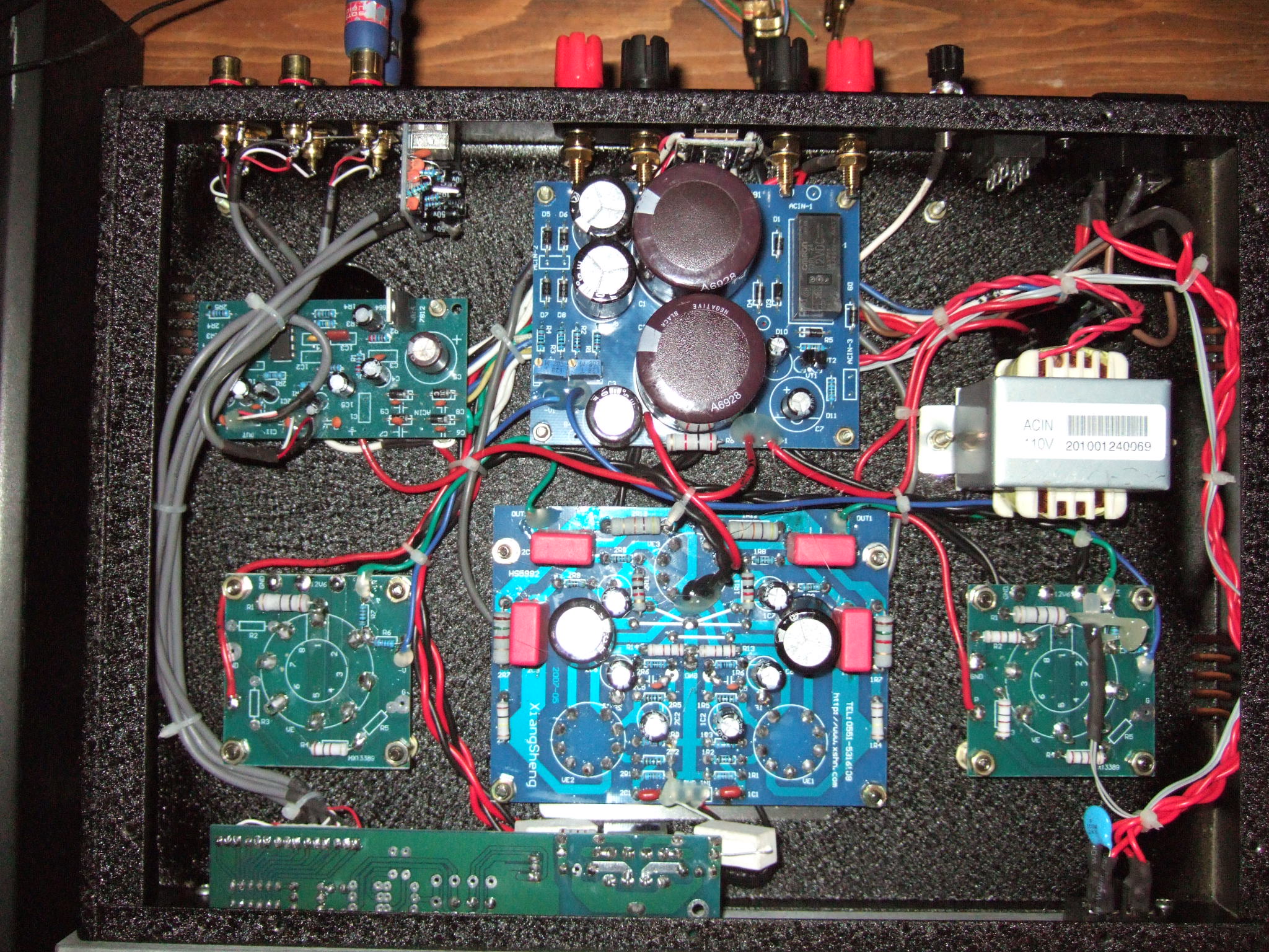

I removed the bottom panel and was surprised to see that the chassis is in fact grounded to the plug earth. There is no fuse. The layout is fairly tidy and logical. Just for fun I tried the built in mm phono preamp, yikes!!The opamp used in the circuit doesn't even have any labeling of any kind. I see two trimmer pots with leads going out to the FU50 grids but there aren't any for the input tubes. Might the input tubes be self biasing? I took some pics of the innards.
Are you sure there's no fuse? Sometimes they're built into the power entry connector. If not, you should really install one in that puppy! If something shorts out, (like a bad output tube), you can do some serious damage, like burned out transformers or even a fire. For a few bucks you can buy a inline fuse holder from Radio Shack, along with a 1 or 2 A Slo-Blo fuse. You don't need to drill any holes. Connect it between the hot (black) power cord wire, right after the switch and the primary of the P/T.

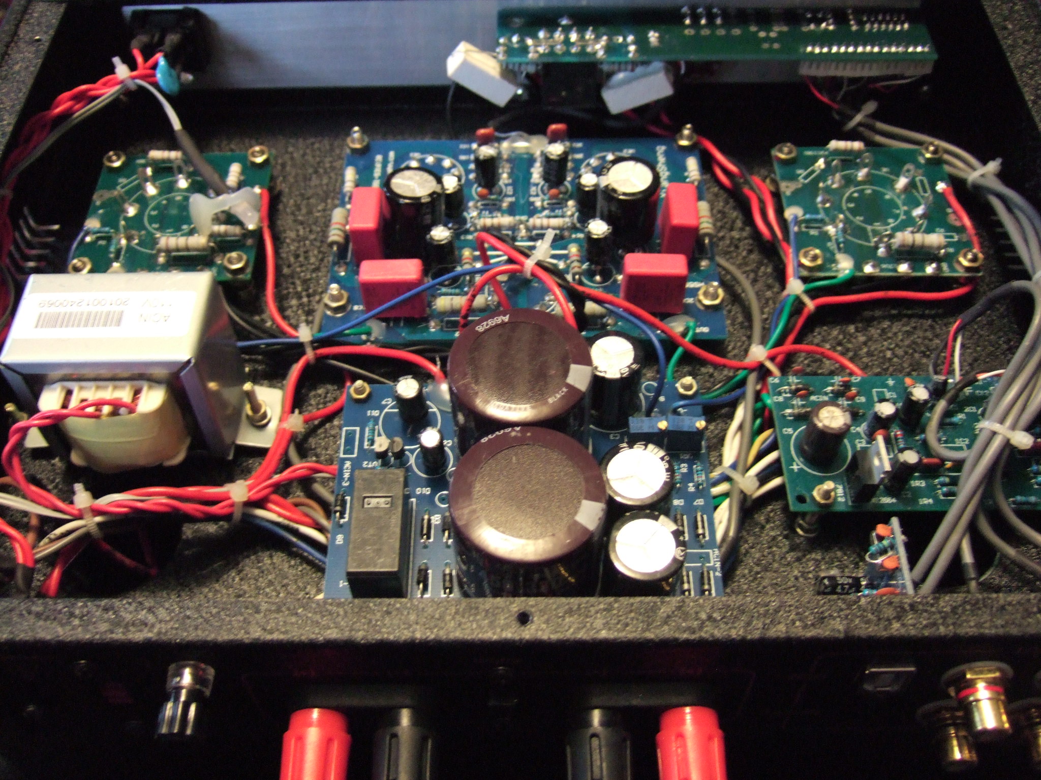

The inside of that amp looks nice. The modular construction is a bonus to us DIY'ers who like to rip things apart.
The mains fuse is probably integrated in the mains IEC connector, accessible from the outside.
Power supply looks like it uses full-wave rectifier, not the voltage-doubler that we find in many cheap Chinese amps, and there is a proper filter choke.
The two input tubes are (probably) Chinese 6n3 which can be swapped for Russian 6n3, or US 5670 / 2C51. Only one half of each tube is used.
One driver tube 6n1, one half used for each channel.
The FU50 power tubes seem to be permanently connected in triode mode.
SveinB.
SveinB.

Here's another picture of innards
The power transformer appears to be wired for 220V operation. The manufacturer simply added a 110V to 220V transformer in front of the original power transformer. There's nothing wrong with this. It just makes the voltage switch on the IEC socket useless.
