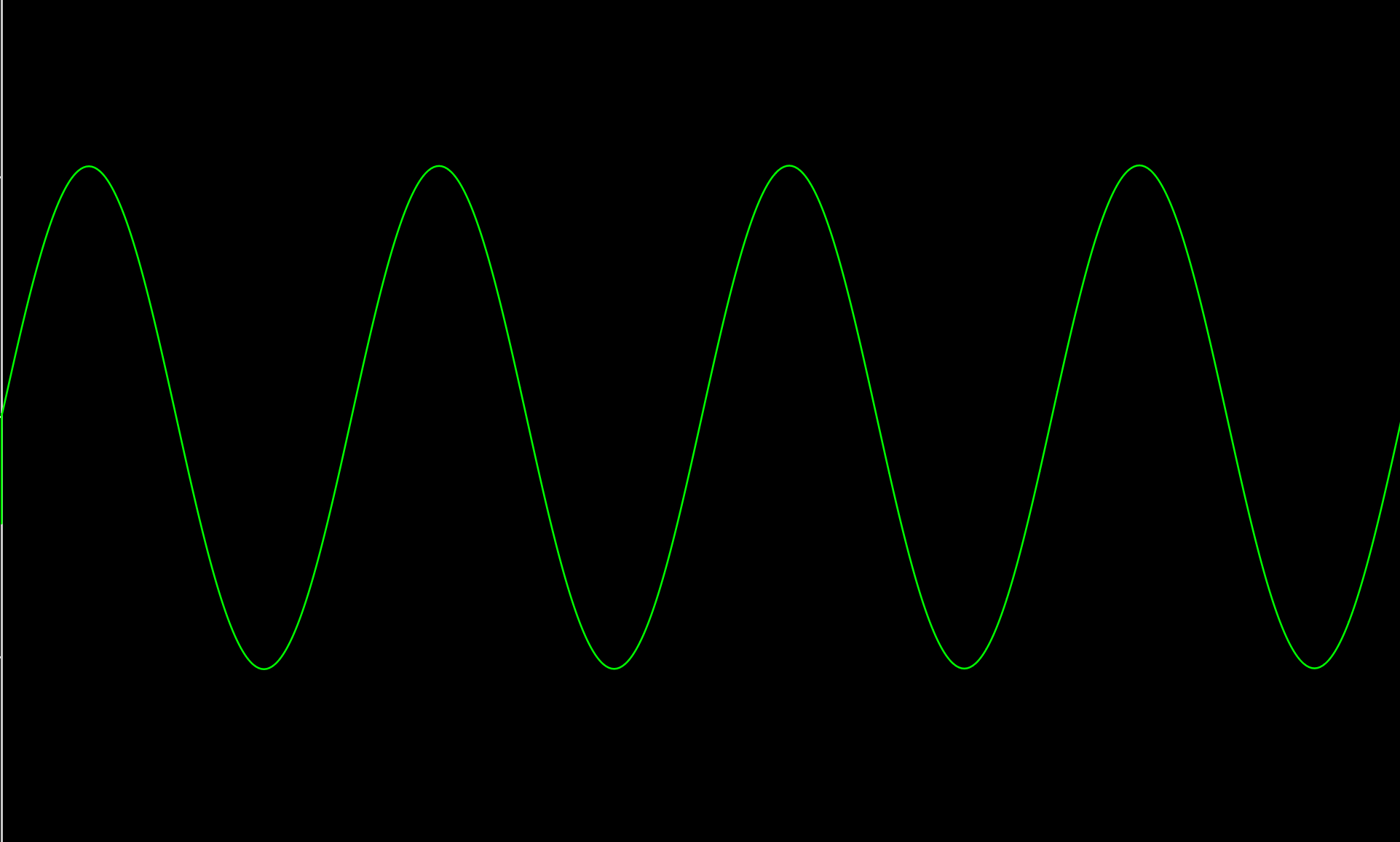

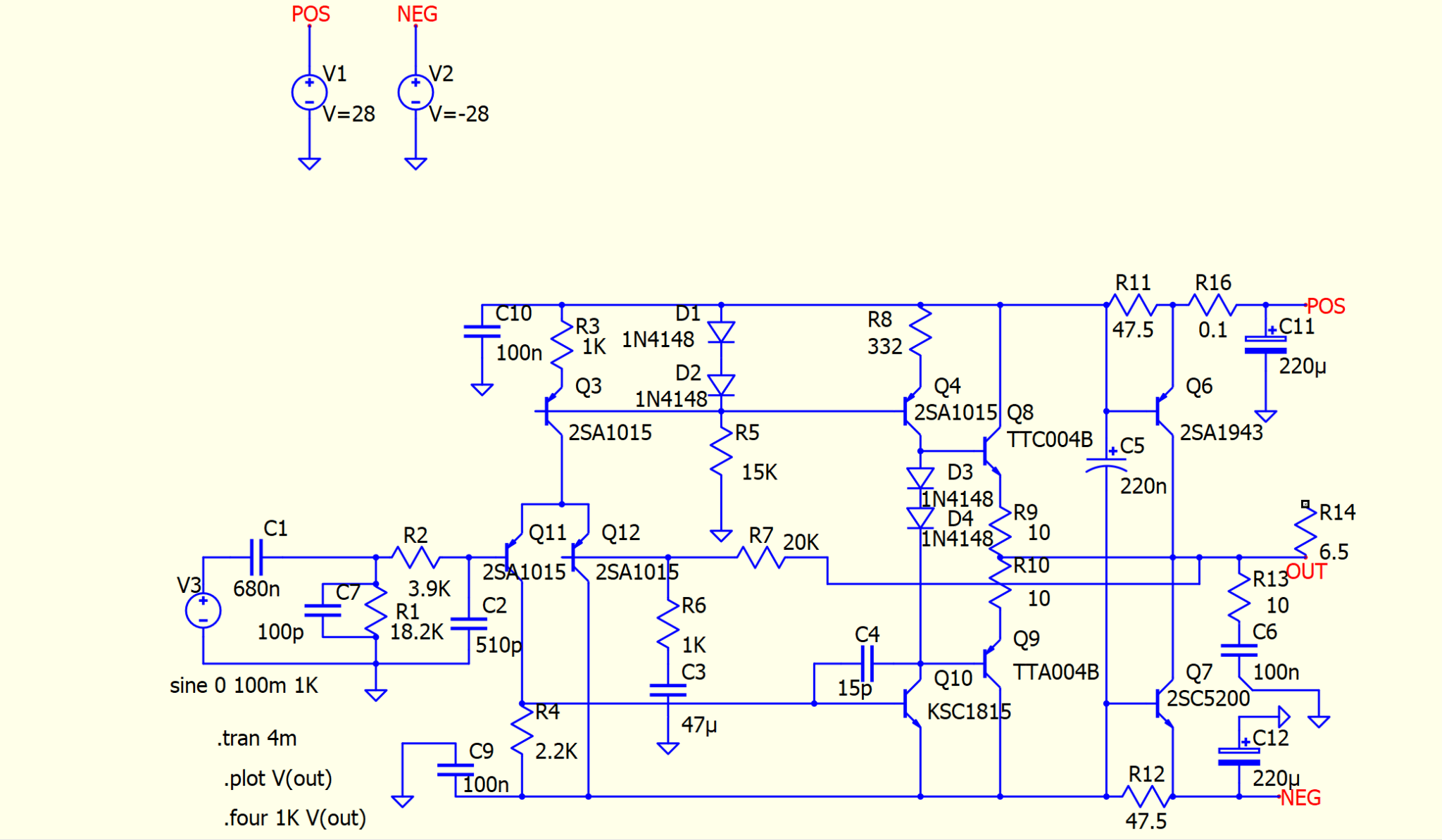

In quest of another Class-B I found a design on RedCircuits (https://www.redcircuits.com/Page150.htm). As the small-signal parts are now obsolete I have researched and replaced these as per the attached image.
In Spice I found nothing wrong but perhaps there are mods that may bring it up to date.
1. I would like to get feedback regarding the parts I chose to replace the obsolete ones (I emailed the designer - it's a 20-year old design and there's no plan to publish an update).
2. Has anyone suggestions for modifications?
