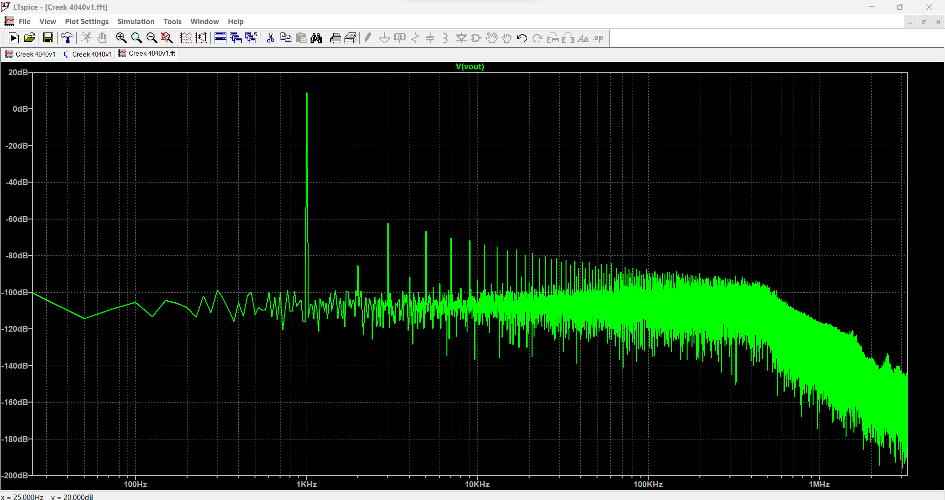

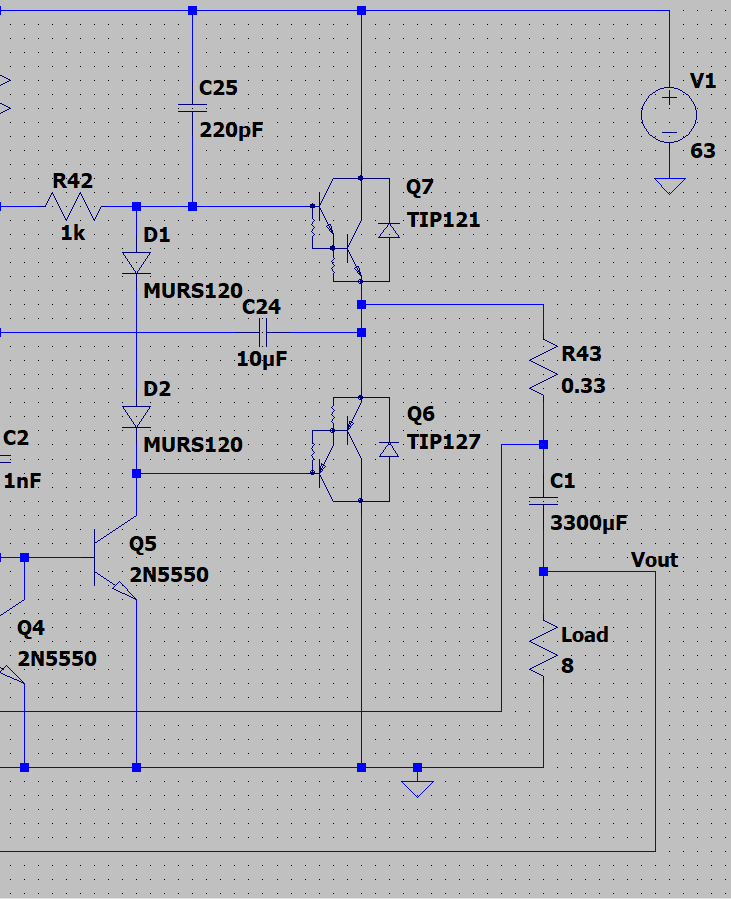

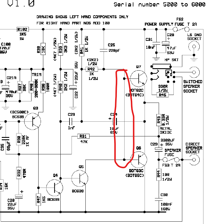

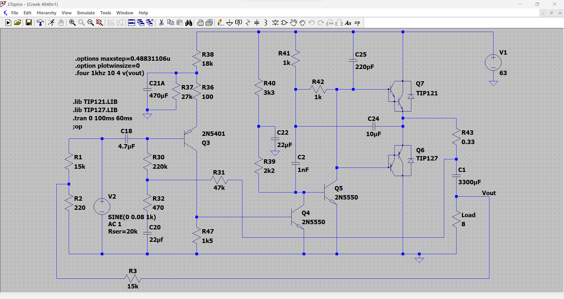

I know of only one and that is the Creek 4040v1 Even more remarkable is the fact the output pair are complementary Darlingtons and so have a huge 'dead zone'. The v2 of this amp did add a couple of diodes to lessen 'that gap'.

Doesn’t the “Dead Zone” make that class C?
That illustrates the problem with Class B. Trying to get the 2 pieces to line up with no dead zone and no overlap. dead zone = Class C. Overlap = Class AB.
dave

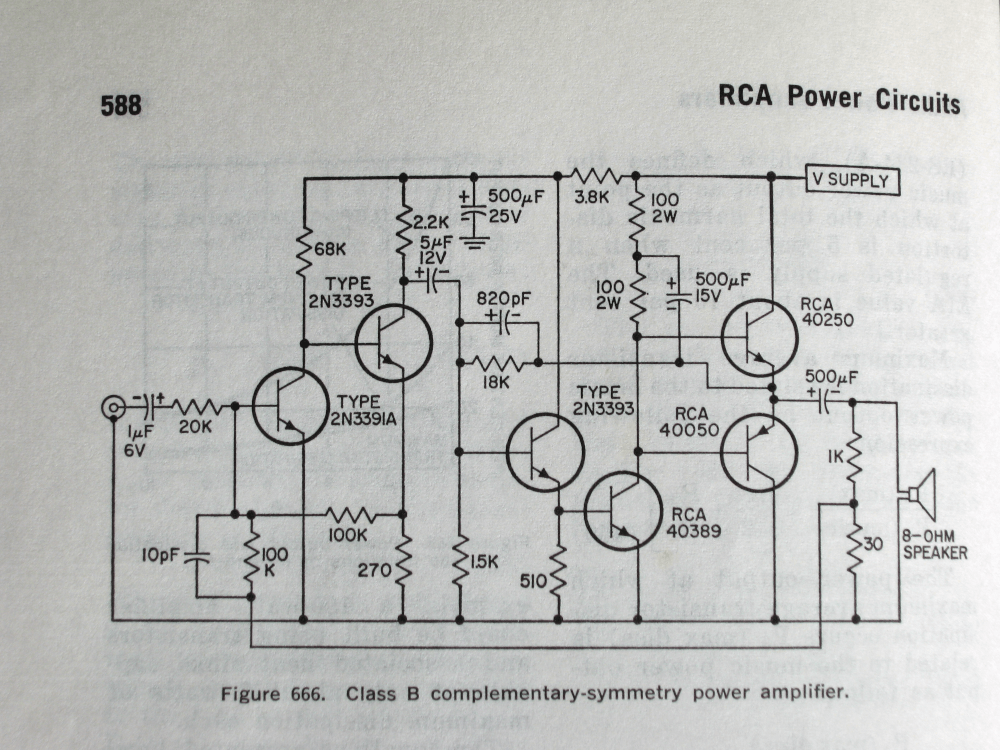

The "RCA Solid-State Power Circuits Designer's Handbook" (1971) described a class B amplifier. It was intended for less expensive equipment (read: not worth repairing). The RCA book also described a class AB amplifier for better equipment.

@Mooly , Doesn’t the “Dead Zone” make that class C?
I guess it does, yes. The v2 added diodes but technically it is still Class C as you say.
