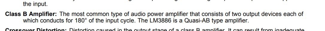

The Chipamp LM3886 is a class B chip and is a very popular device. See Tom’s Neurochrome site to see how good these can be.

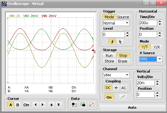

Say, lateral 'FETs running 100-200mA idle don't appear to fully switch off at all.
The above was simmed with Exicons running on +/-15V rails, and around 3.x V between the gates. The 2 squished curves show voltage across 100m ohm sense resistors (drain side) for the N and P MOSFETs, (20mV = 200mA) and the output was loaded with a not-too-shabby 8 ohm + LRC speaker model.
Distortion? Circa 0.00005%.
At higher output levels, the valleys get progressively more squished close to the 0mA floor.

On second thoughts the 2 sides do appear to fully switch, but it was clearly just a nice 'AB' setup that needed more voltage swing to reach that point.@abstract in your case where the opposing transistor doesn’t ever switch off, then that looks to me like class A or AB, but this seems to be a consequence of the low supply voltage as the modest bias current doesn’t really put it anywhere close to class A as usually understood. According to the conduction angles it would be class A, the kind of distortion figures you get also makes it look rather like Class A!

A true class B amplifier has zero bias
Class B means that that there is conduction during half of a cycle, at least.Class C amplifiers are single-ended.
As a silicium bipolar transistor only begins to be conductive when the bias
is a slightly less 0.4 V, your definition of class is not correct
A transistor alone can work in Class A and in class B.
