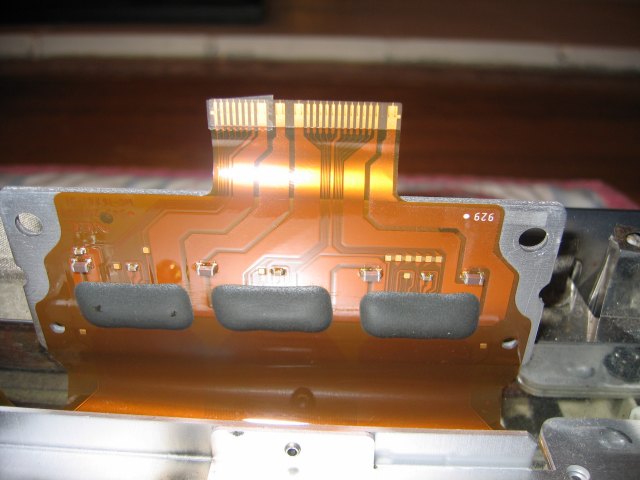

need more chemicals
I forgot to tell you in the e-mail. I tried removing the epoxy from the aluminum plate with an aray of chemicals I dug out of my barn. I figured the paint/epoxy remover would do the trick. No way in hell. That epoxy is not coming of any way but the hard way. This stuff is more like grout that is found in between tile on counter tops. I guess that would make sense since the whole panel gets pretty warm when in use. And what ever is under that epoxy must get even hotter.
Sledge hammer??
lol I would like to know whats under there. NEC wont tell me. It has to do with the power as theres a dead short once it pops.
I thought of the same thing as to them covering it becuase of the heat, but why would they cover it if the heat would not be able to dissipitate?
Unless they want to trap the heat and it uses the metal backing and the long strip that goes across all of them acts as a heat sink.
Not sure.
Not sure.
The "epoxy" is actually an IC package, just integrated into the ribbon, it is the cheapest way of making the most [mechanically flexible] circuit. It is thermoset plastic on a petroleum based plastic ribbon. Very conventional (as I'm sure most of you buddies would agree?)

NEC 4210W with black stripe, then burn smell, safemode
I have loved reading this forum. I think I'm a classic example. I know the inside of my 4210W pretty well. I purchased a 4203 from Baltamore. No luck. Anyway I had a black stripe outside of the 4:3 zone. Black bar was on the left of the display from top to bottom. After a few months just watching the tv it powered down, with the smell of burnt electronics. I now belive I should be looking for a blown driver on the tape and perhaps a blown fuse. Are these drivers usually on the left/right or top/bottom row? If they are on the top bottom are they hidden? If they are on the left / right tape, are they replaceable?
Like I said I have a 4203 spare for parts.
Thanks for any insight as to were to look.

I'm so glad to find someone else who's been in the same boat. Anyway, I found a burnt chip on the ribbon along the top row. Just like in the pictures. I tried placing tape over the connectors for the leads. Can you see if I covered the right leads?
You mention fuses blown. I have tested all the fuses on the board with a continuity testor but not removed them. There are two in the power supply. Two white ones on the left and two white ones on the right pdp boards. I was curious witch ones blow?
Are these the boards you said you replaced? (The left and right ones on the pdp with the white fuses?) I have two extra of those on my Baltimore PDP that I know work.
When your system went to safemode was it just a red led or was it left green? (Mine's left green)

If you have more then one burn in the ribbon cables, then your going to have more than on black line in the screen.
Yes you covered the correct leads on the blown chip, however, I had cases where I had to actually isolate the 2 chips at the bottom.
If you look at the burned one and the next good one, you will see that they are joined together. One screen I had I used a knife to seperate them, though I had screens where I didnt need to do this.
