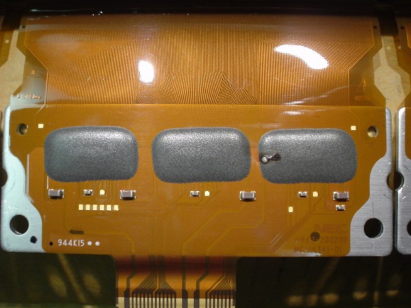

I got burnt
I found what you`re talking about Chipdoo, although it is more of a burn than a hole. At first I thought you meant the cables on the right side since the epoxy is visable. And also those cables have much wider conductors. Now I see what you mean about attaching a new ribbon cable, virtually impossible. I am going to need a really BIG magnifiying glass and a really small soldering iron. But I am still willing to try, some how. Do you have e-mail so I can send you my address?
Hello Q,
I would love to know what the hell it is thats under there that pops. And if there was a way to remove that crap on top......
Its amazing, something soo simple that ruins everything.
You can send your address to speednet@optonline.net. Im able to receive mail there, but I cant send out for some dumb reason.
I will verify wiht you as well once I receive your info.
If it was one of the side cables, it may be possible since the conductors are wider apart.
But these are really tight! The only thing I can think of is somehow perfectly overlapping the existing bad cable with a new one and somehow "crimp" them down together with a heavy weight or somehow fuse them together.
But I dont even know how to expose the conductors without ruining the cable.
Also, depending where in the screen this ribbon is, you can cut the power feed to this chip or with a razor knife and then you are able to plug the ribbon back in and use the two good chips. You will have a black section anyway, but it would be much smaller.
The current screen Im working on has a blown ribbon on the 1 ribbon cable. So the black thin line will be all the way to the left of the screen against the frame and it wont be too noticeable.

This is what you will see.....
Thats the black section. Notice that the ribbon in this set has been unplugged. It would not work if it was still plugged in becuase it would shut itself down, so somone pulled the ribbon out of the connector.
As I said before, you can cut out the power to that chip and plug that back in and you have a much thinner black line, but this one is in a bad spot to have any black sections period.
Some pics....
I hate to post a reply, but I cant seem to edit my post.... :-/
Anyway, the first picture you see is the ribbon cable. You can see the black epoxy with 2 little holes in it thats blown. If you look at the ribbon, I cut the power and ground and any other conductors that are going to that chip. This way I can plug it in and have the remaining 2 chips work fine.
