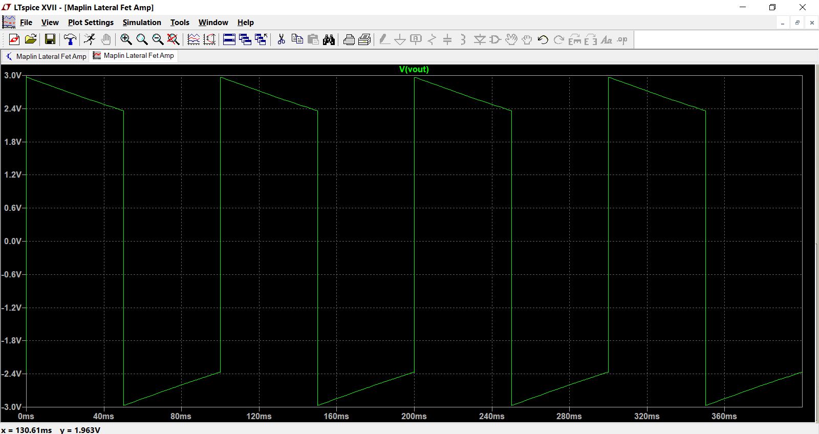

C5 & C6, The circuit as is, the output is slightly out of phase with the input but I didn't make a note of how much, probably somewhere around 15 - 20 degrees at a very rough guess.

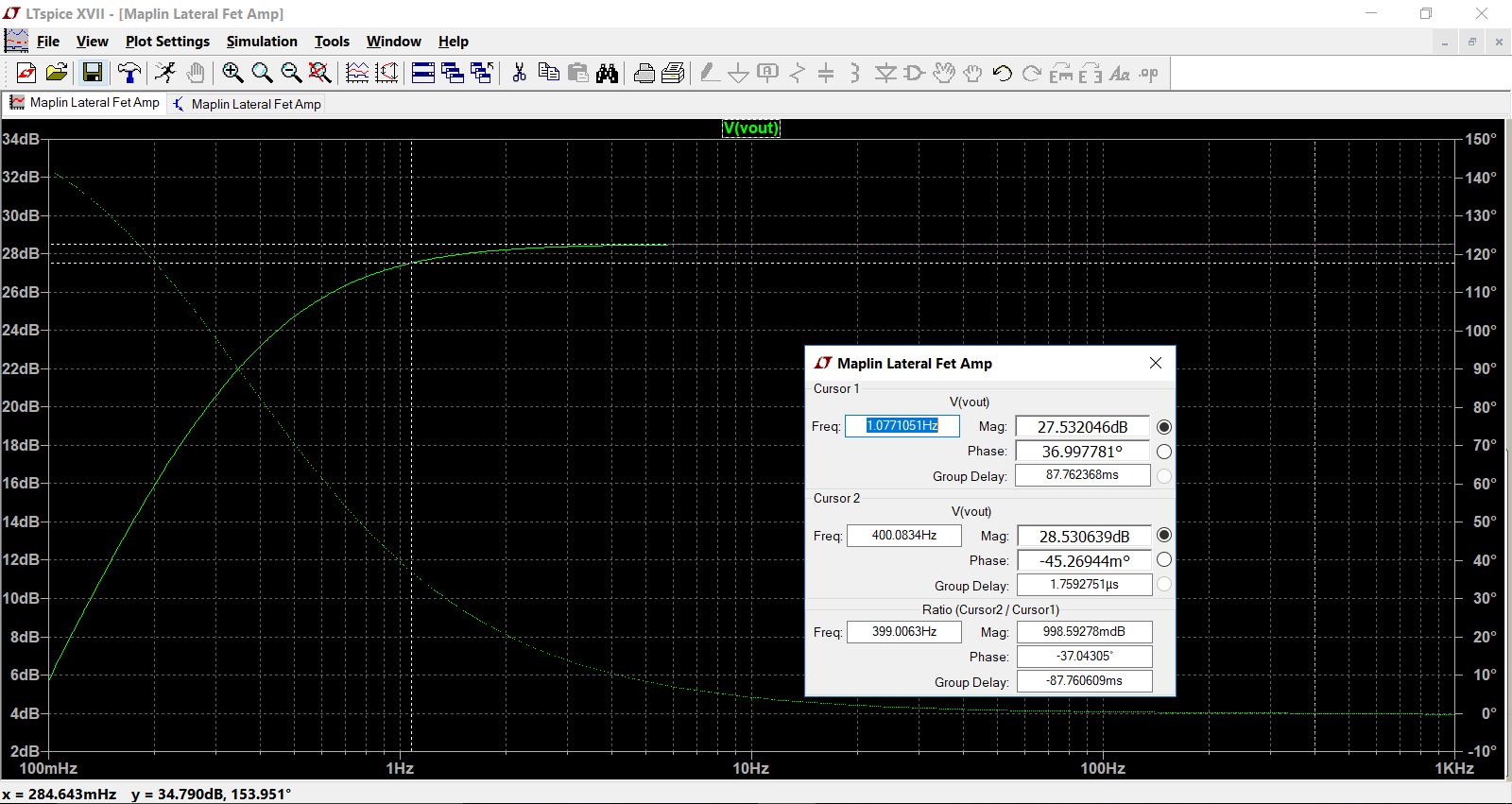

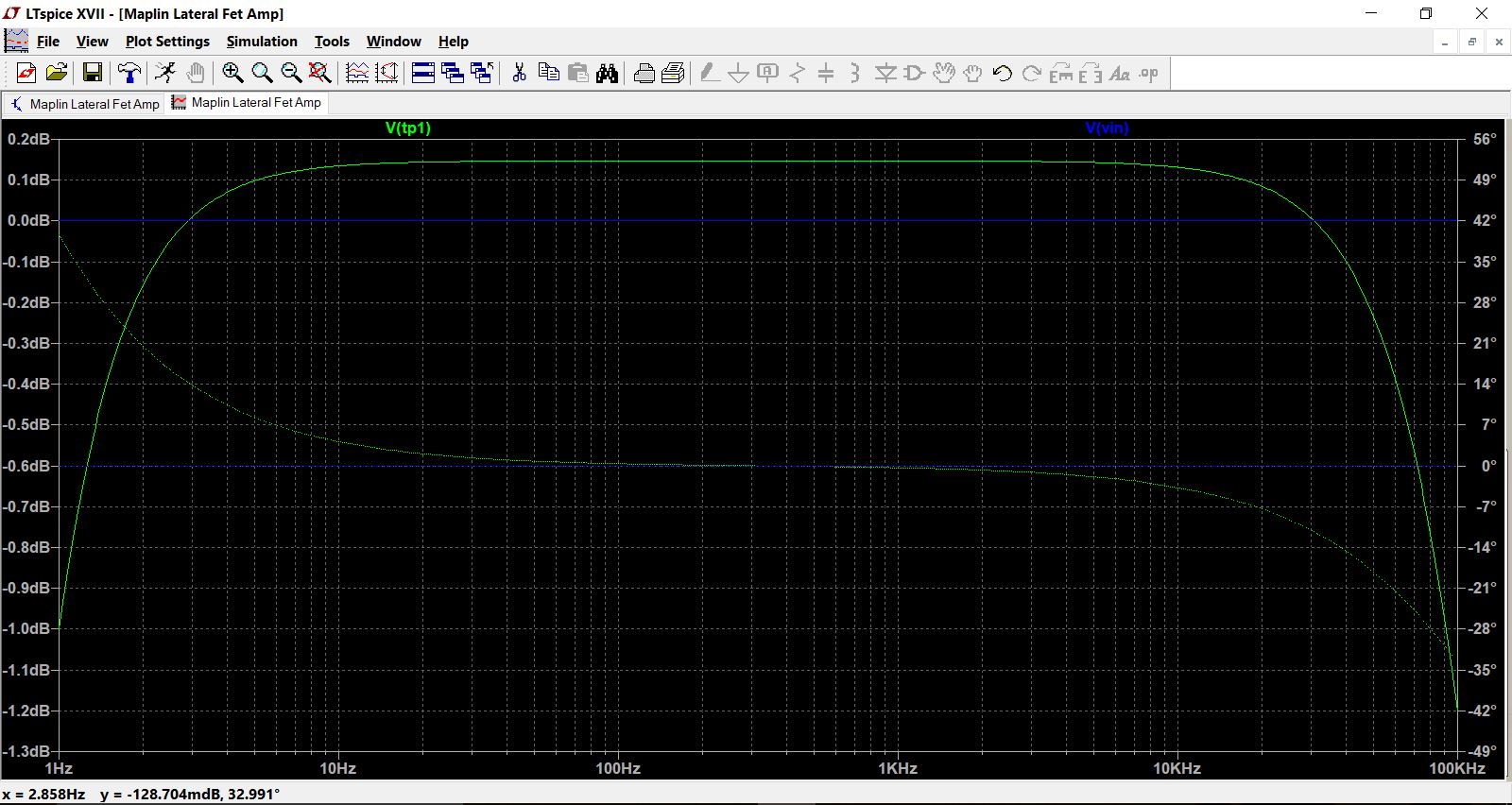

There should be no obvious phase shift introduced by the amp itself across the full audio band and beyond. This shows the phase shift at 50kHz which is minimal.
Don't include the input filter in this because that will of course add substantial phase shift at both HF and LF (LF due to both coupling cap and feedback return cap).
With and without input filter at 50kHz and an overall plot of phase response with filter. This is at 2.83 vrms output with levels for test normalised to overlay input and output.

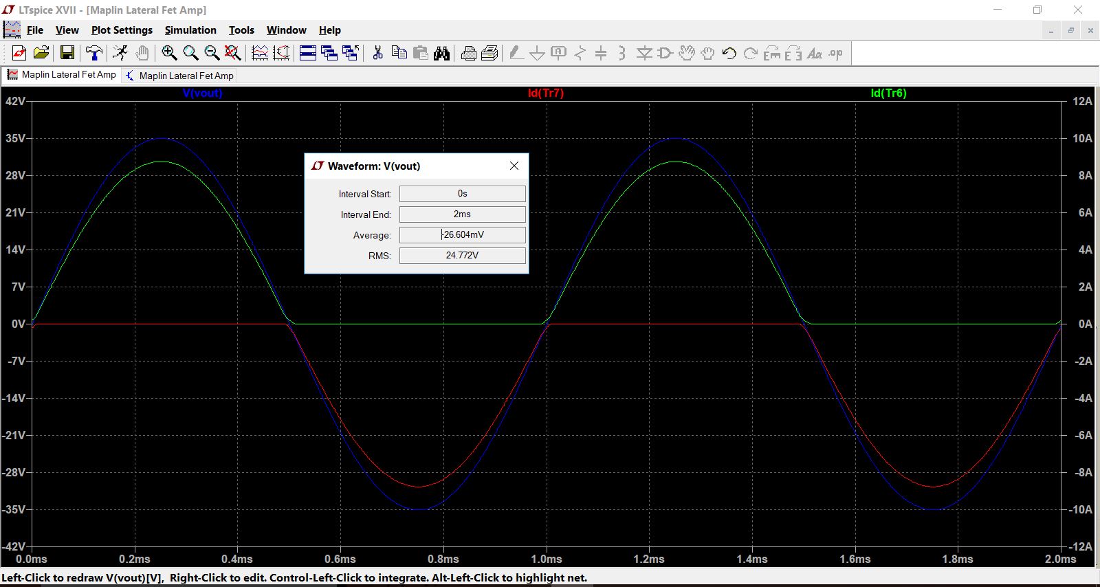

If you look at the original article, the spec was 100W@8R and 150W@4R max, presumably resistive load. Modern speakers are often 4R or less and seriously reactive with it.
As the design lacks anything except fuse protection, using a supply of +/-40V is safer. The Maplin design belongs to a time when Mosfets were being marketed as almost indestructible thanks to positive temperature coefficient and ignoring the peak die temperature

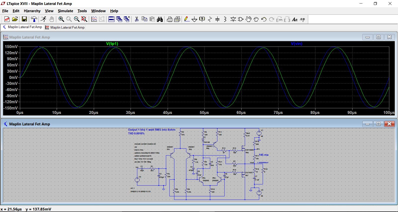

....The simulation also lacks an output inductor which would normally be required for guaranteed stability.
Thanks. That plot looks almost too perfect. The real circuit has different transistors and parasitics so this is not accurate but nothing there to set off alarm bells. The amp appears to have about 60dB max loop gain.Here is the open loop response although it doesn't tell much about the reality of hanging a reactive load on the end. A real world build would be quite different in absolute values. The simulation also lacks an output inductor which would normally be required for guaranteed stability.

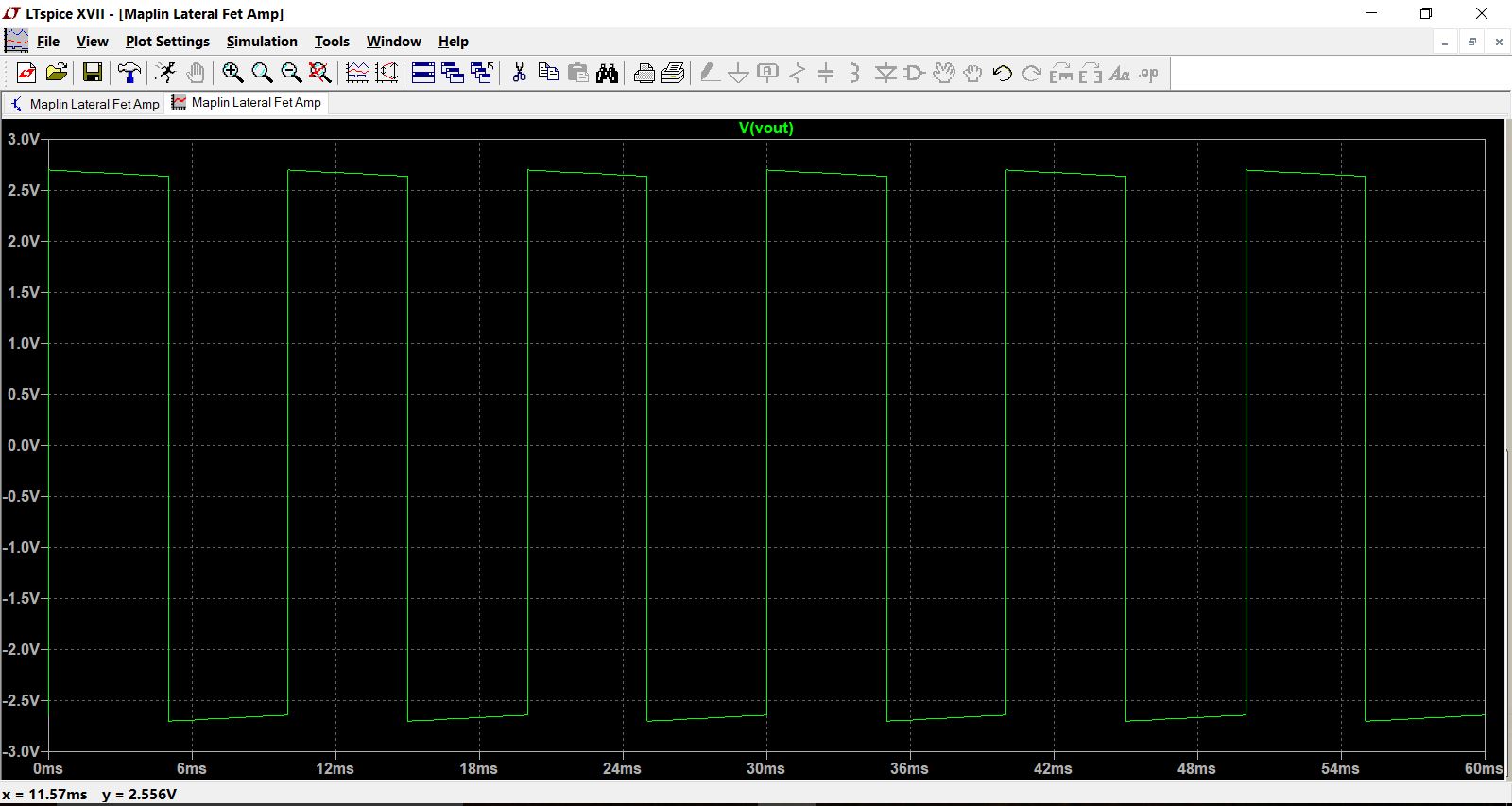

I should have been more clear. I meant the closed loop phase margin. Easy to simulate but tricky to measure on the bench.C5 & C6, The circuit as is, the output is slightly out of phase with the input but I didn't make a note of how much, probably somewhere around 15 - 20 degrees at a very rough guess.

I tend to agree. The FETS are only 7A devices and with worst case 100V across them they can only sustain 0.9A or a 10ms 3A pulse. At 50V then can do 2A continuous and 6A pulsed. But thats at 25C junction...the limits fall as the FET warms up.If you look at the original article, the spec was 100W@8R and 150W@4R max, presumably resistive load. Modern speakers are often 4R or less and seriously reactive with it.
Even driving an 8 ohm resistor at near 50V when FETs are cold will get very close to the safe operating area envelope. A loudspeaker's impedance varies and some drop to 2 ohms at times.
So I'd also be inclined to use a 30-0-30 transformer and 42V rails to be safer. Although that isn't exactly "safe". But your are more likely to get away with it. A big expense unfortunately. 42V rails should give 80W to 90W average into 8 ohms.
This shows 150 wrms (approx. 25vrms output voltage into 4 ohms) and it can be clearly seen that the FET's are over driven. Drain current is near 8.8A peak.
I wonder how the transconductance of the real FET's would hold up. In this sim there is 10 volts across gate/source to deliver that current.

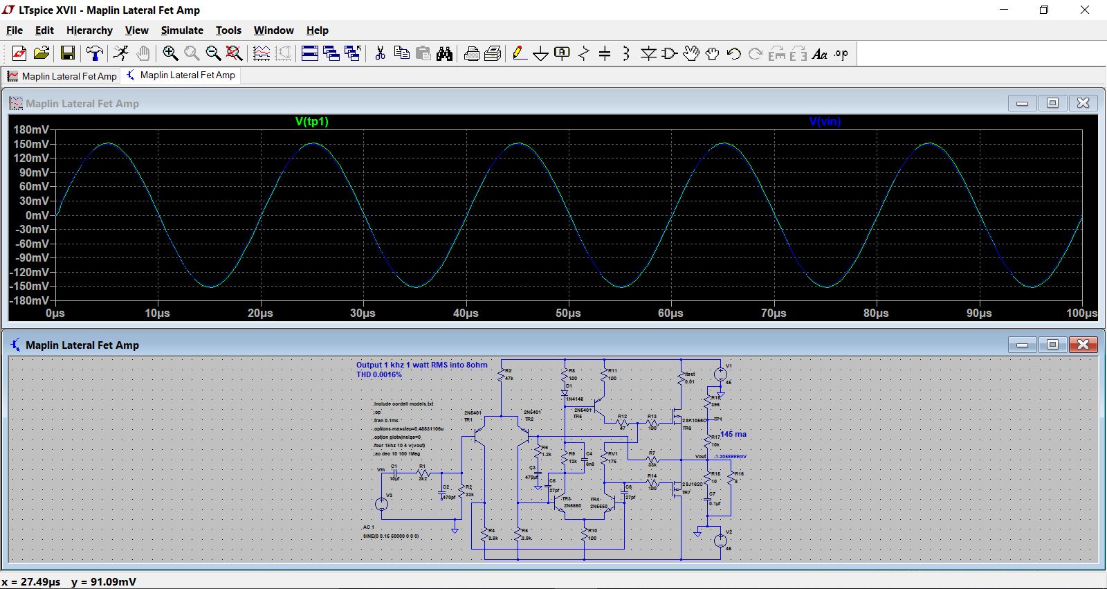

Thank you for the time you have put into doing these simulations, Very interesting to see how things work under different scenario's without risking a real unit.
Regarding the phase shift, I think at the time I was looking at a square wave in 10 to 100Hz region, so that would explain things, also at around 100hz and below the top and bottom of the square wave slope off, much like what you would expect to see when you turn a Bass Control down, I think the Maplin article mentions a roll off at around 100hz, so that's probably what I was seeing.
