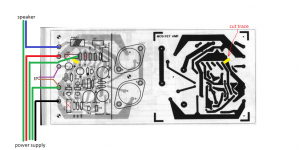

This is my most basic suggestion for improving the Maplin MOSFET amp stability. I've borrowed the PCB diagram from post #12. I've tried to keep it easy to do rather than perfect.
1. Remove C8 and C10. Relocate them underneath the board (not shown) between the drains of each MOSFET and the ground pins of C9/C11. Ideally use 1uF polypropylene.
2. Cut the ground trace as shown in yellow. Make a wide cut - 2mm or more. This separates the zobel network and local decoupling capacitor ground from the input signal ground. Attach a ground wire to where C8 was grounded (green wire).
3. Relocate feedback shunt resistor R6 (1k) so that it connects from C3 neg to where R2 connects to the input ground trace, underneath the PCB (not shown).
4. Wiring. Keep the wiring closely bound, perhaps use cable ties. Keep bends tight.
The purple and brown (shield) are the coax wires that go to the RCA connector on the chassis. Insulate the RCA ground from the chassis. Try to keep the coax signal wire (purple) a cm or more away from the nearby ground wire (green).
The three green ground wires going to the power supply should be soldered as close together at the wire connecting the supply caps to form a star ground. This star ground point can be earthed to the chassis and to mains earth.
Keep the wiring loom of red, black and three greens closely bound all the way to the supply caps.
Do not connect the speaker earth wires together at the speaker terminals. Only at the star point.
Reasons:
a) At the moment the high frequency noise that is decoupled by C8,C9,C10,C11 and the zobel network currents all flows right through the input ground trace and through a ground connection shared with the input ground. Very naughty.
b) The HF decouplers, C8,C10 are a long way (electrically) from the MOSFETs which they are meant to be decoupling. This also creates RF noise loops.
c) The feedback shunt resistor R6 has its ground reference far away from R2.
Note that if your PSU caps are reasonable and your psu wiring is thick and bound, you don't need C9,C11 at all - they don't really do much.
I have more suggestions but I'll let this digest first.

Another tip is to move the gate resistors closer to the actual mosfet gates.
by cutting the tracks near the gates, linking out the existing gate resistor position, and remounting the gate resistors directly under the mosfets on the track side.

Thank you for these suggestions, and actually not to difficult to do either, and I also have the advantage that my power supply and earth wires are already bound together with cable ties, and all Earth wires are connected back at the PSU Caps 0v, I would only need to include the speaker grounds within the loom and add another Ground wire, I also have a handy tag strip nearby to connect the power supply 0v to chassis earth, The RCA connectors are already isolated from the case, so not a problem there.

Either star grounding wasn't invented then or they struggled getting a layout.
I have done numerous pcb designs and learned lessons from them yet my latest project still had a grounding problem. So still learning after 37 years of electronic design.
I always return zobel ground to star ground too.
Good idea. The present arrangement leaves a couple of cms of antennas. An alternative solution for the perfectionist would be to cut the gate traces near the gates and solder SMT resistors across the gaps.

Just a quick question / observation, Relocating C8 & C10, Would it be best to connect directly to the Drain Pins of each MosFet, or just as close as possible? Either way I would probable need to use an Axial style cap.
Also, 100nf to 1uf, That's a big jump, but I'm no expert 🙂

The caps don’t need to be close to the drain pins. Anywhere between drain and ground will be a big improvement on where they are now.
I’m not convinced 100nF was a carefully considered choice in the first place. Nowadays, a 1uF polypropylene is a practical size but you can use smaller if it is easier or fits better. Axial is handy but rectangular/radial on its side is fine. You could also replace the two electrolytics with radials but it might be tricky to get the pin spacing the same.
More about parts choices soon...

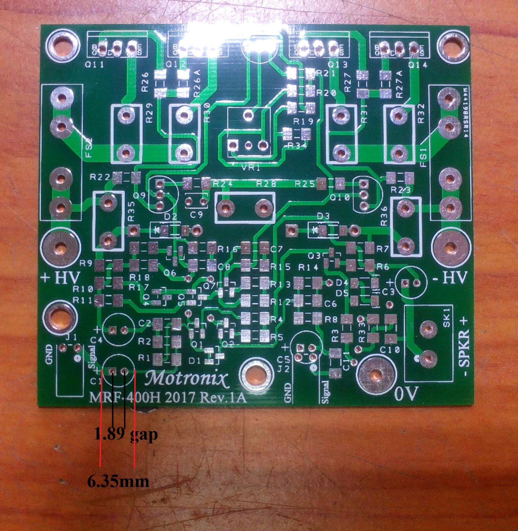

New Mosfet Amp design
i decided to design new mosfet amplifier with TO220 Mosfet transistors. the performance and stability much better then the old mosfet amplifier that i have. here is picture without parts if someone want to see it with parts let me know i will upload full assembly picture

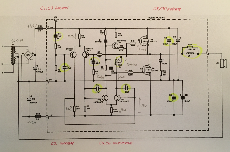

Some more suggestions regarding components.
You should do...
1. Nearly 40 years old...time to replace C1 and C3! I like Nichicon ES series.
2. C2 is rather small. A larger value, up to 470pF, would make a much better RF filter. Try WIMA FPK2 for a fit or a polystyrene.
3. New trimmers. What are your supply voltages? I estimate for +/-42V rails that the average current through RV1 will be about 5mA. The 2SK133 and 2SJ48 datasheets suggest you don't need more than 3V across RV1. So worst case, 600 ohm trimmers; but you could very likely get away with 500 ohm (standard) to give yourself more adjustment range. The gate thresholds obviously vary widely among devices.
4. R13 & R14 moving closer to the gate pins has already been suggested. For cosmetic reasons you could back-fill the original slots with small value resistors rather than wire links. Or use 47-ohm + 47 ohm or whatever.
You might do...(uncertain audible benefit for this circuit)...
5. C5 & C6 might need increasing to improve the phase margin. I'm waiting to hear from Mooly to confirm this.
6. C5 & C6 could use a decent dielectric like polystyrene or polypropylene.
7. Optionally, relocate R16/L1 to the speaker terminal at the chassis. Mount it with axis vertical.
