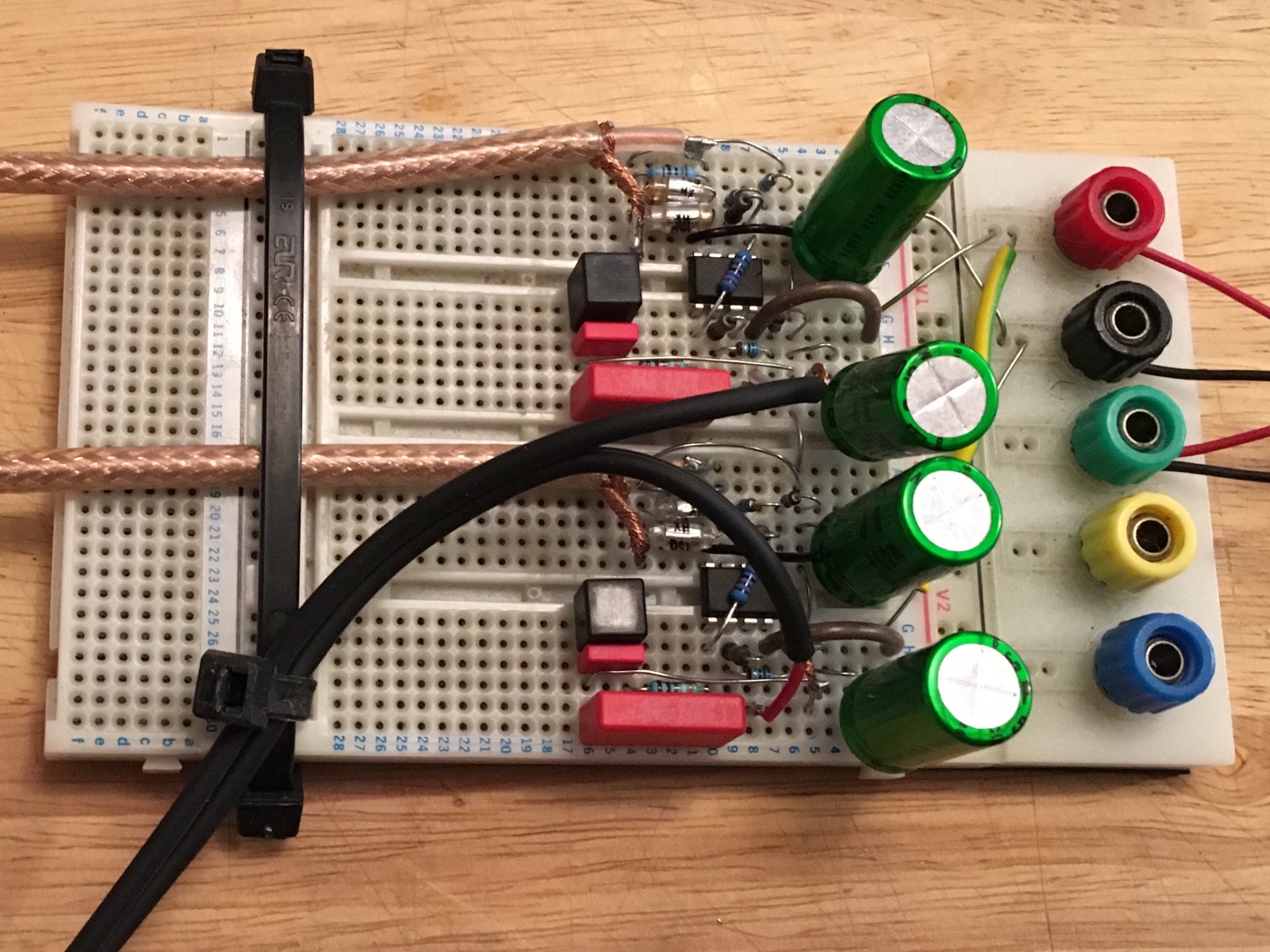

Update: I’ve breadboarded the phono amp and it works (by which I mean no smoke). I started the turntable and put on the first LP on my stack: Rumours.
All seemed well until I lowered the needle and then the platter gradually slowed down. By the time the music began it was already half speed and quickly deteriorated into a groaning dirge.

Have you replaced the drive belt yet?
Forgot to mention, When I took my original drive belt off, it had taken on the shape of the motor and platter pulleys, sort of a V shape, I replaced it with one of the new white rubber types.
I had removed the belt before storing it and the belt looks ok. I haven't had time to diagnose whether it is the belt or the motor/pulley. The spindle seems ok because, with belt removed, the glass platter will spin for a very long time.
Strange, I wonder if the motor has suffered from attic storage, huge temp and humidity swings, unless you have a proper insulated loft room, not like my dark dank loft !! Have you tried just letting the motor run with no load for a while, or can you stop it easily with your finger?
So, I suppose proper evaluation of the RIAA board will need to wait until you can get the Rega up and running.
It turns out the plastic pulley is loose on the motor spindle. I pulled it right off with little force. A drop of Superglue should fix it.
