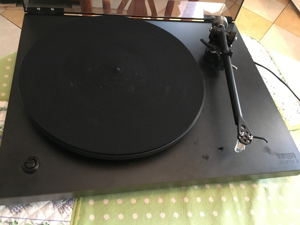

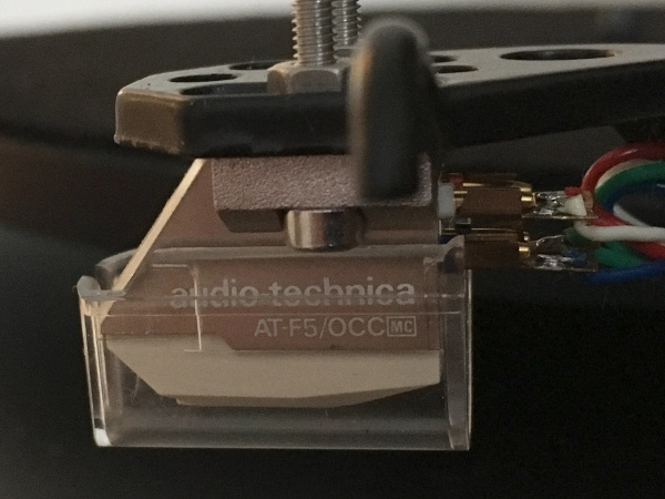

Here it is! It must have been in the loft for 20+ years. A little oil spilt but looks fine. I'll give it a clean. Needs a drop of sewing machine oil. It has an Audio Technica moving coil cartridge.
Nice, I notice it doesn't have the R200 arm, so you probably wont have any issues with the Anti Skate.
Being a MC, will you still need a transformer before the phono stage, or don't they use them these days? I'm so out of the loop 🙂

I'll be using the Ortofon VMS20E MKII cartridge, it always had a very smooth sound to me, It's going to be some time before I can get to use the phono stage properly, first I have to repair the anti skate belt on the Rega, if I don't wreck the arm in the process, and then I need to find a suitable surface to place it, which will probably be wall mounted as we have wooden floors.
Record players are SO nostalgic! I don't have one anymore but every time I see pictures like that I want one again....................or do I.......mmmmmHere it is! It must have been in the loft for 20+ years. A little oil spilt but looks fine. I'll give it a clean. Needs a drop of sewing machine oil. It has an Audio Technica moving coil cartridge.

Of course you do..... especially if you still have a record collection, It wasn't until I was going though my own collection I realised how many great albums there were and how many tracks I hadn't heard or even thought about for years, great to see the price tags on them as well, WHS £4.95 🙂
It was that, that really got this whole thing started.
I have a couple of Ortofon T-5s but I’m thinking about avoiding them by boosting the opamp gains. However, I need to figure out what Z to load the cartridge with...Being a MC, will you still need a transformer before the phono stage, or don't they use them these days? I'm so out of the loop 🙂
