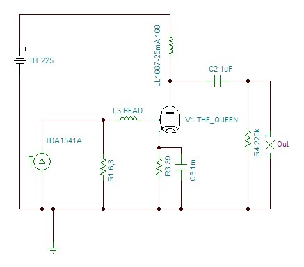

For 'standard' 2vRMS output, assuming CCS load D3A will get you 98% of the way there with 18R I/V.
4mAAC pp x 18 ohm = 0.072vpp
0.072vpp x 77 = 5.4vpp
(5.4vpp/2) x 0.707 = 1.909vRMS
If you were wanting to strictly stick to 25mVDC offset value, I/V = 12R will have you at -24mVDC with -2mADC from the 1541A, D3A would have you with 1.3vRMS output.. depending on your overall gain structure and requirements, this could be more than enough. (or not).
Out of interest, Zanden 5000 using half 6922 and Vout 1.6vRMS
(1.6vRMS/0.707)x2 = 4.53vpp
4.53vpp / mu 33 = 0.137vpp
137mvpp /4mApp has I/V =~34R.

Hi Shane, Andrea,
You mean a design with just one tube ?
Yes...
This is a simple single tube stage compliant with +/- 25 mA TDA voltage swing
If yes, the Queen is fat ! Remenber me Lampizatruc ! Did he try also with 845 ?🤐... I'm going to put a wire into a bottle of Champagne if the size matter !
Thank you Andrea.
Wow : as If my understanding is correct : i/v is maid by a 6.8 ohms ? Not saw much often a so low value.... nice.... with a LL transformer, seems the resistor sould be at least a Rohpoint.
