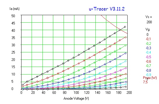

The Queen is not Elizabeth II, but a real triode.
The average characteristics are:
Amplification factor: 250 to 300
Transconductance: 50000 to 65000 microohms
Max plate voltage: 270V
Plate current: 33mA
Plate dissipation: 7.5W
Spice model:

Attached you can find the the plot from the curve tracer.
Let me give a try, the I'll share all.
Andrea
Andrea,
I know curves don't tell the whole story… but given that the increments are on order of 100mV - which is directly applicable to DAC output stage (1541A specifically), assume horizontal load line (as recommended by Broskie in his article that you linked to) - this tube does not seem very linear in its transfer function at all.
Also, is the scaling correct ?.. thats a massive change in plate voltage for a shift in such small grid voltage with plate current being held as a constant.
What is it that I am missing?
Shane

Shane,
this tube works usually biased with the grid around 0V, so the grid go positive during the signal swinging. In the circuit I posted the signal applied to the grid swings from -50 mV to +50 mV. Since the triode has a very high transconductance, the voltage swing to drive the tube to get great variation in plate current is very low, so the tube works anyway in its linear region (see the plot from 0V to -0.3V).
So the massive change in plate voltage for a shift in such small grid voltage is due to its high transconductance. If you set constant plate current, for small change in grid voltage you get great change in plate voltage.
Andrea

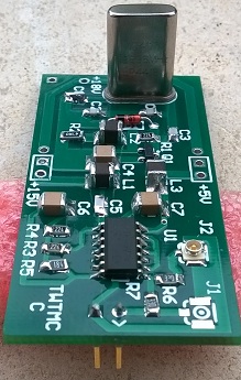

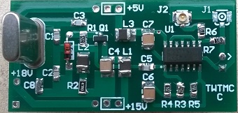

Eldam,
my clock board is almost ready, so I'll open a thread soon.
If someone will be interested I could supply the PCB and the crystal.
This oscillator works with fundamental mode crystal, so the maximum frequency allowed is 25-30 MHz (it will work from 5 to 25-30 MHz simply replacing a couple of caps).
You can see a preview in the attached images.

Great, in my case it will be just the I2S to PCM board with no FIFO as it exists some USB to I2S devices with isolator chip and isolated layout...
But does the WS and Blck with the I2S to PCM but without FIFO are reclocked as its MCLK is slaved ? That point is not clear for me. My understanding : it is not without the FIFO and if you use a third party USB to I2S : the fs should stay 32 or 64 fs (manual of I2S to PCM) and the result would be great only if this first board of the chain is also slaved by your MCLK ? Right ? Because ifnthere is a drift of the WS and Data in relation to the MCLK which is stable : we have always a jitter problem (ws & data timing given by the source board !)
Does your board allow to slave 3 devices : dac chip + USB to PCM + I2S to PCM with 3 uf.l connectors ? dac chip is slaved with the two pins (stacking), I see one uf.l, but is it possible to add one just near the first (no drift with such conf : more thanvone uf.l ?). On J1 : I can't understand if the empty uf.l trace give the same frequency than the populated uf.l on your photograph ?
Well if the xo is 6.4 max, the max sampling allowed by the I2S to PCM would be 48 hz ! (128 fs minimum for this device)
Good news given by Ben Mah 🙂 : uf.l are present for the input on the I2S to PCM board also.
