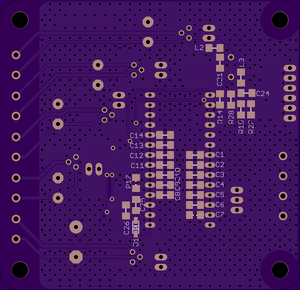

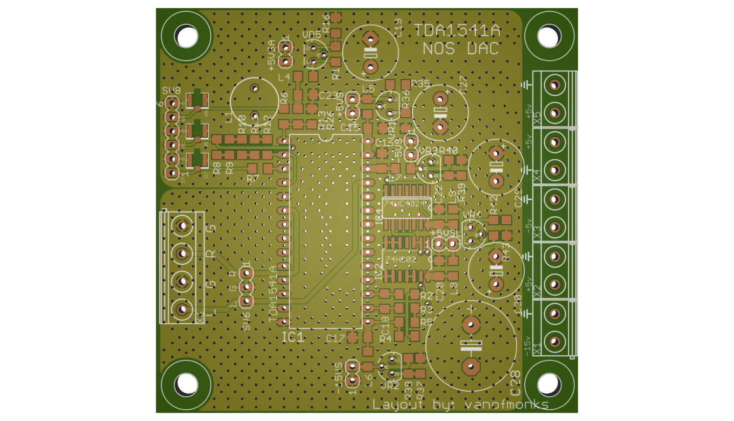

Whoa, whoa ... 😱

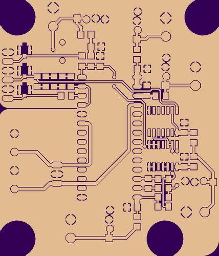

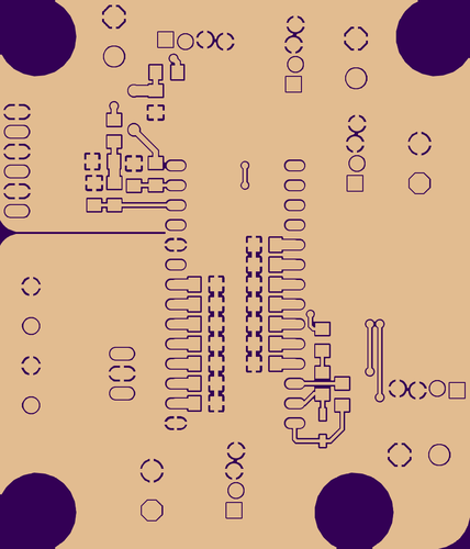

Vanofmonks has something that may be good-to-go, someone just needs to test it and then we can tweak ... 😕
One thing that's critical is not breaking the ground plane with the outputs. Vanofmonks can you remove the output traces? Instead we could just use wires to go from the output pins as well as two ground wires coming from the ground pin to the output header. Or solder pin headers to the output pins and ground pin and copy the spacing/position on your output board and plug it straight in [3-d]) 😀
We could be 80% there already ... 😉

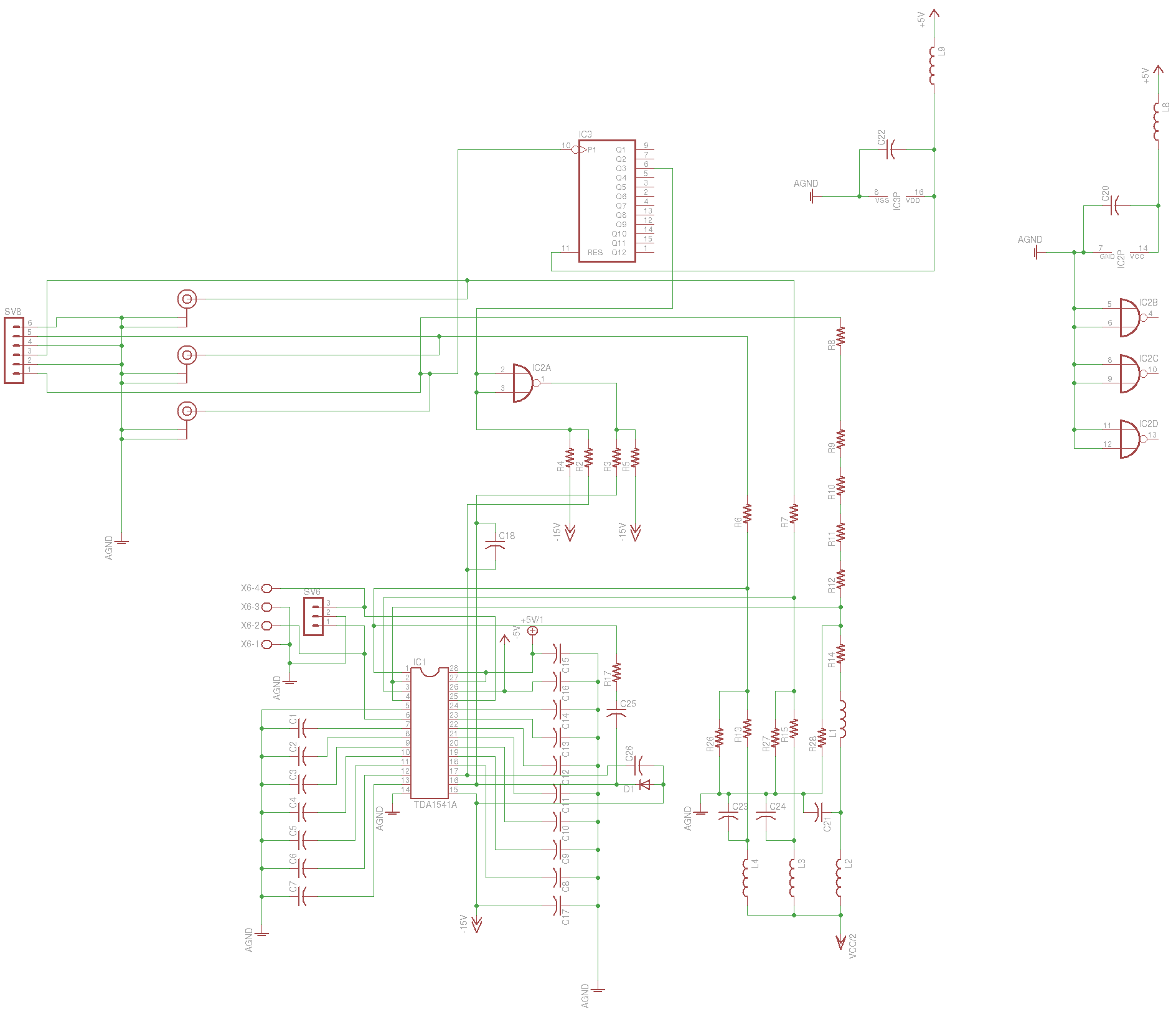

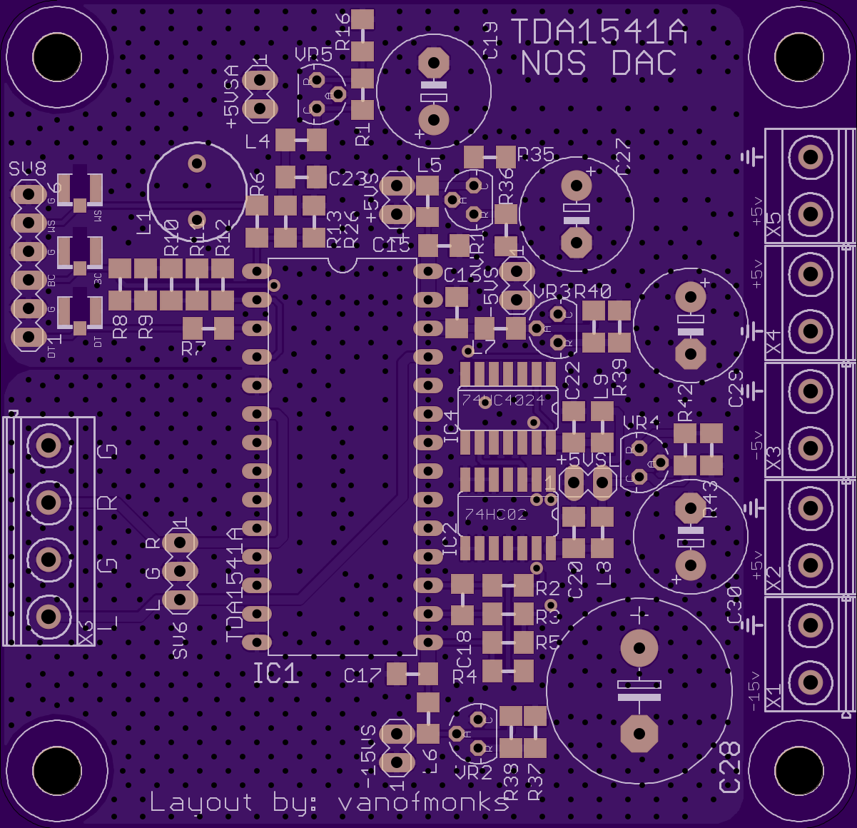

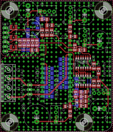

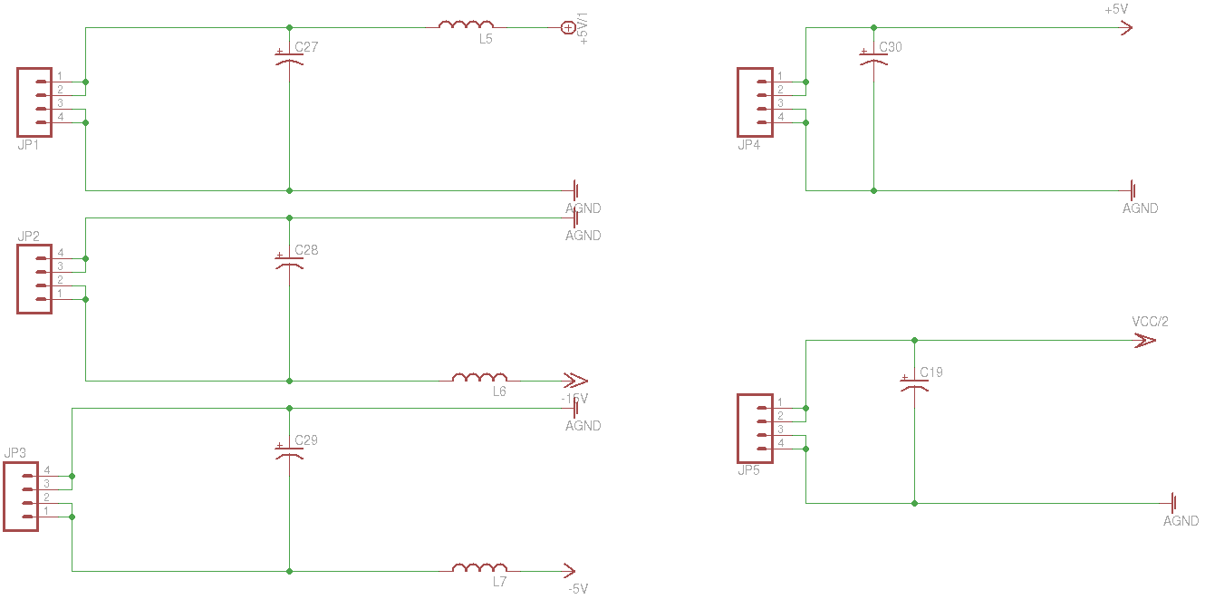

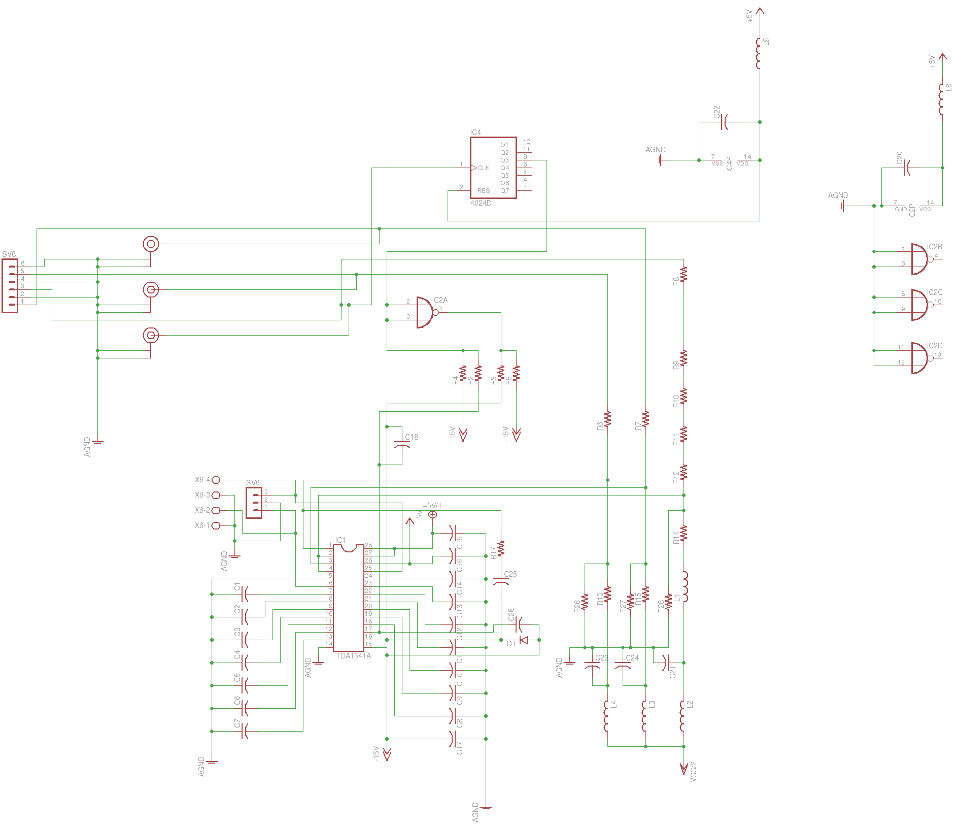

Vanofmonks v8 sch and v10 PCB:
I sent Thorsten v8 sch/v10 PCB of Vanofmonks a while ago hoping it would get 'T approved' but ...
He said:
I have seen worse. Better too.
And when prodded a bit more:
There are a number of mistakes or sub-ideal choices in the actual schematic, more in the PCB Layout.
The connectors are wrong, no re-clocking on board. I cannot see the point. Pretty much 90% of what i suggested is being ignored.
But when asked for particular suggestions he didn't give any response (understandably, he's a busy guy and has given his hints).
Vanofmonks, what changes have you made since v8 sch and v10 PCB?
Well, it's a place to start ... 😱

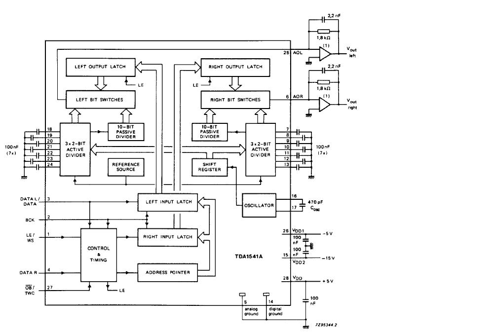

Again, here are T's hints:
http://www.diyaudio.com/forums/digi...any-good-tda1541a-dac-kit-36.html#post2887893
Can someone with a bit of time make a summary and we'll get started!
View attachment tda 1541A.pdf

As a quick reply, I left the reclocker off the board because I figured between Ian's FIFO and the amanaro reclocker options from acko that it was covered. There does not look to be a big difference between the two versions, but one difference is I changed the smd components to have a silkscreen line showing orientation. Also looks like I changed the ground plane.

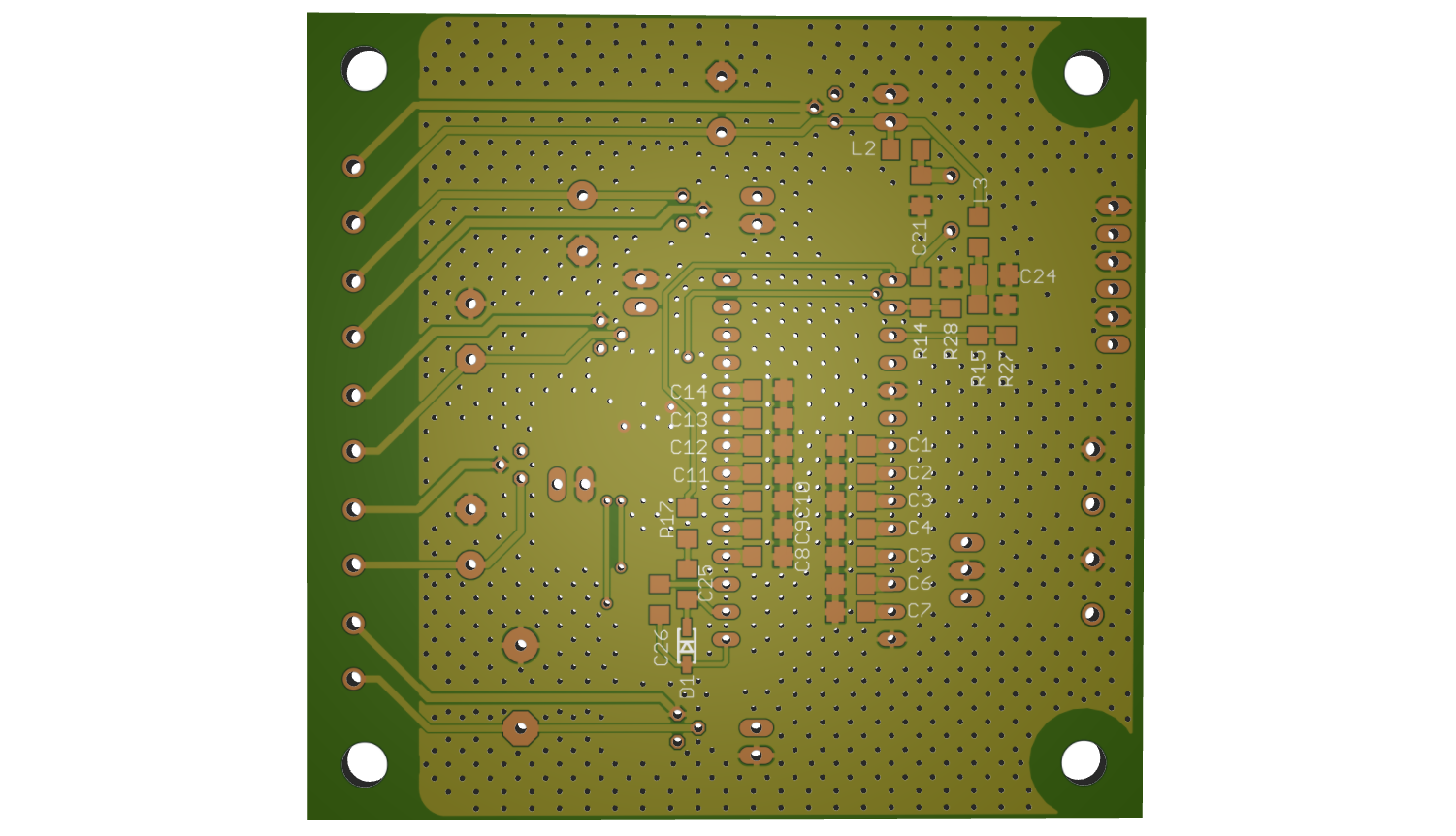

Maybe Studiostevus can help us as he tried already a credit card format with some of the hints of ECDesigns ? I'm sure specialist of RF will add some comments if the design is shared....beautifull discusions about PCBs and RF on the "I2S cable" thread ! (2 to 4 layers as a hifi standard but no free tools for drawing such pcbs for the enthusiasts !)
Vanofonk, nice compact design you are able to do !
I remember a guy here OSHifi fellow or something like that who play without the découplings caps but the two bigger first with 1 to 2 uF.*
For the LDOregs you have also some ultra low noise nice Micrel 205 (SOT 25) or Texas Instrument (SOT 25) this time without the need of near tantalum for the oscilations. You save space with it : TI LP5907 Ultra-Low Noise LDO Regulator | Mouser : just 2 X7R caps! no need of a specific shunt caps to gnd for low noise like the Micrel, but the Micrel is "less" noisy" !
i have got the good little Subbu DAC from what I learn how small is beautifull !

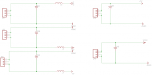

I found these 2.5 mm pads spacing polymer cap for the main 5V;-5V; -15V could work very well : 100 uf LF serie United Chemicon (ASAxxxx réf : Mouser). Maybe a 470 SEPC 16 V for the famous negative -15V but here spacings between leads is 5 mm.
SMD 100 uH coil just before the ldo regs or near the PS inputs connectors for PS boards ?
Is there a 4 pads something for a smd crystal near the TDA 1541 (if MCLK used to slave something ?) : some goods crystal at FOX... I just rewrite gentle advises here because not a specialist... Maybe enough space to putt beneath the board with cnd directly on the contigous Gnd and the clock line to the clock pad of the TDA1541 ?
Do you use the silmutaneous mode à la Pedja for the I2S input ?
For the I/V and buffer stage : is a stacked pcb design with an another board with short vertical connection to the core board a good idea for enthusiasts like us (idea of a 3D design by T. Loesch to make short when just two layers pcbs with contigous ground plane) ?
Just 2 cents, i know it's easier to write than draw !

For the damned - 15V : maybe one of the less noisy avaliable smd chip here (but expensive but already soldered: 20 USD) at ackoDAC :

Don't know if a negative one is possible ?

I said eurocard, not bank card. That's about 4x a bank card.
Yes I offer to share, but under the condition that some knowledgeable people improve what my novice skills could not do, so get to learn something here as well. Have not seen a confirmation of that yet.
Both design and layout are surely not optimal. Far from AMR that's for sure.
Btw, I used to have Oliver's first board, and my design is likely better that that, but looking at his latest Red Baron, I think they are quite close (mine having the power section on the board)... Why don't you guys use that?
I kind of agree - Its probably better than a ground up build based on archived thoughts.
Still think that if you had enough people to approach Pedja to buy his discontinued AYA II DAC board you'd be (miles) in front. Of course you'd need to approach it with the right intentions (the guy has been burnt by people copying his designs and then going commercial, before) and you'd likely only get one chance with the approach, so perhaps if you were to decide to try, make it count, ask with conditions like min 100pcs, NO commercial use.. I'm still big on the charity donation thing. Whats the difference if it costs you $100 instead of $40?.. you'll soon see how much time it takes to build such a thing properly and then $60 to have the better design in the bag, is no big deal.

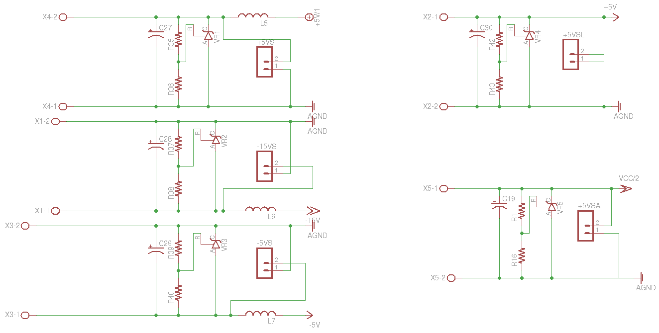

Get the gerber, use the PS which is onboard (the common mode RC filtering and discrete shunts with final filters right at the 1541A pins) and 1541A section, delete the 2mA offset on the output, modify the input section for jumpable I2S or PCM input, bring the outputs out directly from the chip so that you can use what you like and be done with it - get them printed up, size would be approx 120mm x180mm.
Feed it with anything from simple WaveIO via I2S (or similar) through to full Ian FIFO set up via PCM (simultaneous)

- more compact
- decoupling are nearer to the dac chip
- supplying and regs (which is crucial) are close with low noise regulation
And not sure than the output stage of RedBaron deserve a fly !

I don't have any drawings as it's built p2p, but have a look at broskie's page, it's on there as well somewhere. The key is that you don't eliminate the -2mA idle current, but you take advantage of it (no need for a resistor to create the tube's idle current, if I recall correctly). It's been a while since I've done that
