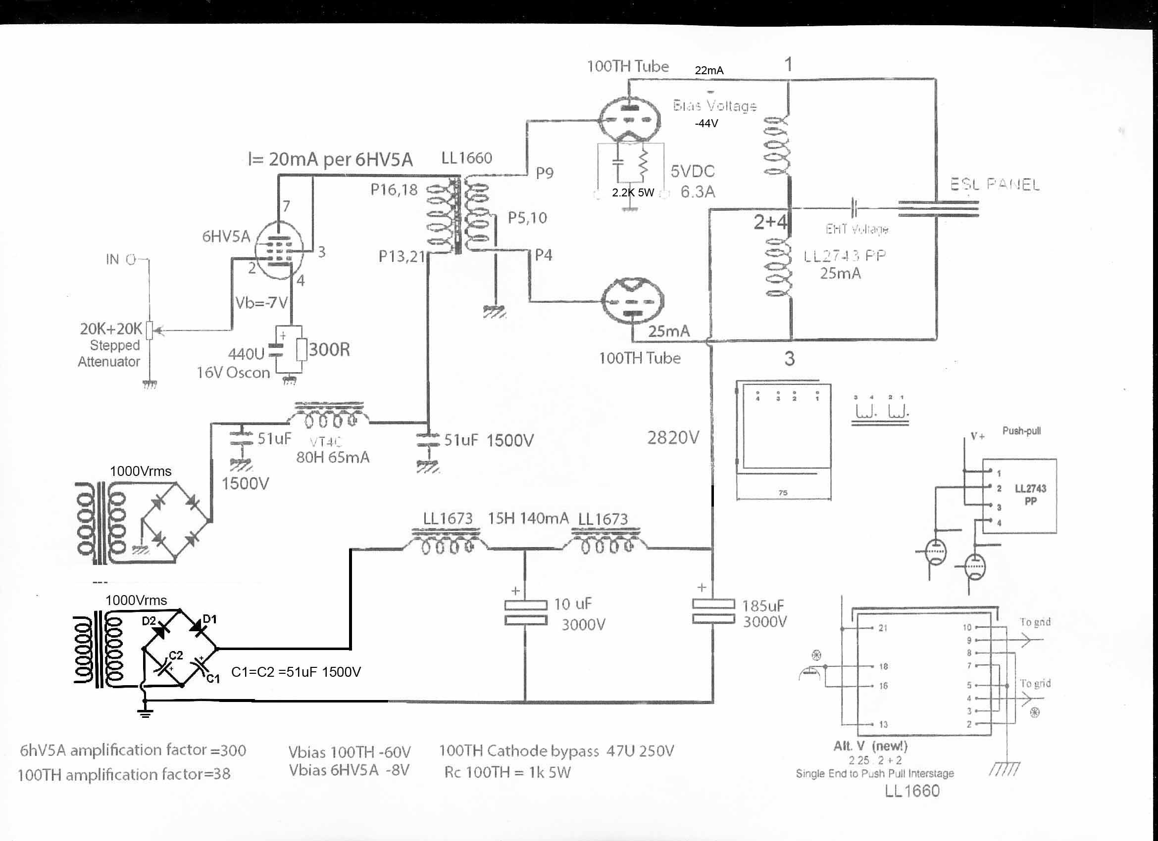

Why solid state? Tubes and direct drive ESL is a perfect match.
My Beveridge is playing just awsome and you can see the schematics above nr:73
The tubes are dirt cheep and there is a lot of them... so what are you waiting for guys and girls?
The schematics shown at post #73 contains some erratics :
Both bases of differential amp Q6 and Q7 are tied together, in this way they will output nothing.
Q4 and Q5 are fully shorted at all pins.
There's also the large capacitance across the 'transducer'. That can't be right.
It seems this is a schematic derived from a board, and it's very hard to do that right.

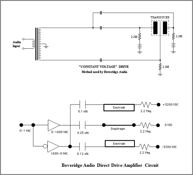

It does look odd , but actually is correct.
The transformer and direct-drive version of the Beveridge circuit topology are shown in attached pic.
This drive method enables you to get twice the voltage differential between the diaphragm and stators for a given amplifier output capability, so 2x the SPL. Essentially this is a form of amplifier bridging for ESLs. The downside is that it only works with highly conductive diaphragms.
It is very similar in concept to the Final “inverted” circuit arrangement.
More details and comparisons between the two methods posted here:
Beveridge vs Final ESL Configuration

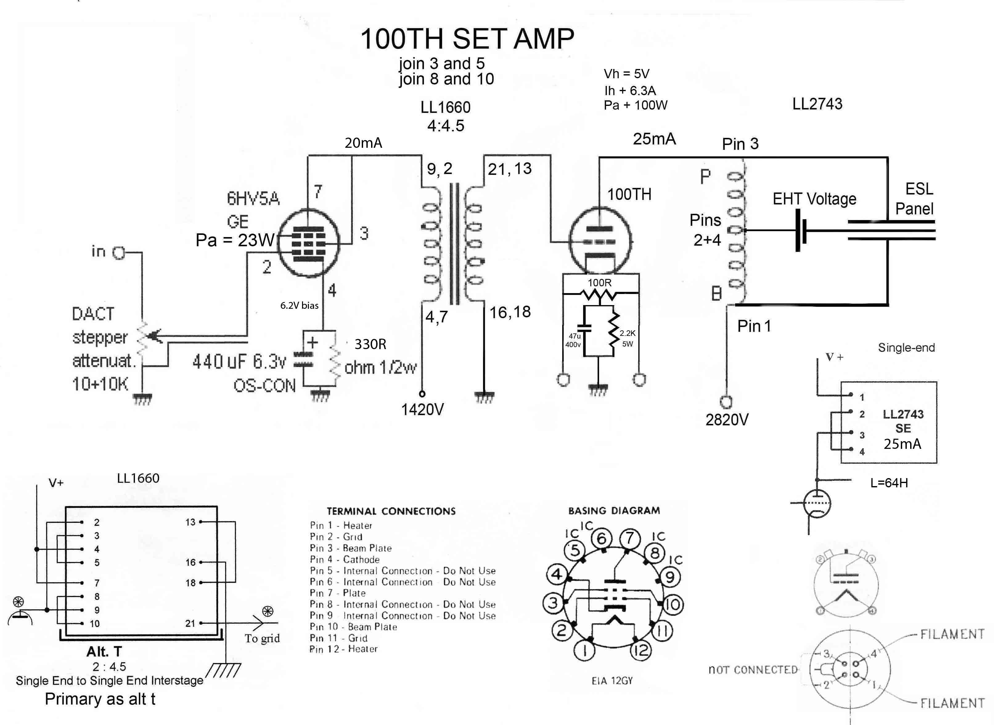

Attached are a couple of Direct Drive ESL schematics. The are both in the one amp with the right channel being SET and the left PP.
The PP gives way too much voltage and sparks my panels even with a diaphragm stator spacing of 3mm (with a bias voltage of 6000Vdc). The SET gives more than enough volume and my tube supply will last twice as long.
Some designers use parallel tubes to drive the 100TH as it takes grid current so I fitted 4 6HV5A sockets. I noticed from the LL1660 schematic that it can be wired as a 2:1 stepdown so I wired it that way and did not need paralled 6HV5A's.
The LL1660 interstages can be wired for either PP or SET but not the Anode chokes. The 25mA SET choke will work in PP but the PP choke with no air gap will saturate with the bias current.
The loudspeaker cables and the ESL panels are connected to the B+ voltage of 2880Vdc so the amp is best built as monoblocks located in the speaker enclosure.
These amp play every day and are stable.
A word of caution on the Eimac 100th tubes. I have ten faulty 100th tubes and just one good one. If an ebay seller does not accept returns do not buy them. You also need a means to check the Anode circuit as several of mine seem to have low vacuum glow blue and take too much current. A shorted tube will burn out the Anode chokes.
next step will be Amorphous core LL1660's and direct bias.
I use the amp as full range with no crossover or shelving equaliser. The SET works fine with plenty of volume so will wire the second channel as SET also

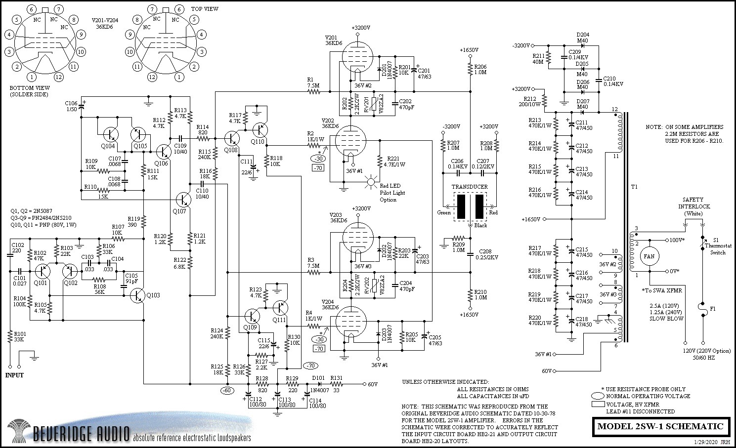

Here is the schematic I used when rebuilding my Beveridge amps. I can verify it is accurate, at least for my pieces ":^)
(there's actually still 1 error in the drawing, but the error also exists in the actual product - apparently a layout problem that wasn't solved yet, at least in mine)
I have HV scope probes and have measured the output; at clipping this puts out push-pull 2,500 Volts peak to peak with no load.
