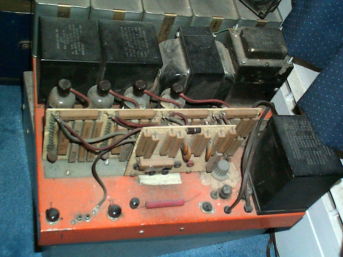

Checking out some old photos.... here's my direct drive amp. B+ of 2400v. Lethal. That loose resistor at bottom is for shorting-out any residual voltage when working on the amp.

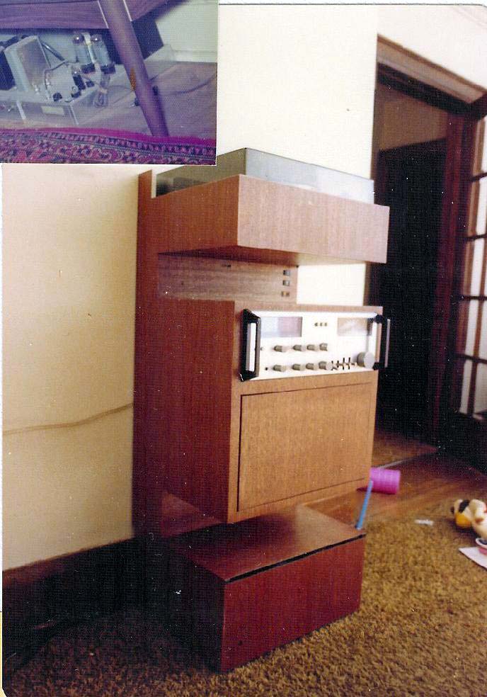

The other picture is a component cabinet I made in 1978. On the top was a straight-line tracking turntable on a seismic platform and well-sealed from room acoustics.
The box at the bottom was for the amp. No kidding. The little black line at the top of that box is the air vent. The amp provided a low and adjustable voltage for a quiet muffin fan. The jack for the fan is near the grey knob that adjusts the HV panel bias.
Worked great for decades, first driving some panels I made from surplus Dayton-Wright cells* and then driving genuine DW speakers. Sold it maybe 15 yrs ago.
The general mirror-image circuit configuration followed Sanders. But the large array of brown power resistors you see is really what the amp was driving; the panels just sort of along for the ride. Some effort making the Sanders circuit stable and that was the solution.
I think transformers are much more of a weak-link for driving ESLs than is ordinarily supposed (because they look so innocent on circuit diagrams). I think you'd be dismayed if it were possible to chart the signal that comes out of an ESL transformer to drive a panel. But transformers are actually much better elements for coupling and hum-avoidance elsewhere in a circuit than is supposed too.

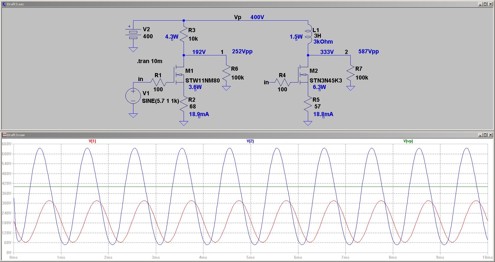

efficiency betters alot, as the voltage swing using a inductor as anode load can nearly be doubled.
Seen the other way ... one could reduce the supply rail voltage to nearly 1/2
I don't know enough to credibly doubt your post.
But, I dimly recall getting an output like 750 v rms which comes pretty close to all you can get from a 2400 v rail. And the amp was flat and clean from very low to very high.
I should mention that the amp did make loud music but did not drive the speakers as loud as lovers of Mahler symphonies might like on party night. But then again, the Dayton-Wright cells are piggish about needing drive voltage.
And the B+ in a direct connection adds to the HV bias (which, of course, has to be minus).

regarding R- versus L-loading see attached pic.
It prooves that the anode voltage with an inductie anode load can easily swing beyond the supply voltage.
Both MOSFETs are set to the same idle current bias points and receive the same input signal.

As the amp needs to supply for the required amount of load voltage and current You can easily calculate the ´demand´ of the load.
The formula reads Ip = (Cload + Cx) x pi x f x Vpp with Ip: peak load current, Cload: capacitance of the connected ESL, Cx: other capacitaces from cabling etc, pi: 3.14, f: frequency of the driven signal Vpp: peak-to-peak signal voltage
Larger non-segmented sheet metal panels (curved, hybrid) show capacitance values around 1nF and can take up to ~6kVpp
Segmented wire stators can be as low as 100pF but typically demand more voltage, say up to 10kVpp.
Cx can be chosen to 50-100pF.
f is chosen 20kHz for full power bandwidth.
For the non-segmented ESL the chosen values result in Ip~420mA peak.
Powered by a bridged amplifier the supply voltage of the amp needs to be at least a bit higher than 3kV, giving 1.26kW
For the segmented ESL the chosen values result in ~130mA peak.
For 6kVpp it´d be ~75mA peak, giving 1.3kW, resp. 450W.
The amp needs to supply for huge amounts of peak power.
Now the efficiency depends on the circuit topology and bias class in first place.
A single ended amp where the anode load is a resistor needs class-A biasing and achieves a maximum efficiency of only 12.5%
A single ended amp where the anode load is a inductor or a constant current source needs class-A biasing and achieves a maximum efficiency of 25%
A single ended amp where the anode load is a inversly modulated constant current source (SEPP) needs class-A biasing and achieves a maximum efficiency of 50%.
The same efficiency as a true pushpull output (complementary or quasi-complementary doesn´t mater) stage achieves when biased in class-A.
That is without taking the preamplifying stages of the amps and the power supplies into account.
A pushpull stage biased in class-B (or AB, however one defines) can typically achieve ~70%, power supply included.
class-D switching stages while theoretically beeing able to achieve even higher efficiencies will be HF transmitters and won´t comply with emv regulations.
So, practically its almost impossible to drive a non-segmented ESL actively and achieve a full power bandwidth of 20kHz.
