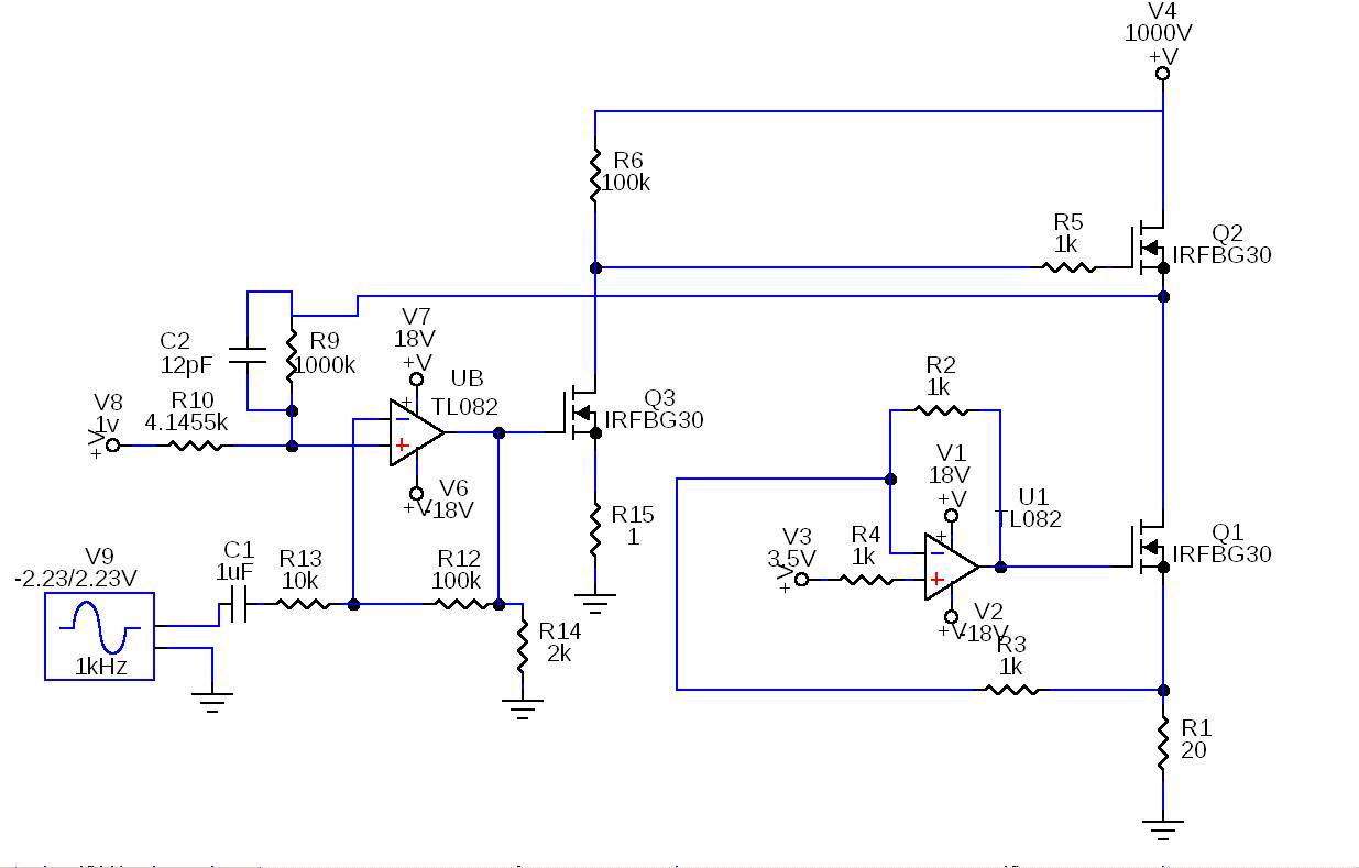

Hi there!! 🙂
I have been really busy lately, but in the meantime I would like to share my latest DD design I did some time earlier this year in Circuit maker.
Of course like everything else I haven't the time to test it yet.
I do like this design as it features a voltage settable bias current, it is only for a 1kv supply but a pair of them this will provide up to 2kv p-p.
Once I test this I will work on stacking the FET's for a higher supply voltage and swing.
So, I post this here should anyone want to give it a go.
The sim's work Great!!
This version is just a single amp itself without a phase splitter.
The output is taking from the middle of the two FET's.
This is a working simulation rough draft so I don't have any sim data available at this time around.
I will post the CKT file and sim data if I can find it, else I will have to re draw it to produce them.
No biggy really, just extremely busy working on other stuff that must be done First.
It does not require any floating supplies like the Neil S. Mckean ESL amplifier found at TAC or high power resistors the top FET takes care of that..
Cheers !!
jer 🙂

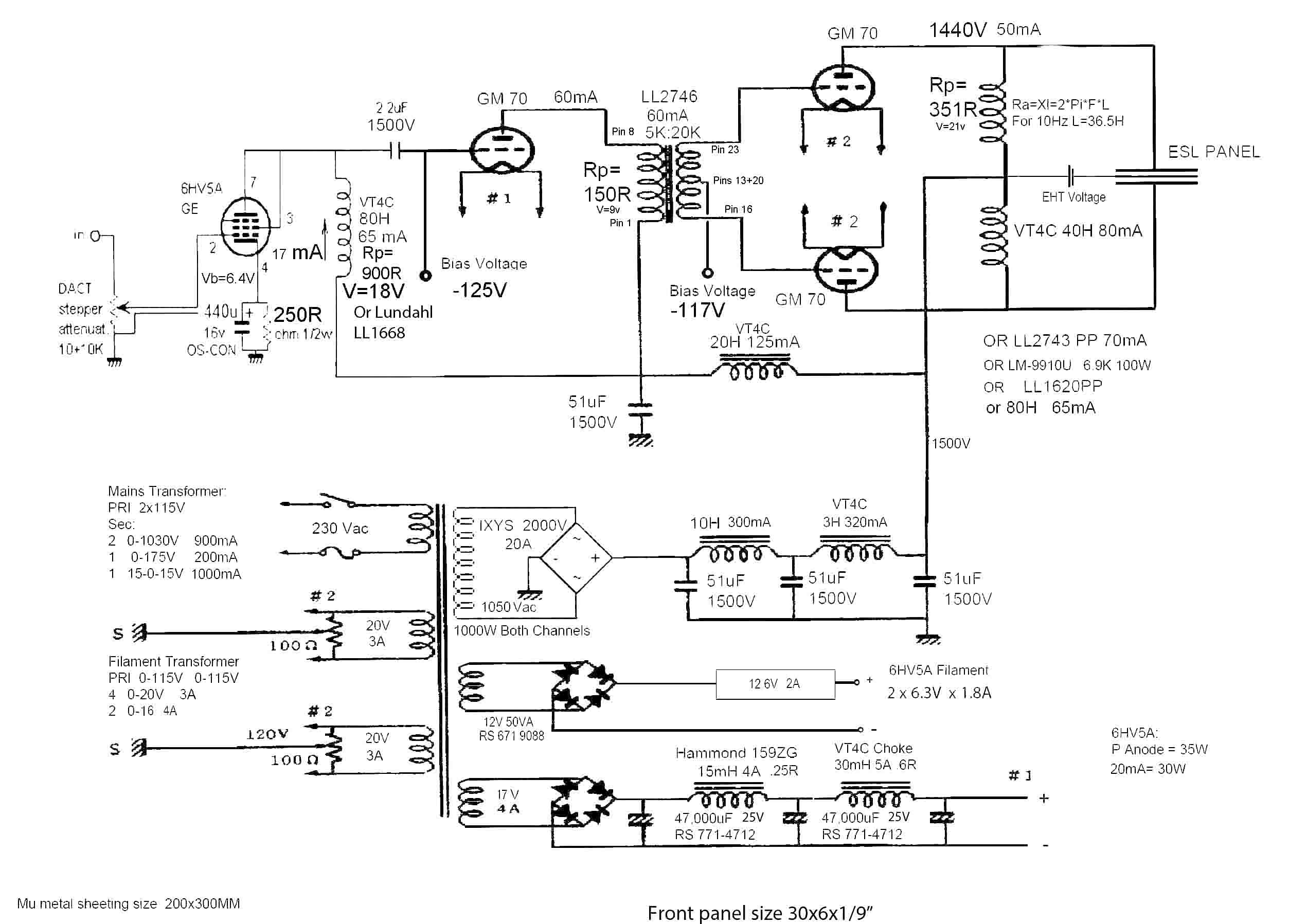

Why solid state? Tubes and direct drive ESL is a perfect match.
My Beveridge is playing just awsome and you can see the schematics above nr:73
The tubes are dirt cheep and there is a lot of them... so what are you waiting for guys and girls?
