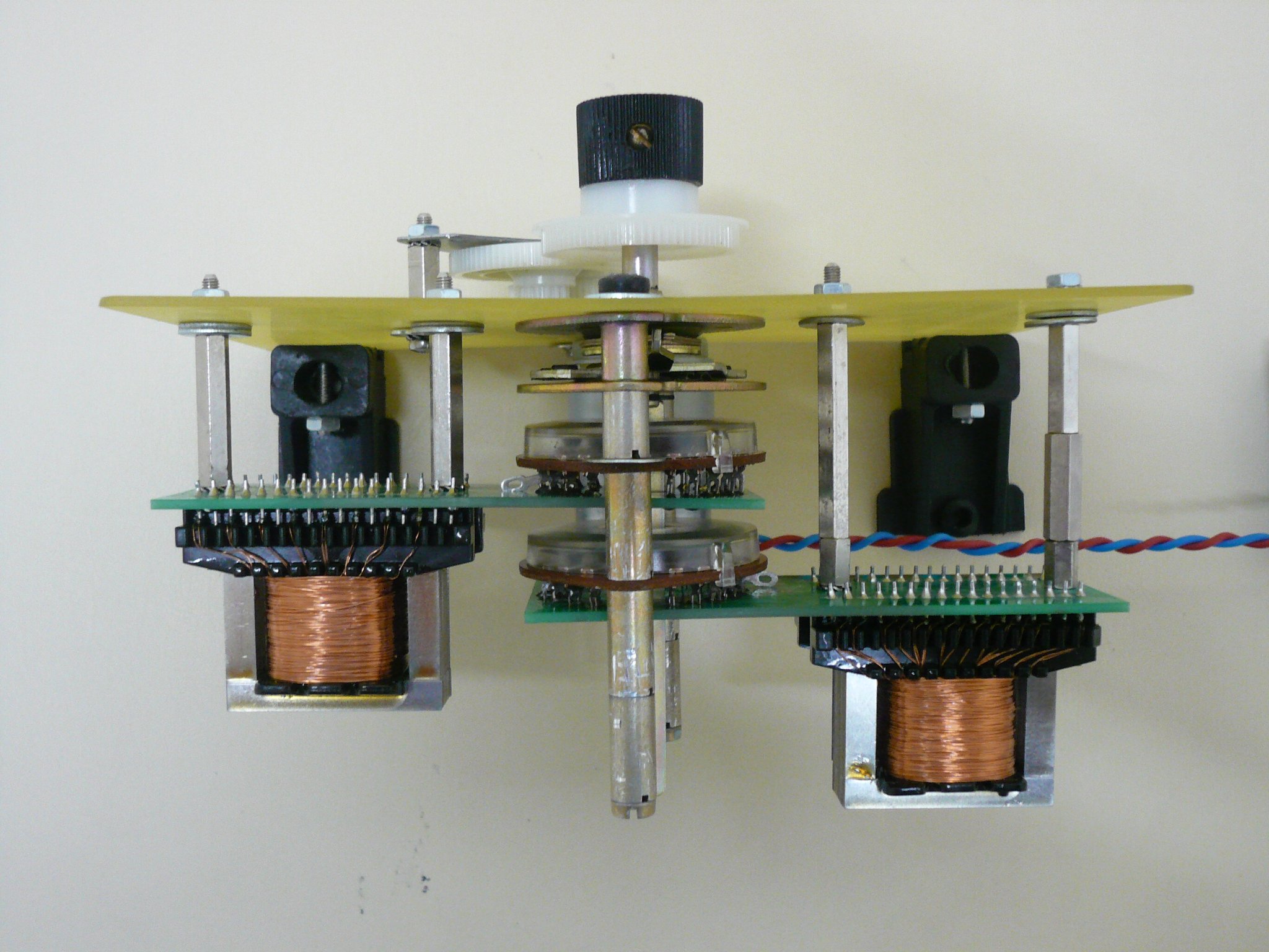

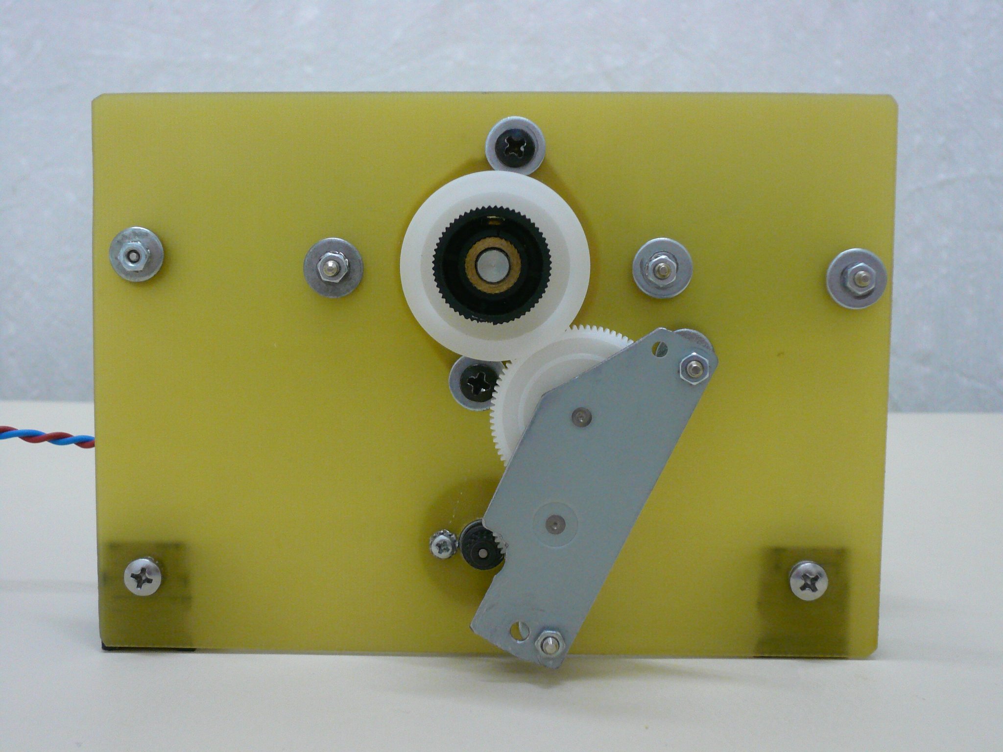

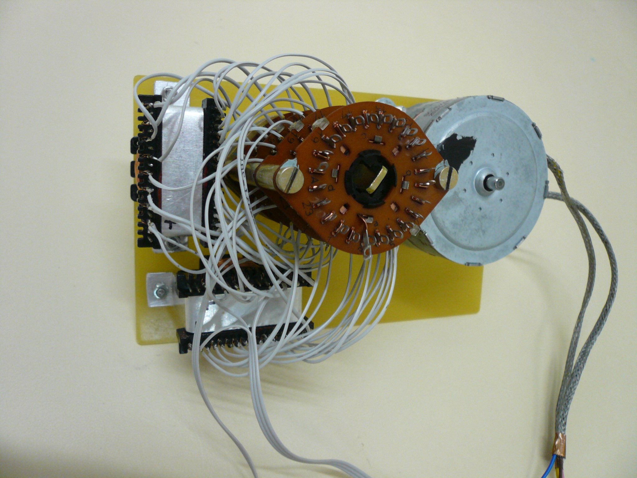

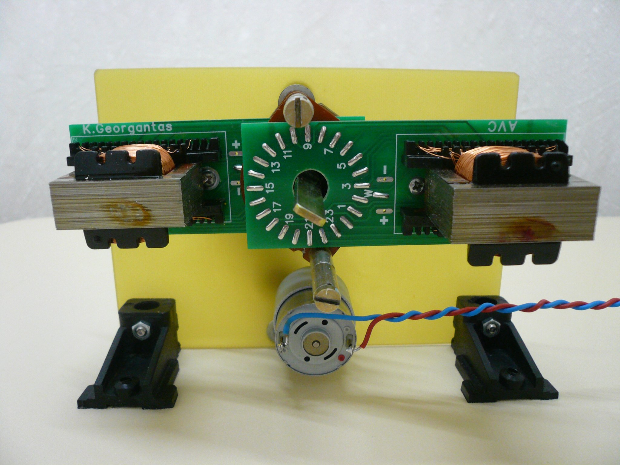

The motor has been for a long time in my drawer. I believe it's part of a washing machine. The gears are spare parts from a broken printer. It was tricky to combine them for a 2:1 reducer to allow the 48 steps motor to drive the 24 position switch since it has to substitute the "clicks" of the removed bearing ball lock mechanism. From a quick and dirty test seems to work smooth and accurately. Electronics for the motor will follow. Any suggestions are welcome.

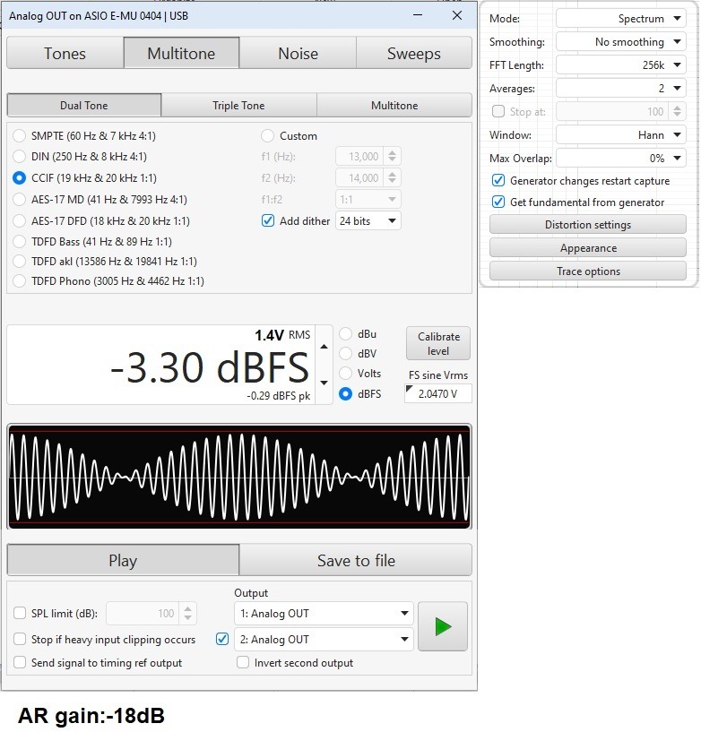

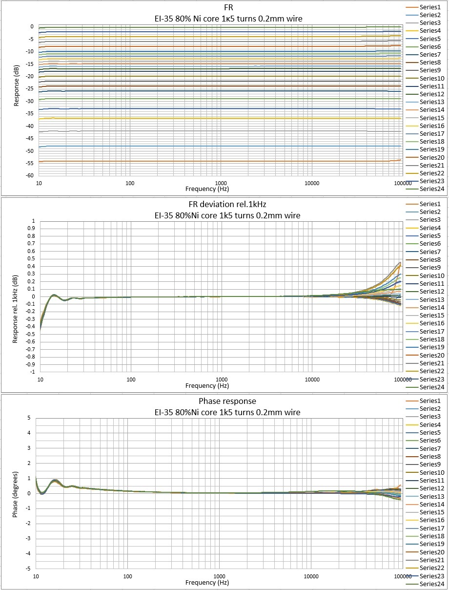

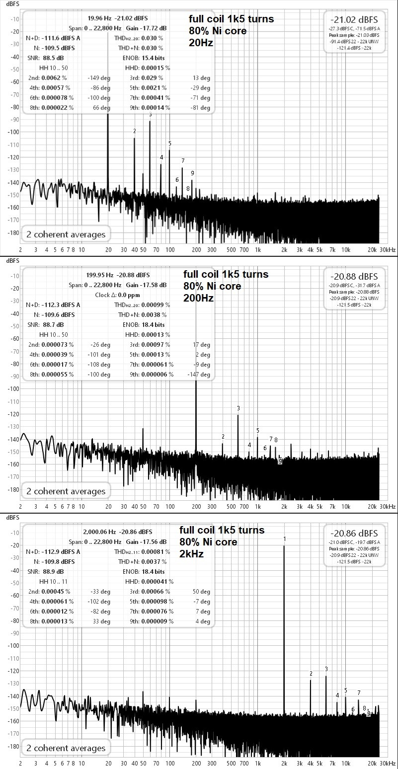

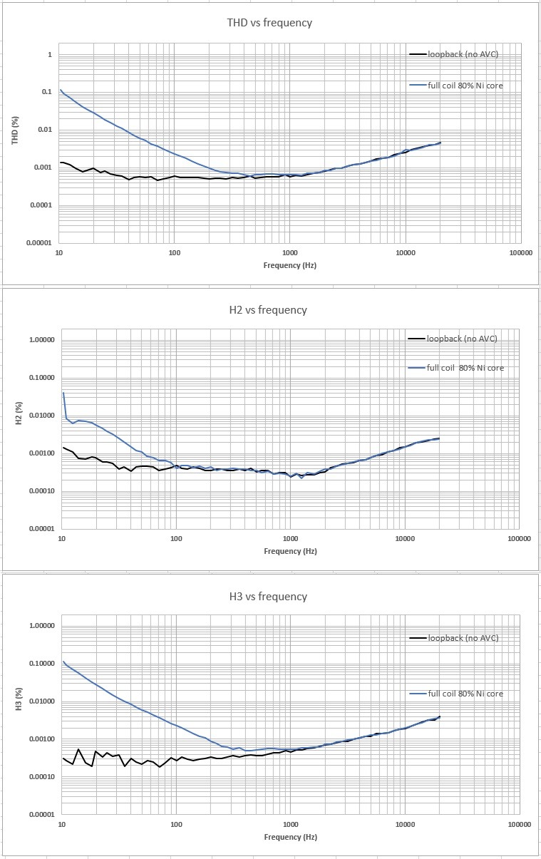

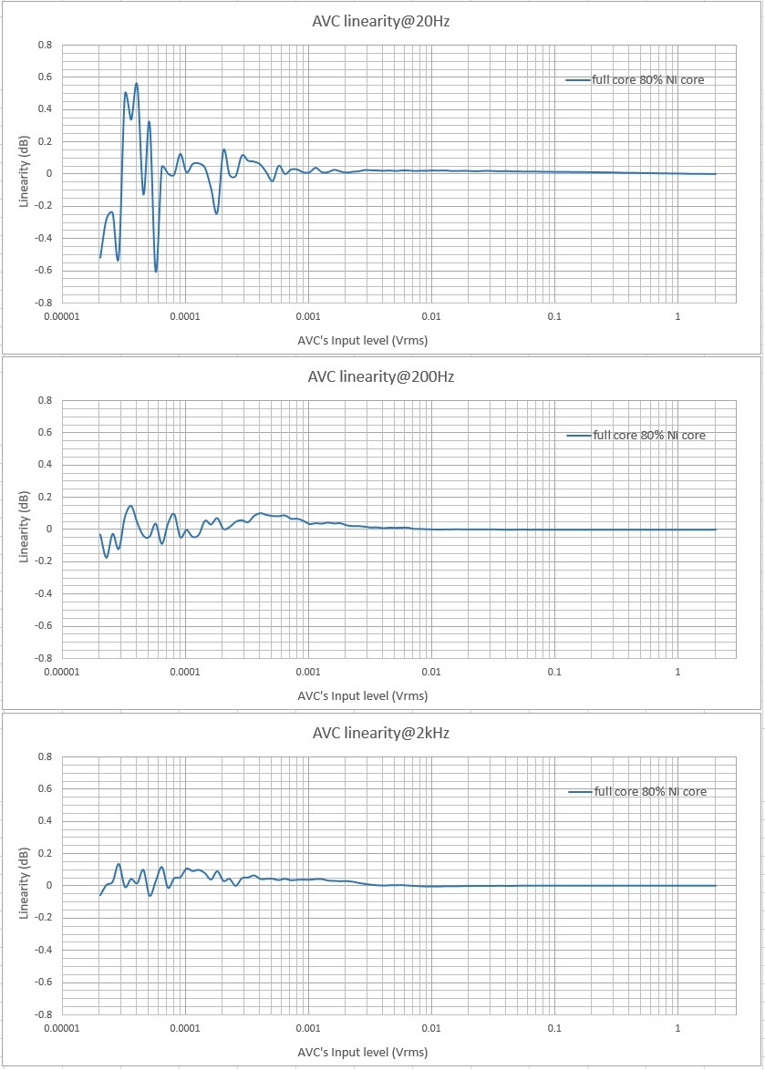

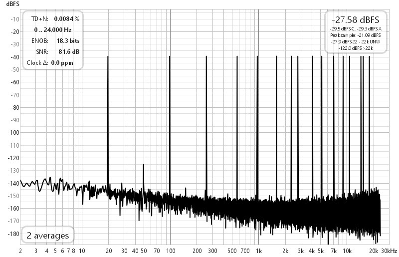

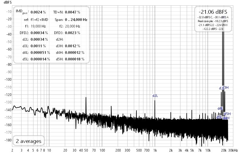

FR measurements of this later AVC
As always,
Source Rout: 500 Ohm
Load Rin: 20kOhm

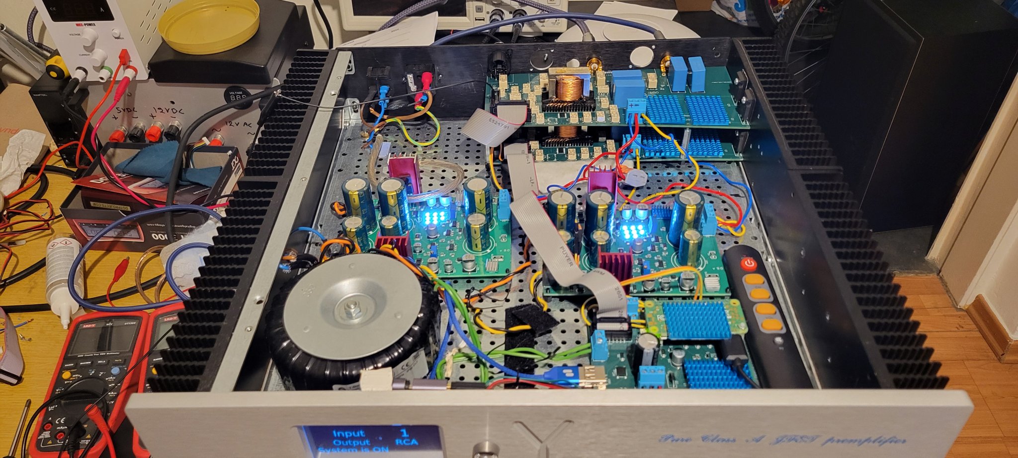

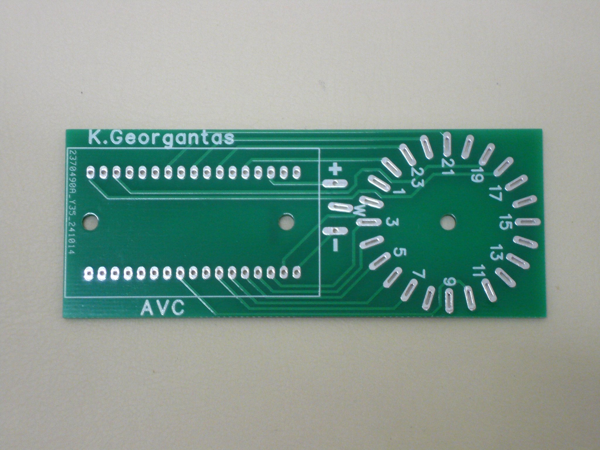

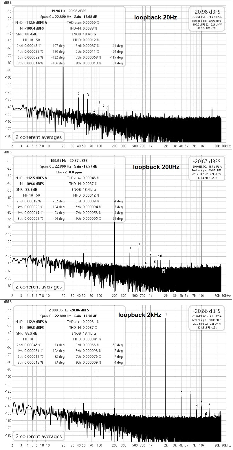

Wired, at last! It is now I realize George's epic effort to build all these prototypes! A million thanks for his work and his help to build one for my system! Already tested and works fine. Steps between channels are absolutely symmetric. In balanced configuration, it seems to enhance CMRR too. Inserted in my soundcard's loopback, it lowers THD+N significantly. Despite the mess, I tried for right angle crossings and apparently it pays off. No undesirable effects. Time to look for a remote control.

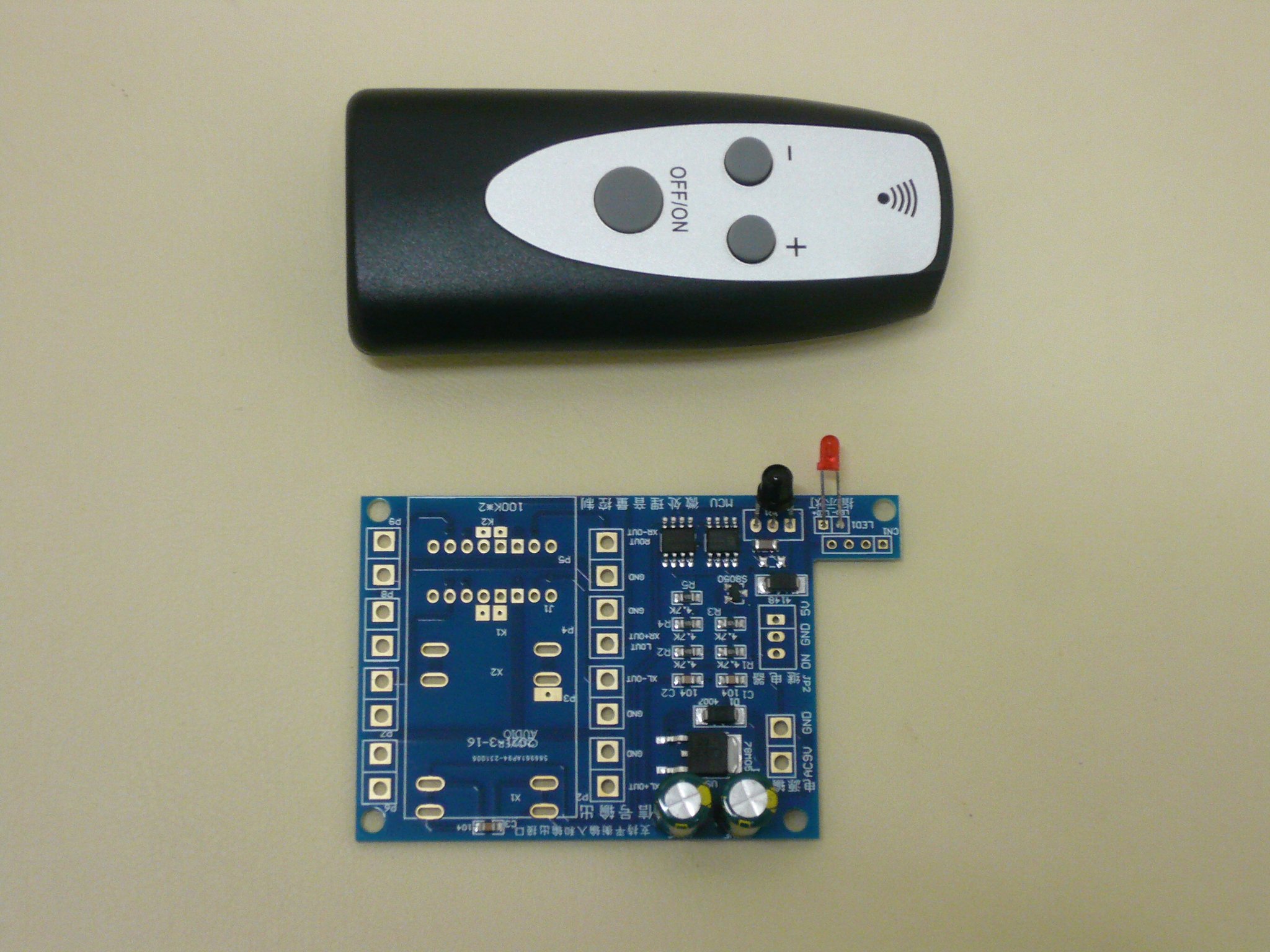

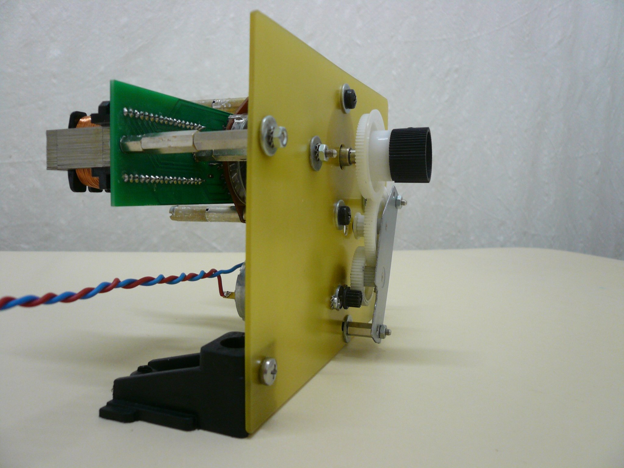

Just an update for your amusement! Although the first prototype mechanically was fine, I wasn't able to pair it with suitable electronics. There are a few stepper motor drivers available but they are not designed with volume control in mind. They did work but I had to chase the rotation with an awkward combination of buttons that made it non practical. Let alone the garage door remote control... So, I moved to another module that is designed for this job and it's great!
But this is for two wires motors so, I had to rebuilt the mechanism. New gear train for the weaker motor and careful alignment, or it won't rotate.
Meanwhile, I thought to tide up the spaghetti wiring...
Looking forward to install it in my preamp.
