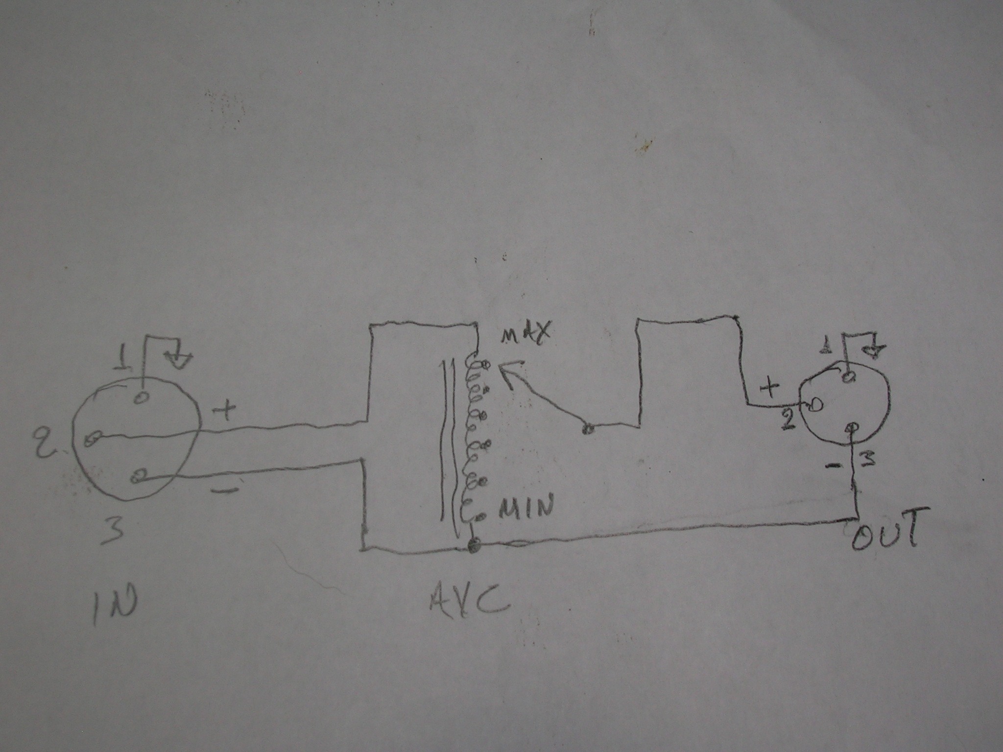

George confirmed that it works in balanced mode simply connecting it between hot and cold without any in series resistors to form the so called "U" or "H" shape attenuators.
Yes, it works. See attachment below for wiring.
however it is still advised not to attenuate bellow -20dB. To keep up with that, a fixed voltage divider has to be inserted somewhere in the chain and no matter how straightforward this might seems, there was evidence that it affects the tonality of the gain stage.
An AVC can be calculated, wound and wired in such a way that it's max volume tap is at -20dB (or any other dB number) attenuation.
The attenuation law of all the coil taps can start from there.
So the fixed resistive voltage divider can be removed.
George

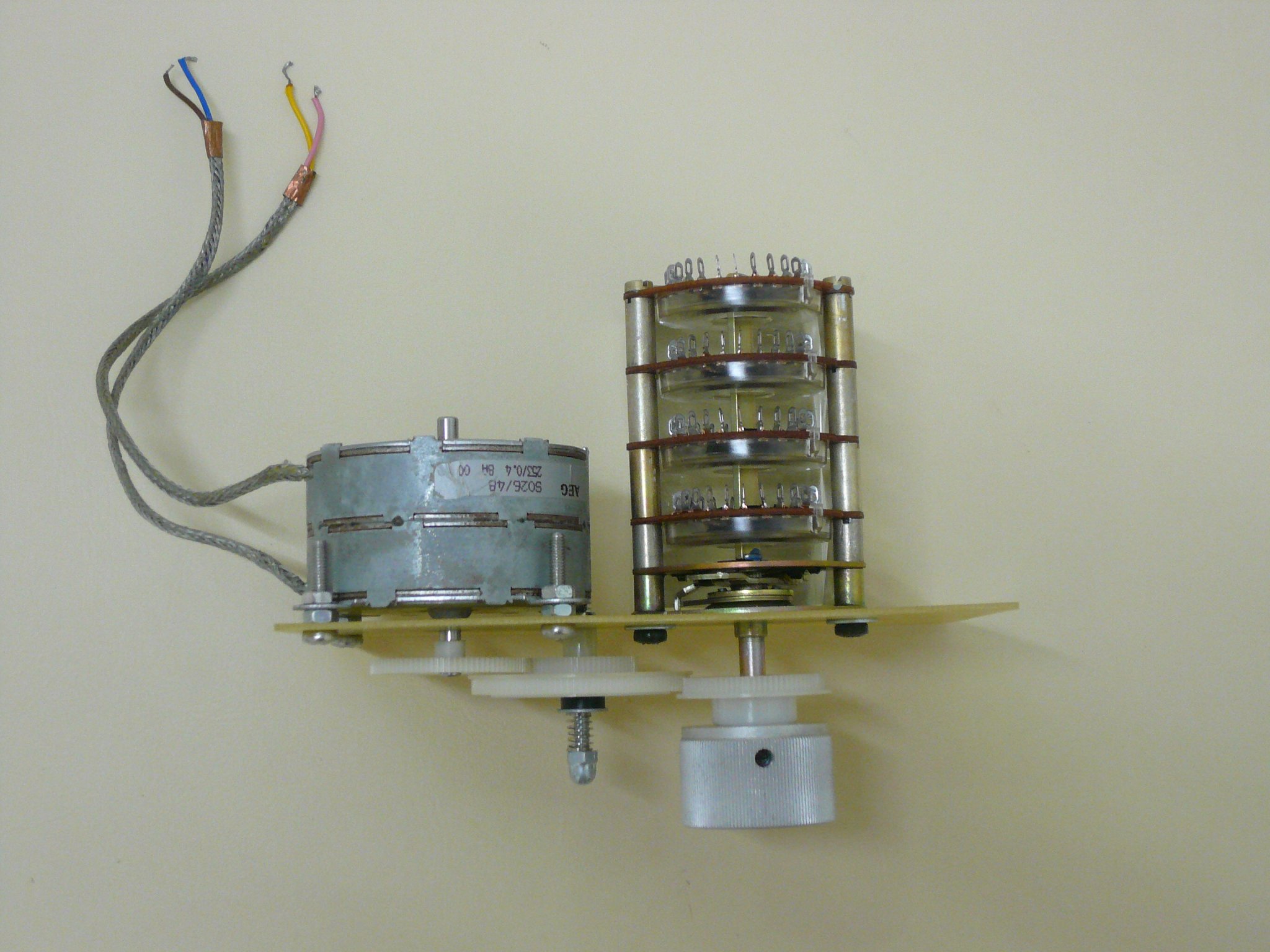

So, I've been going further down in this rabbit hole, with great delight , admittedly!
George's latest creation is wound on a much bigger core -please refer to him for technical specs- and sounds very good! It is neutral like the previous 49% with 3k5 turns but also sounds "effortless" , the only one so far that no doubt it doesn't add artifacts. Also, this was the first time I could try the AVC in balanced mode and I certainly enjoyed it very much. Perhaps because my system is balanced throughout and maybe I'm subjectively biased. It's true however that I had to use a rat nest wiring to connect in SE mode for comparison and this possibly added noise. Anyway, I can verify it fits naturally in a balanced system, it doesn't need the ground to work, and this is an advantage since in SE a missed ground turns it to a low pass filter.
On other news, I got my hands on a very nice NOS rotary switch -thanks to George- and managed to put it together with a strong stepper motor. The plan is remote control, two decks for AVC and two for a resistive VC, switchable, for the ultimate comparison. It's not going to be very soon though...
Unique solution as always Kostas ! 😎
Where did you salvaged this gear train from?
Printer, washing machine, debris from an allien spacecraft that fall at your backyard? :magnet:
Thanks for the heads up for the new AVC :up:

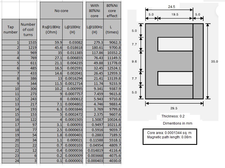

The core is 80%Ni EI 35 and the wire is 0.2mm
George
