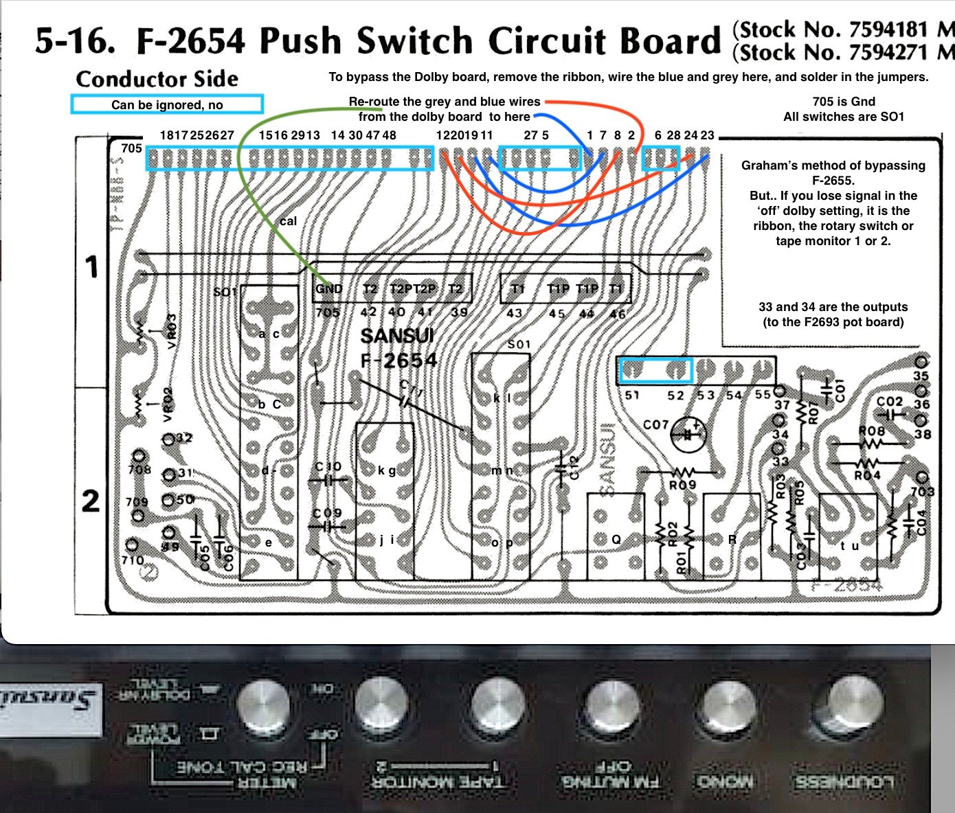

Hi!What you need to do is figure out signal in, and signal out.
I looked the issue of the Sansui 8080DB and 9090DB dolby wiring and bypass a little last night, once some pins are numbered, and some pin numbers corrected, it becomes a rather simple task, even if the schematic and PCB layout are sometimes at odds with each other 🙂
Of course I may have made a mistake, but essentially I think my method is correct:
A picture is worth a thousand words (see pic), so this is my way to properly bypass the board with 4 jumper wires, and by moving the input from the F-2655 daughterboard to the F-2654 switch board, which is where it should have been anyway.
Unlike other mods, my bypass mod doesn't involve destroying the F-2655 board, that's simply left in place, ignored.
But:
As an aside however, this bypass is really just mimicking the 'Off' position on the Dolby selector switch, and in that setting I can't see anything but the dolby selector wafer switches (x3) and the tape monitor push switches (x2) - so if the signal is not getting through in the Off position it's either a broken ribbon or a dodgy switch.
I.e. The bypass simply eliminates 3x wafer switch contacts and the ribbon.
This then leads to my conclusion that the best way to fix this dolby circuit is to recap it, put a nice new flexible ribbon in it (potentially buying a swanky Silverflo vacuum desoldering station first....), and cleaning the switches - because if they, and the ribbon, are working, Off will bypass it - as designed.

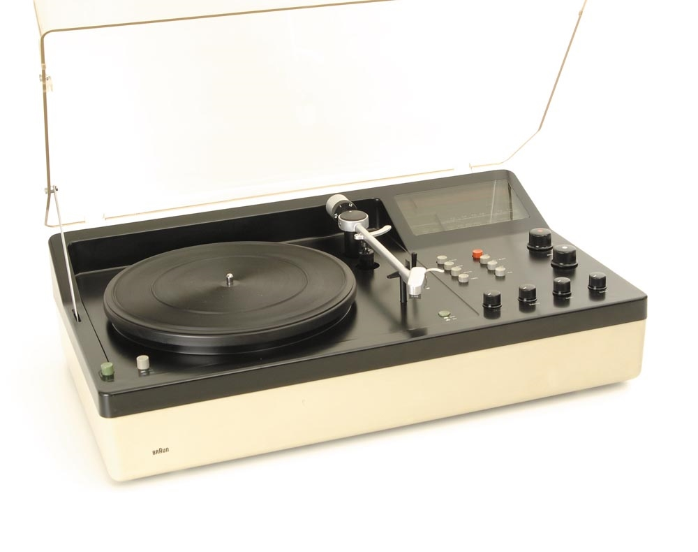

They look like the Peerless dome tweeter.
Very interesting, I didn't know Braun made speakers at all - I'll look out for them now.

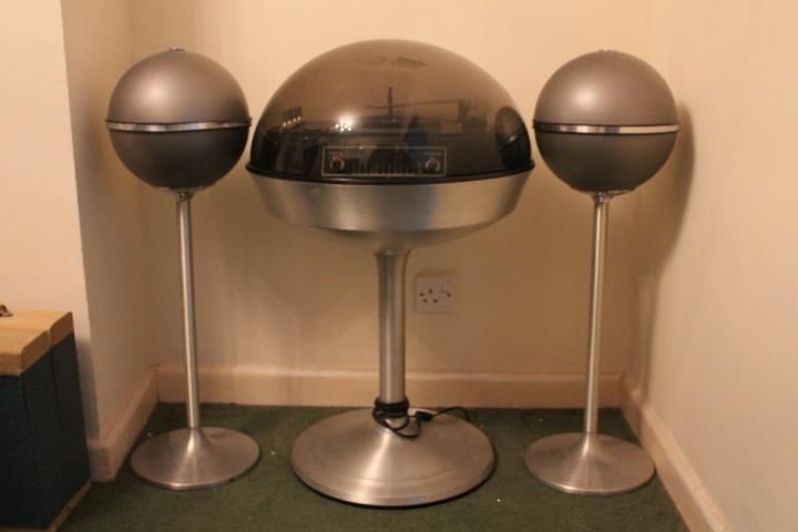

They look remarkably similar for my Grundig Box 550, even down to the metal grills - I guess that's a german thing.
The tweeters are similar too, external wires - good for cooling.
Yes. BrAun used mainly GRUNDIG and PHILIPS speakers in their enclosures.
Maybe Grundig or Braun also made turntables? 🙂
Grundig ? I don't know, but certainly... BrAun notably made "integrated turntables", like the Cockpit 250 that my Parents had (trashed for long by them, a crime 😡...). It was exactly this one below - also designed by Dieter Rams :

Very interesting guy, some superb designs!Dieter Rams
It seems he also did some designs for Grundig such as the Audiorama 4000 speakers..
... so this explains why the Braun and Grundig speakers had a 'family look' with the curved edges, recessed metal grill capture and overall design !

Hi Globulator,
I'll have a look later on, and it may be a great deal later on! lol!
You have the right idea. To be honest, you're further ahead to bypass the entire mess. The last one I repaired involved going back in a few times to repair top to bottom connections, and inter board connections. As soon as you disturb this mess, other things happen. Since no one uses outboard Dolby units anymore, the circuit is entirely pointless. FM Dolby broadcasts were very short lived, so the receiver based Dolby processors have no purpose.
Somewhere I remember the Dolby boards provided gain. I could be wrong, but I was sure they used a defeated Dolby board as a gain stage. If it doesn't provide gain - GREAT!!! That just makes life easier.
Wishing you luck!
Wishing you luck!
