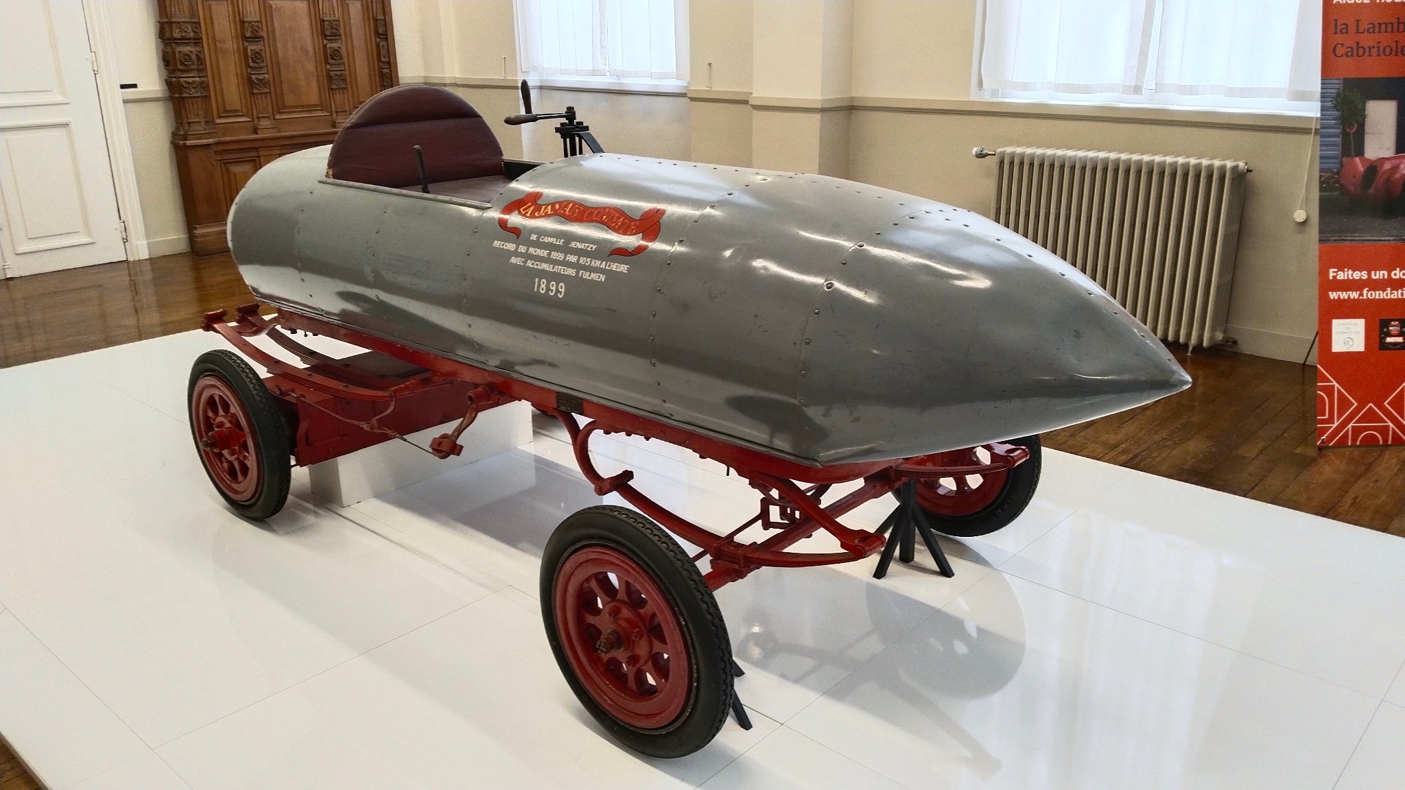

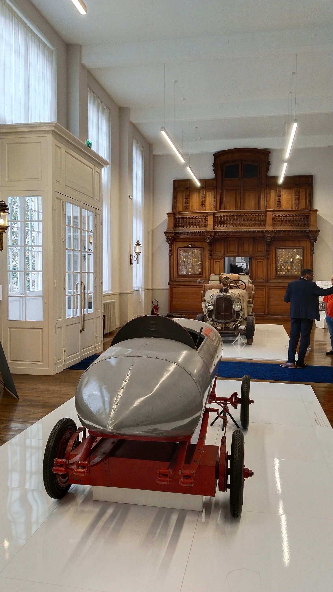

The first car to ever reach and overtake the 100 kilomètres dans l'heure car land speed record. It was in France, at Achères, near Paris, in 1899... Many years before that any thermal engine would be able to do it.
I actually saw this car in July, it's in Napoloen's old chateau in Compiègne, it looks as it it would be very scary at 100kmh. I looked carefully but could see no wires between the mysterious box on the back axle, and the bodywork, apart from a small cable brake, so I have no idea how the power was transmitted or controlled - perhaps details were lost and this bit was rebuilt for show?!
EVs in the 1800s were good, as they were lightweight, electricity was I think, free, and the batteries could be rebuilt in your shed, so the 'Right-to-repair' was top priority back then, and they did well until the oil lobby arrived.
Now we sort of have a powerful EV lobby, but we are only offered massive complexity and cost - which I think will bankrupt all but Tesla, although even that design has majot flaws (some unconnected to the propulsion system, such as 'how to open the back doors if the power goes?' and the daft electric glovebox etc).

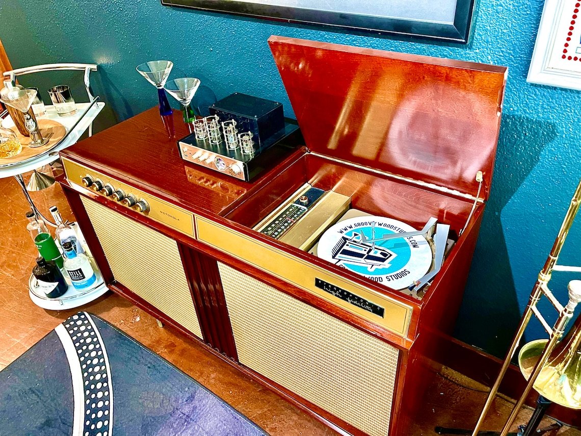

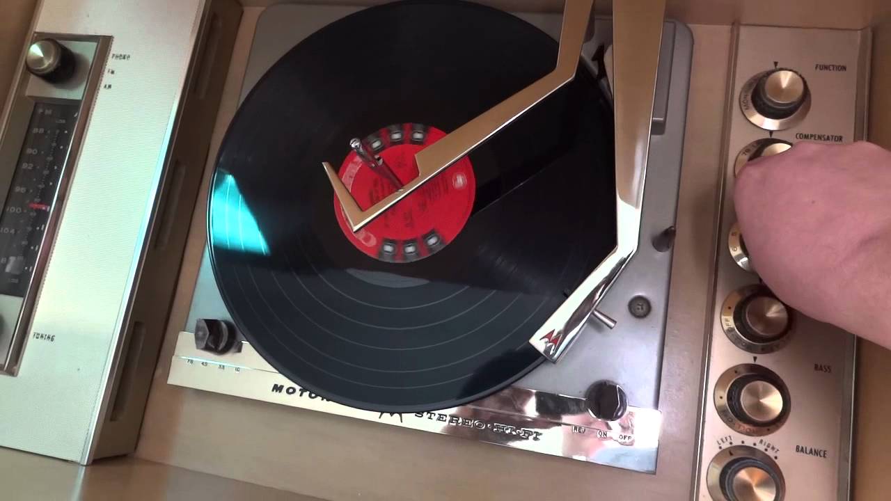

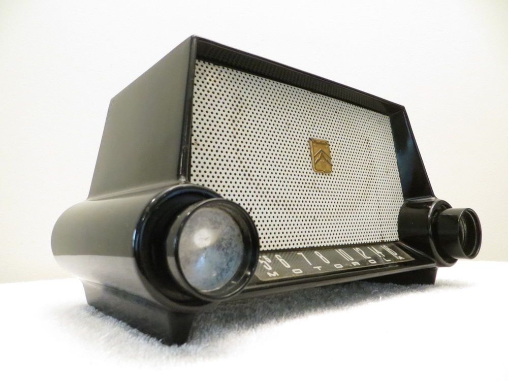

Perhaps the purest HiFi in that sense were made by Toshiba and Hitachi - maybe Sony too - as perhaps they used more of their own parts. Shame Motorola never made hiFi...
Hmm, I stand corrected, they did start!
https://www.stereoconsole.com/stereo-console-history/motorola-stereo-console-history/
And of course car radios, which is what the middle concole appears to have.
I detect the 'small department in a huge conglomerate' syndrome here.
