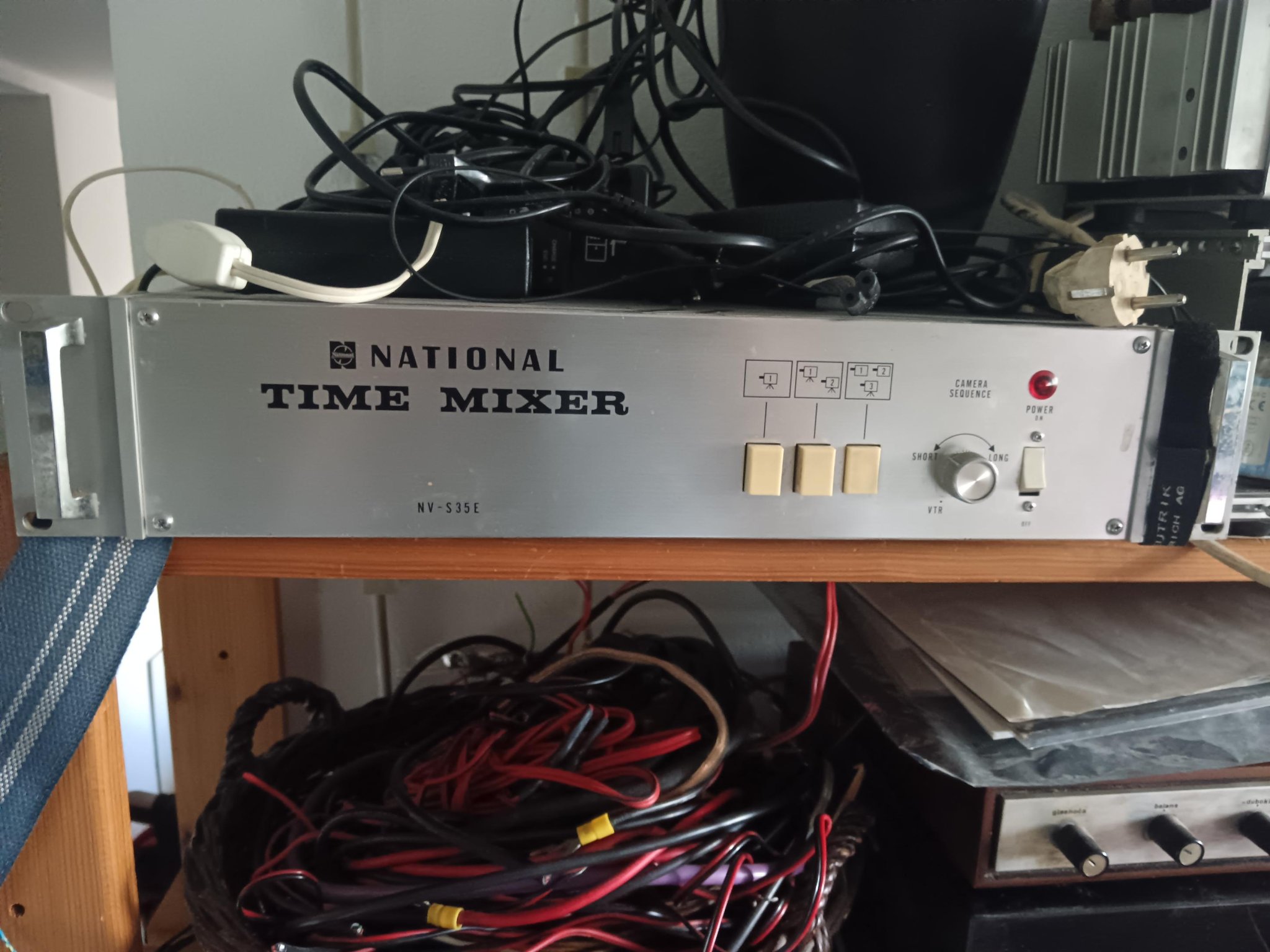

No, but I have machine made to mix national time, it is made by Matsushita and has serial number. Might be it will not get you in time where you want, but it will take you somewhere in time . I can re-engineer the design🙂PS. I see a lot of designs and building plans in this forum. Anyone be so kind to post a plan for a time machine?
