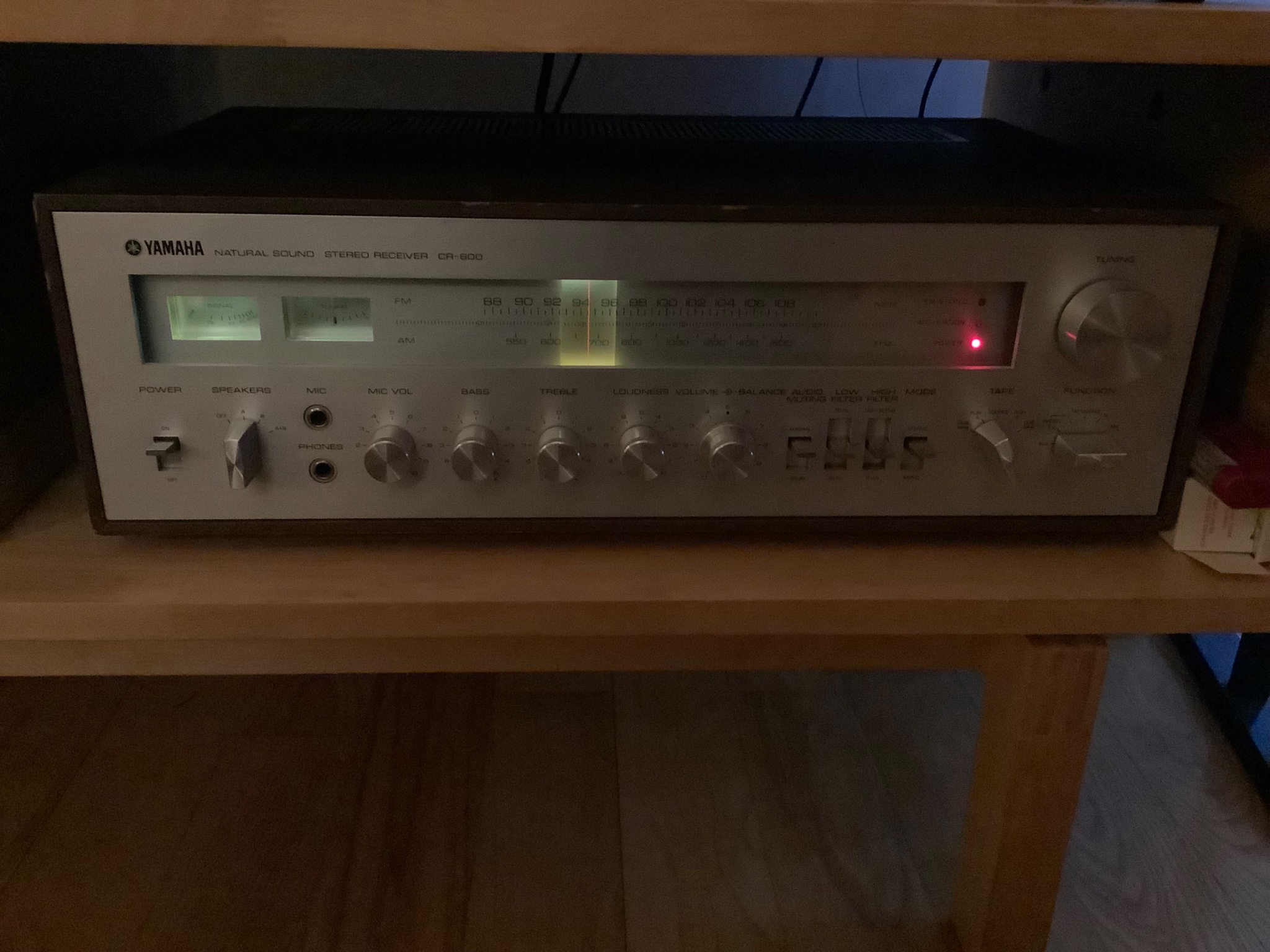

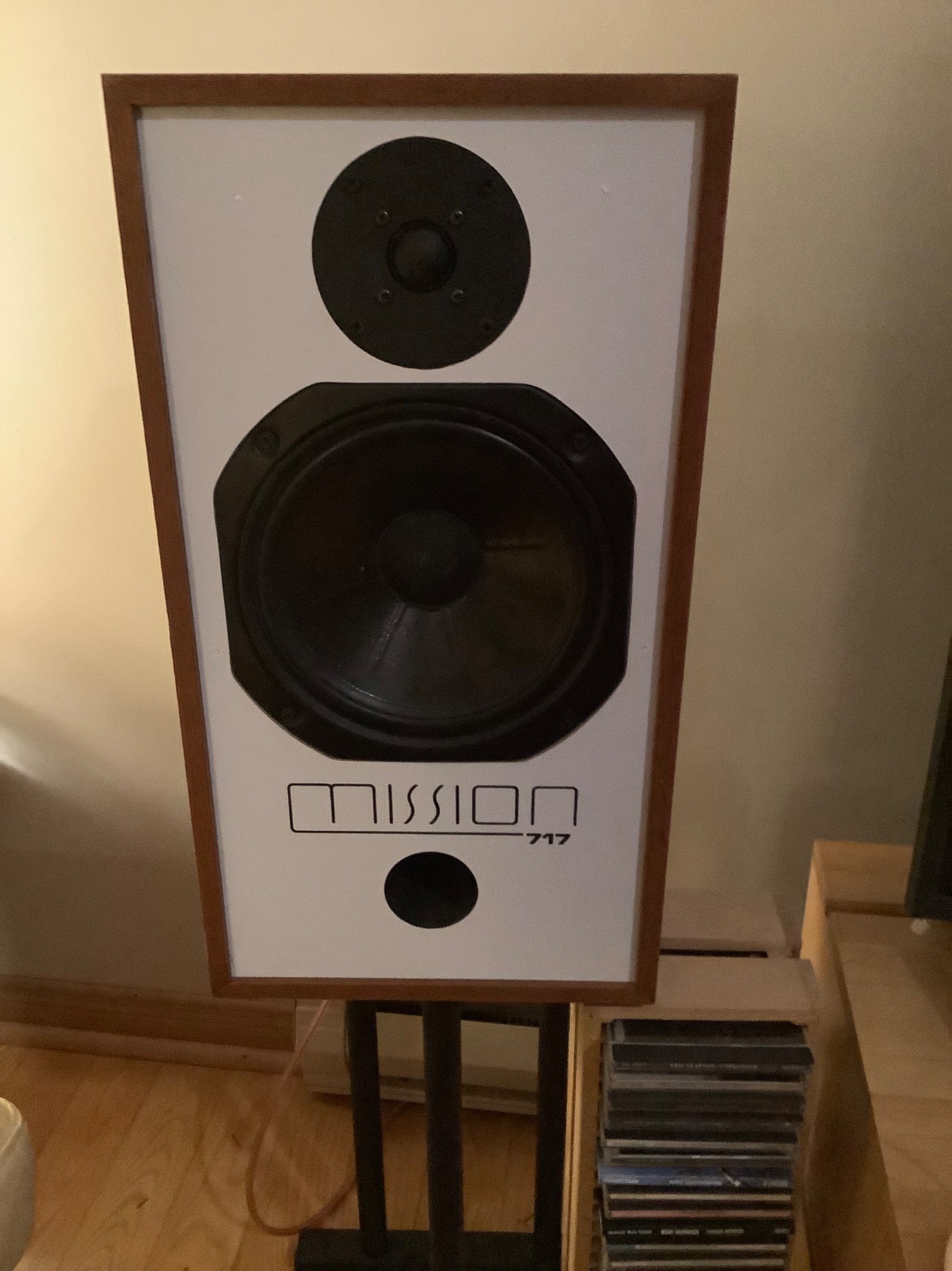

Listening some very good music at the chalet, here a very simple sound system that sounds a thousand box, Yamaha CR-800 (no dolby boards 😉 receiver with Mission 717 speakers. You couldn’t believe I pickup these speakers for 250$ with stands, as new! Source at the moment is an ipod first generation, music files uncompress, very good Chris Botti for example, sounds just lovely. I have also a vintage Sony a 338ESD CD player. I think vintage electronic needs to be pair with vintage speakers of the same area.
I have mega bucks sound system at home, but this small vintage system just hits the spot.
Just my two cents.
NB: there is actually a nice story about this receiver, one of my nieces one day say this receiver on the side of the road, and she thought, well my uncle that is into hifi (that was me 😉) can probably use this. She pick it up and here I’m with it.
It was in incredible shape, no noise on any of the pots, nothing, almost as brand new. Now it is making greats music at the chalet…

Gawd! I did warranty service on both speakers and receiver. It was a good sounding little system for the time. Enjoy!
Now who told that person to throw it out??? You're a winner.

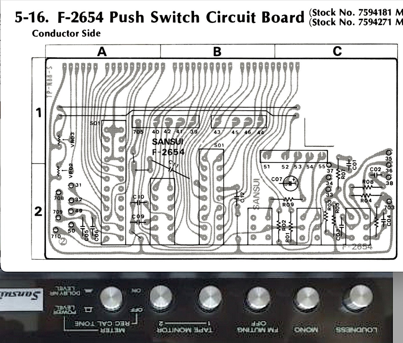

Yes, the dolby board has been a source of much wailing and gnashing of teeth around the world. There are a few modern dolby chips but no one seems to have worked out a suitable substitute fix yet.Hmmm, the db models have a two board dolby and it runs all signals through it. The boards can have intermittent board to board, and also top to bottom connections. A nightmare of intermittents. Since the dolby board provides gain, you can't just bypass it (but this would improve sound quality). I usually recommend people avoid the db units. I have an 8080db I think. Nice amp design, too bad about the dolby boards.
Many just bypass it I think, but lose a little functionality, while there's a harder bypass scheme I saw with 62 vias added to the stripped board, which is perhaps better.
Some gain is lost, but I don't think it matters much.

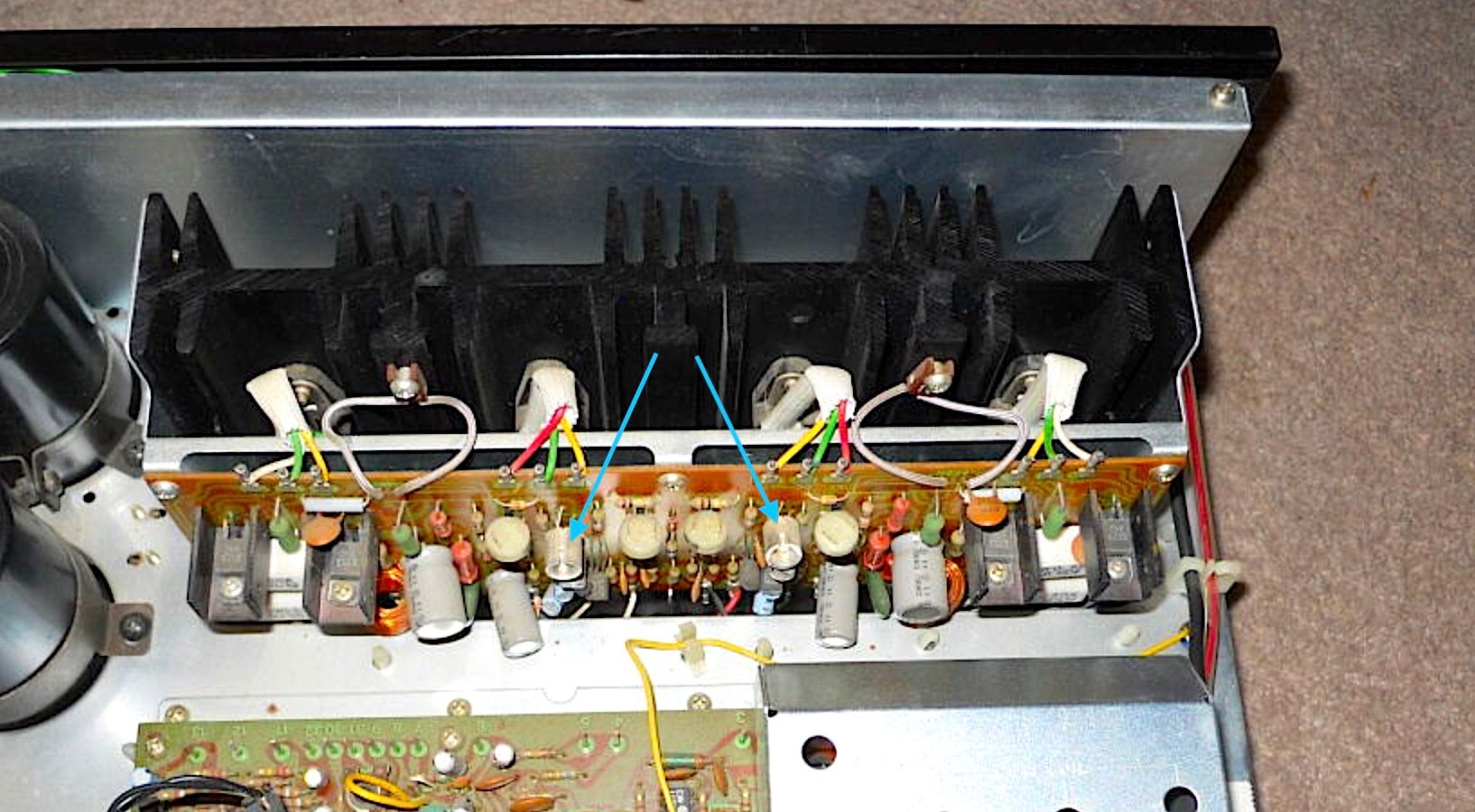

Pioneer made them nice and easy to get to (not my photo), and nicely in airflow too so a heatsink might be OTT, but I'll see how well they go on! Good idea for the heatpaste, I'll see how hot they get with my IR temperature sensor..If they are running too warm, change to a TO-126 package since the uniwatt packages were discontinued. (TO-92M). I would update the drivers for sure. They should then fit in without having to rotate the package so the pins line up. If you really want to use crimp-on connectors, put a touch of heat sink grease in there.

All Dolby chips have very high distortion. Every one. Studio Dolby decoders and encoders are far better, but they are horrendously expensive. I am thinking of sticking a small Op Amp gain board and bypassing the signals through it. Fixed gain, low distortion.
The amplifier design in the db models is far better than the 8080 and 9090 models, so it was a real shame they ran all signals through the Dolby boards, all the time. Absolutely, bypass the Dolby signal path. They look really nice, don't they?
In the Pioneer, yeah. Use a TO-126 case part. Whatever you can get in your area that is a real part and not a renumbered fake. Low current, high voltage (50 mA is fine). If it runs warm, you can attach a small heat sink to it. As an example, I would probably look at a 2SC3423 or similar.

As there appears to be no true bypass, I agree.Absolutely, bypass the Dolby signal path.
There's a lot of recent discussion on this, perhaps these receivers are being used more, and therefore breaking.
https://audiokarma.org/forums/index.php?threads/f-2655-mods-and-board-design-info.1002011/
https://audiokarma.org/forums/index.php?threads/fix-that-sansui-9090db-with-a-bad-db-board.1066880/
I looked at the circuits, the schematic and the PCB layout in the manual: one 'small' problem with working out how this dolby board works is that the ribbon pins are not numbered consecutively, some of the pin numbers for the small connectors are labelled wrongly 46<->44, 40<->42 etc, and the schematic doesn't actually match the PCB in other ways either, e.g. R901 - R904 are not on the PCB (in the manual).
Looking at the schematic, it looks like the ribbon cable should be desoldered and discarded, and that various pins along the F-2654 ribbon connector holes (now sans ribbon) need jumping, and then it should become a normal, non dolby receiver 🙂
This, at least, is my current theory.
Well, no offense to AudioKarma. I am a member and can't stomach the place. It is swimming in misinformation and non-professionals acting like they know what they are doing. Some information can be helpful, but much is really bad advice.
What you need to do is figure out signal in, and signal out. Measure the gain between those points and then bypass that path. Nothing else matters. Figuring out exactly where the signal runs is a total waste of time. It is possible the tuner path may be different. Just watch for it.

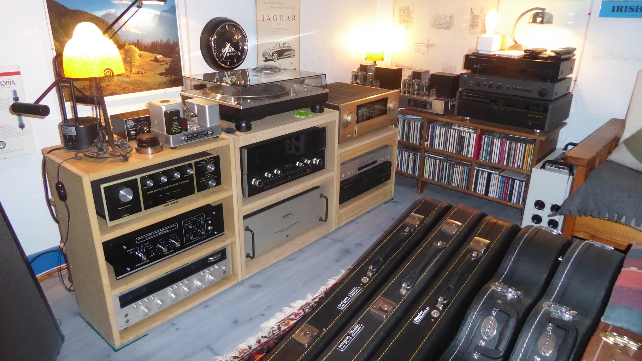

In my little Auditorium, the 2250B :

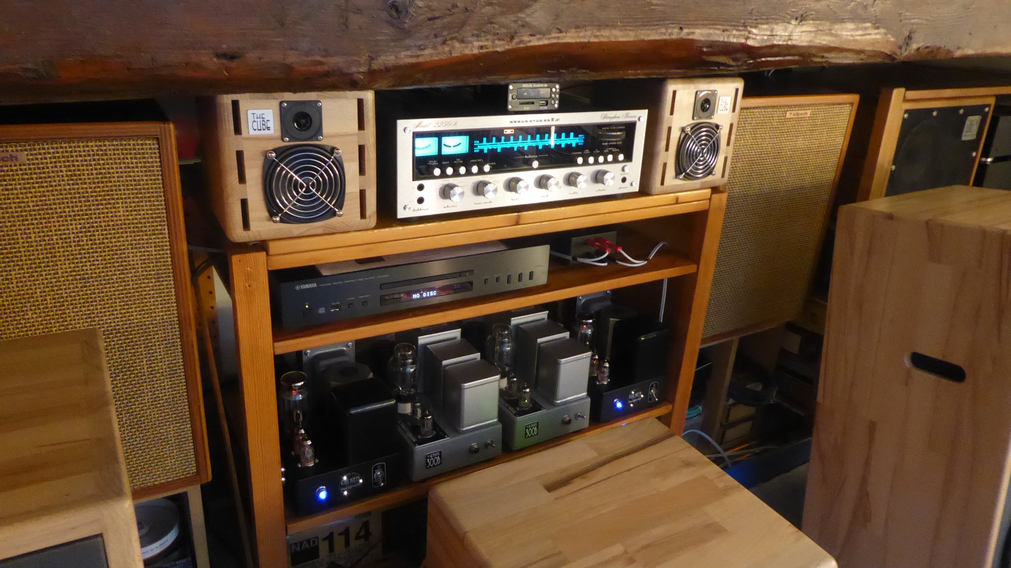

Also the 2270, at left, 1st level :

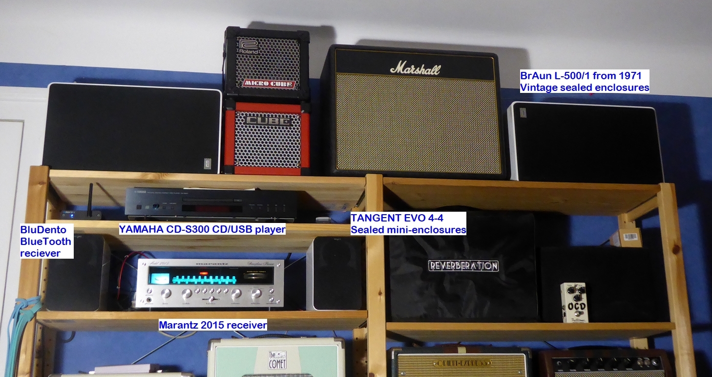

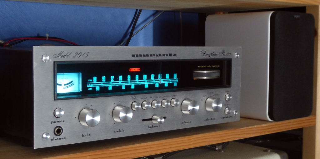

The 2015 in my second Audio system :

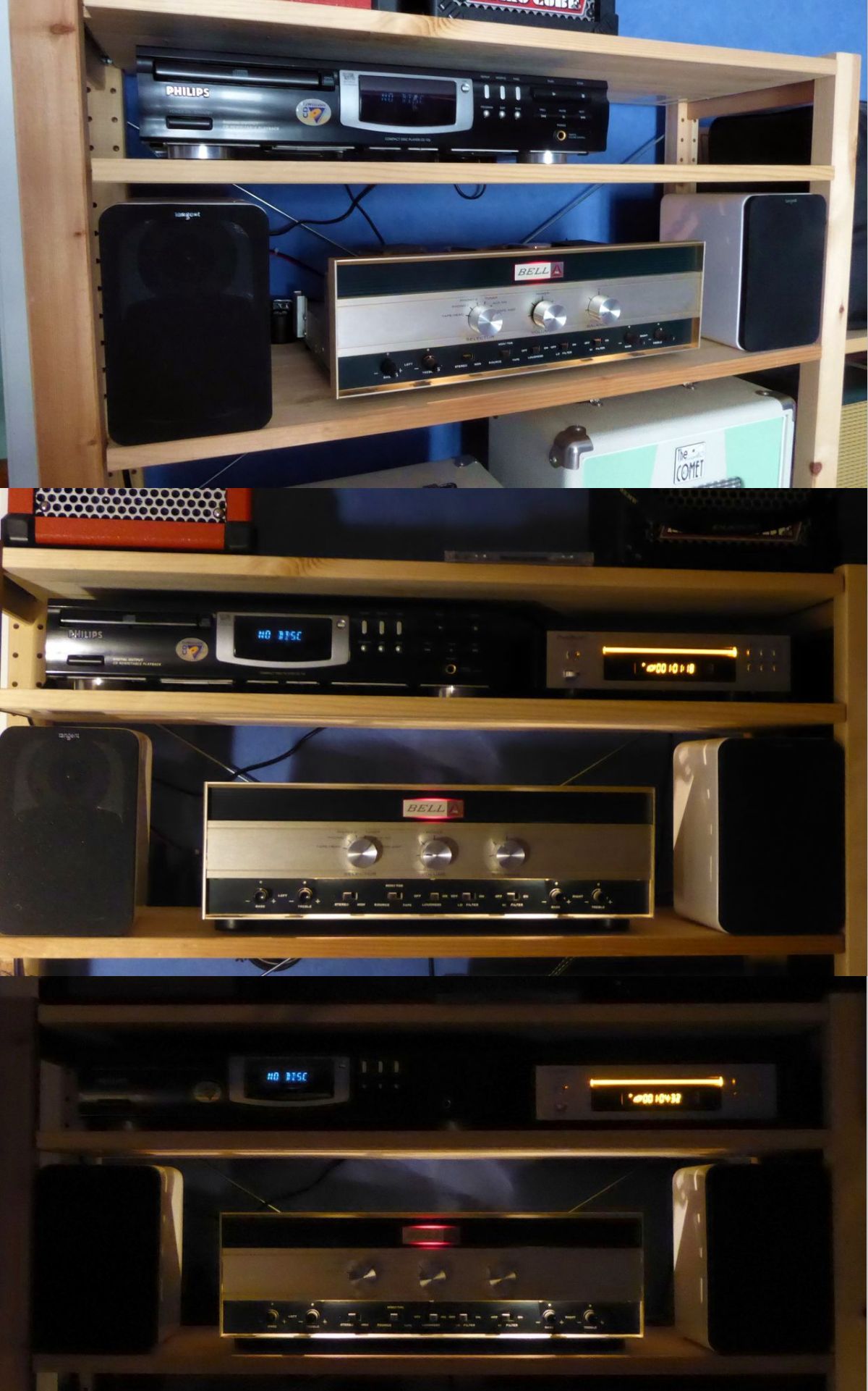

My "most antique" that remains now is my BELL 2420 from 1964 :
