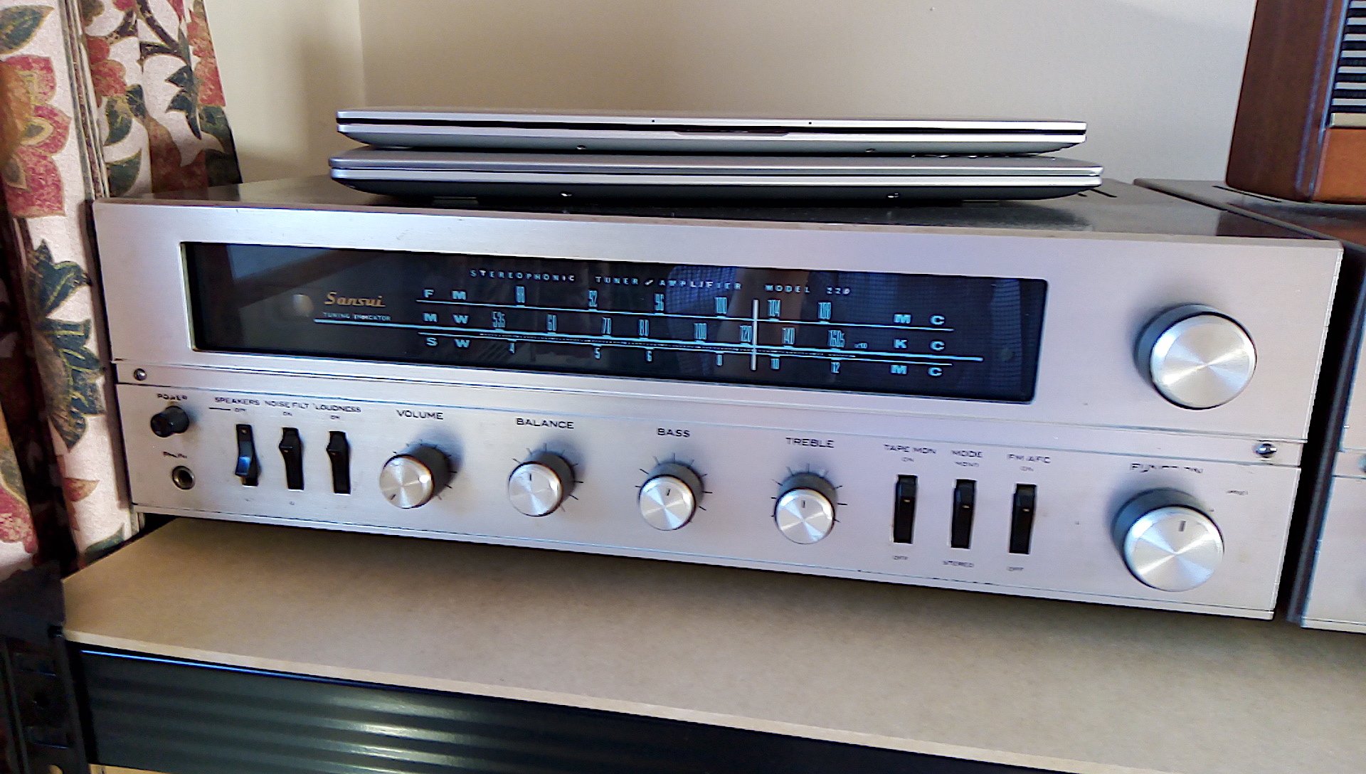

I have a Sansui 250 (pic), actually, that I will recap at some stage - and perhaps upgrade the resistors etc - I'd be very interested to see how that compares. I would expect it to do well, maybe coupled to my Grundig Box 550 - which are similarly amazing speakers of the past (they even have factory wool stuffing, while we in England had the 'rather ordinary' Mission speakers LOL.!!)
I'll have to get better photos lol 😀

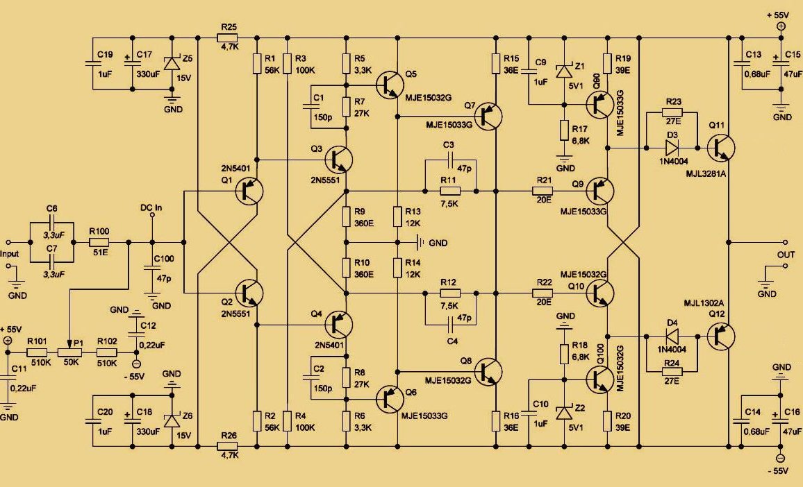

Info of the thinking beyond THD in the CC-2 design can be found here.
http://www.audiophileaddicts.com/2017/07/audionics-oregon-cc-2-distortion-better/
http://www.audiophileaddicts.com/2014/11/slew-rate-matter/
I quite fancy making on of these CC-2s, without the 'questionable' zeners on the LTPs on the inputs anyway, CCS there for me.
A short feedback path tends to favour stability I think, but also the choice of design...
.. I've seen a cathodyne behave better than an LTP in this regard - for phase splitting, in a cathodyne the two phases move at the exact same time. But in the LTP I saw a slight delay as one transistor (or tube) hands over to the other to balance. The balance effort in an LTP is instantaneous - but the time to achieve balance is not... and so it slightly misaligns down the feedback path to use an LTP... i.e. I found less stability.
My SEP amp uses feedback from power tube anode to driver tube cathode.... this is also a very short path, only two tubes to traverse.. the input tube is left to its degenerative feedback, so that's fast too.

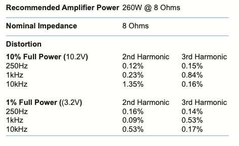

The reason I say the THD is nonsense, because to me it doesn't make sense to use a metric that treats a (e.g.) 5th harmonic, for example, equally to a 2nd harmonic. Listen to this:
We can see the two tones he plays here sound very different, but have the same THD. So what use is THD to listener or buyer?
THD is an appeal to authority, because people looked at the number to tell them how good it is, over and above trusting their ears.

I came across this last night, happenstance, as I'd seen a review of a cheap 20W Class A clone, so I was looking at clones:Chasing THD and IMD has produced far better equipment, and much better sounding equipment by any metric. Stop picking at poorly performing equipment
This is a design everyone loves, and it's not even the original $53k build, it's a cheap $500 build.
Everyone loves it. Why?
Agreed, it's not easy, and what's the lowest distorting loudspeaker? 3%?Being an 'Electro Mechanical' device, speakers are STILL the weakest link in the chain
Tannoy used to publish distortion numbers, but few do, because it's difficult to measure, and it's always high.
THD of the Tannoy V8 starts over 0.6% at 2.5W and goes well over 1% at 25W, and that's just the 2nd and 3rd harmonics summed.
What is the point of a 0.001% THD amplifier, when the speaker throws off at least 3000 times the THD?Now if you decide that you like a certain type of distortion, that is not high fidelity by any stretch.
Clearly in the real world, THD is not a worthy goal unless you manufacture speakers...
The chinese also clone is to the last details, BTW: https://vpayaem.ru/circuits_dartzeel.html
