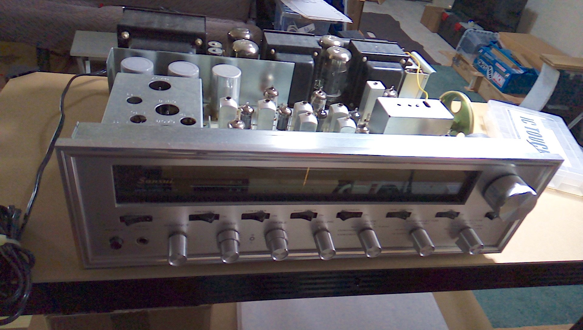

I haven't listened to the Pioneer SX800 yet, it needs new output tubes and then perhaps I'll fire it up.Sansui iron was far better than most, especially Pioneer.
It's party trick is a tube MM phono stage, quite rare for that age, the contemporary tube Sansuis have transistor MM boards.

Spot on for the SX800, 7189A at 450Vdc, so I think I'll order 6P14P-EV for them.Pioneer pushed output tubes way too hard.
The A version that came shortly after went to 7868 running at 460Vdc, which was a bit smarter.

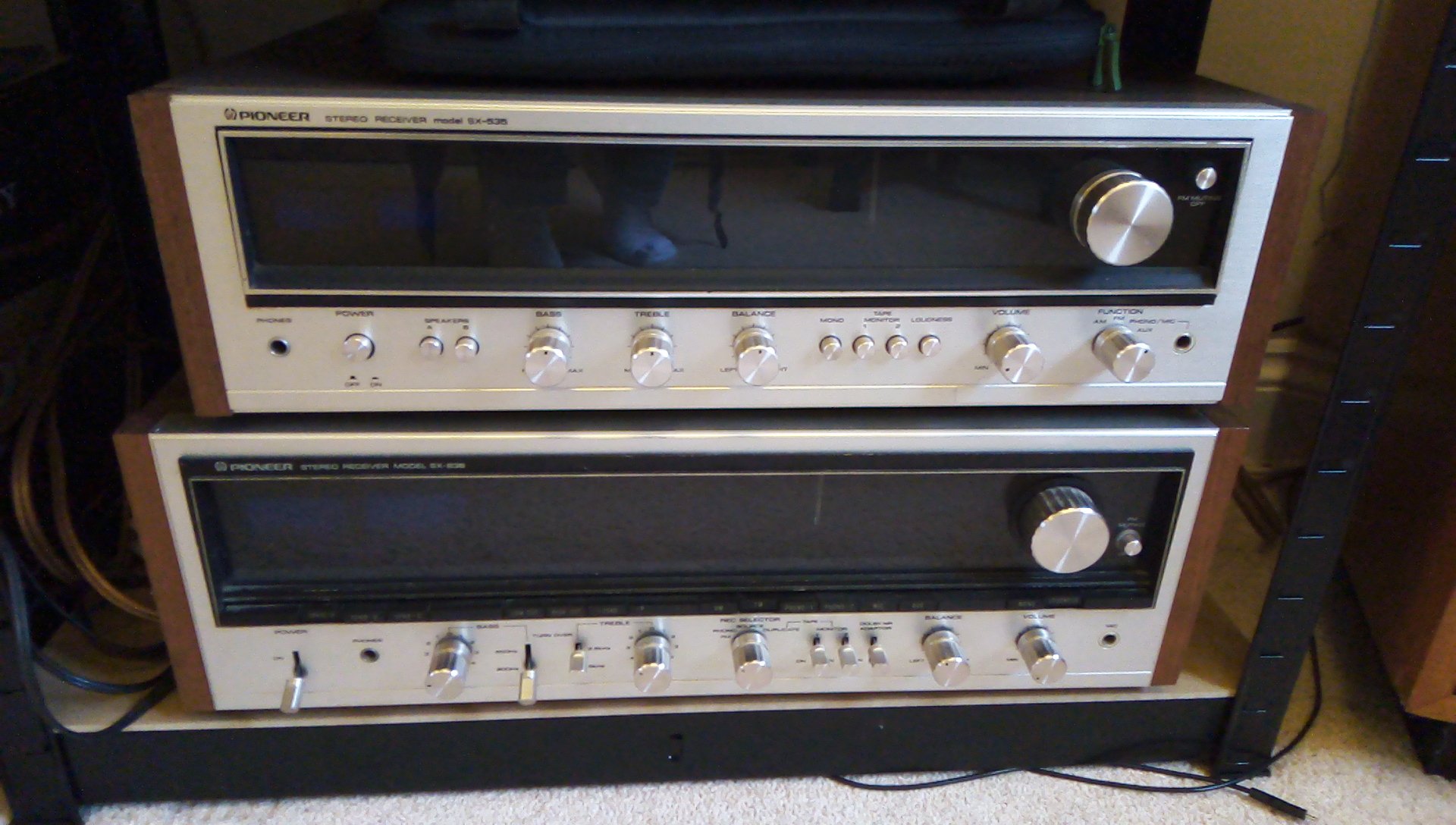

This was the situation when I started liking HiFi. About the era of the Pioneer SX838 (which now needs new driver transistors), when Pink Floyd came out and we looked around for the helicopter landing 🙂
Now of course, I'm coming to understand that almost every single aspect of life was better back then, and like someone else commented earlier, if there was a time machine I'd be racing for the door 🙂
I have a dead one here. 🙂About the era of the Pioneer SX838
There will be a stampede, so be careful. 😉and like someone else commented earlier, if there was a time machine I'd be racing for the door

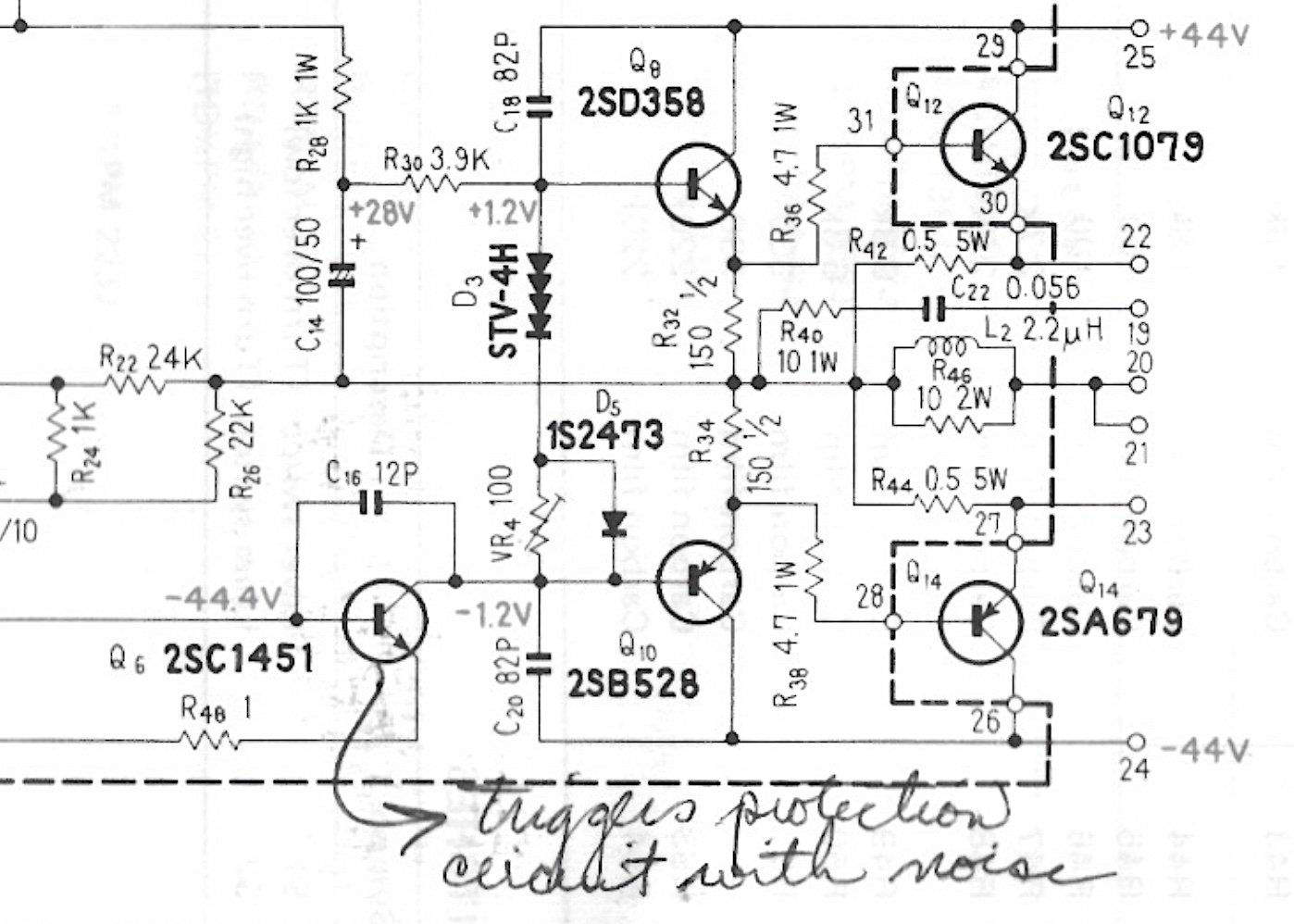

I watched a few youtubes on the SX838, the driver transistors go bad (on many Pioneers of this era, and the 550 perhaps too IIRC), mine started just kicking the protection out.
I'll fix it as they look magnificent, and sound good enough for a casual room too!
Not sure what transistors to go for yet though, some where a bit unobtanium, but it can't be that difficult !
What state is yours in?

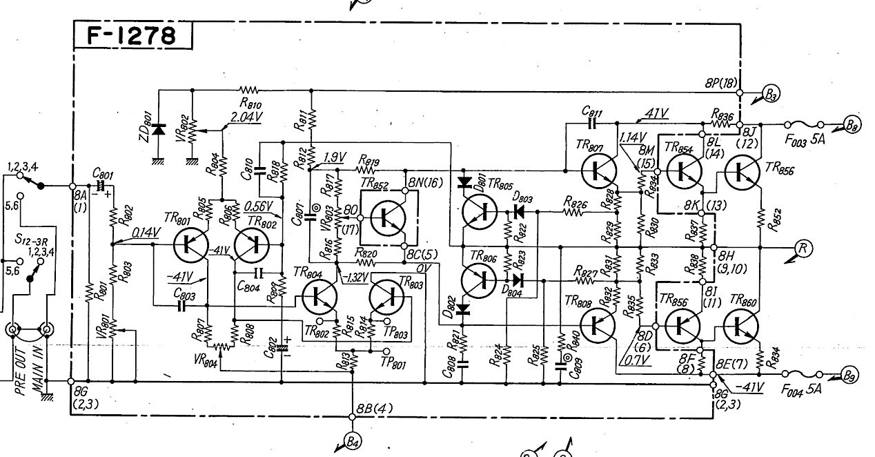

It lights up, relay clicks, the power supply checks out, but the output stage is cold as a cucumber. That's as far as I got with it. I have to fix my 636 first.What state is yours in?
2sc1451 transistors are known to fail in these amps. The BOM's for these amps show KSC3503dstu as a replacement. They appear to be in short supply now. I should have bought some years ago, but of course procrastinated. 🙁 Maybe Chris knows of another suitable replacement for these?

Pioneer ran parts close to limits and hot quite often. H-K does the same. Upgrade the drivers in power and current, watch voltages since our mains are higher than they were back then. Modern output transistors might improve performance too.
I would definitely upgrade them. I would need an SX-838 in front of me, and it would leave much higher in performance.

838, 636 ... I have a little SX434 built into my bedside table. It sounds pretty nice playing through a pair of HiVi B3N's (Zaph's design). Nearfield, the limitations of these doesn't matter.
Ah yes, the dreaded 2SC1451, I see here in my schematic someone has even added a comment 🙂2sc1451 transistors are known to fail in these amps.
I wonder if a 2N5551 might go in there, perhaps doubled up or heat sunk? I don't know how precious the circuit is for the exact parameters of the original, digging up a datasheet for the old one was somrthing I tried a while back but didn't succeed to my satisfaction.

I have the 535 too.. I like they way these are all dark, and then come to life when switched on, better than Christmas lights 🙂
I think this is a good example of THD's failure to quantify sound quality 😀I recently serviced a Sansui 8. Even after repair it didn't perform that well to be honest.

It's noticeable that many amplifiers of the time that make wonderful music, are in the 0.2-0.8% THD brackets, because back then stability mattered, and no one really cared so much for THD. It's an interesting schematic, lots of LTPs with complimentary stages up to the output where it goes quasi. High power PNPs being rare then I guess.

But I suppose I already knew this, looking in the top of the Sansui 1000a is an object lesson in the freedom to build decent stuff in the past 🙂
