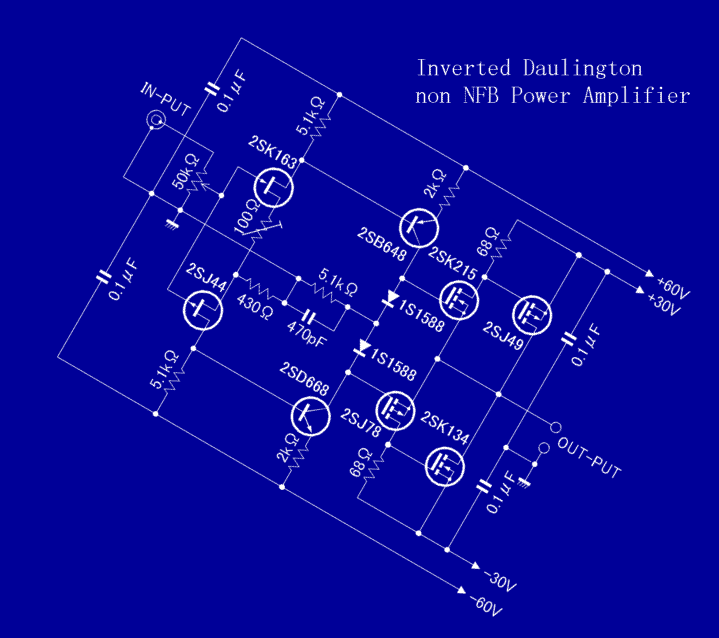

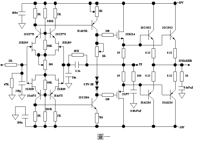

Christer,
You make some good points. I try to avoid cascodes when I can but somtimes you have to when using j-fet inputs. Now folded cascodes are another matter. I think they are great.
As for the diagonal schematic.........I was trying to throw Steve Eddy off ..........no that is the way it was when I pulled it off the web..........I could correct I think if that would please you.
Jam
Jam

Jam, the second circuit you posted has a feedback loop that encompasses everything except the outputs themselves. The divider network is unusual in that it is a *capacitive* divider instead of a resistive divider. This is made possible because of the use of JFETs. The 30 M resistor gives 100% feedback for DC.

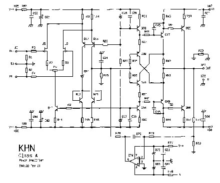

Hey Jam, do you *ever* run out of these things?
Kind of an interesting circuit, and it fits in the thread if we ignore the CFPs in the output stage (like the first schematic you posted).
The pre-drivers have an interesting twist I've not seen before. That first set of emitter followers has current-source loads, which (on paper at least -- I've never actually tried it) are required to get good performance out of that configuration. But the interesting thing is that collectors don't go to the opposite rails, but instead are configured in a quasi-cascode / quasi bootstrap configuration that keeps a relatively small and constant voltage across them.
Wonder how it works... have you ever built or heard this circuit?
Charles Hansen said:The divider network is unusual in that it is a *capacitive* divider instead of a resistive divider.
Why do you suppose anyone would want to do that?

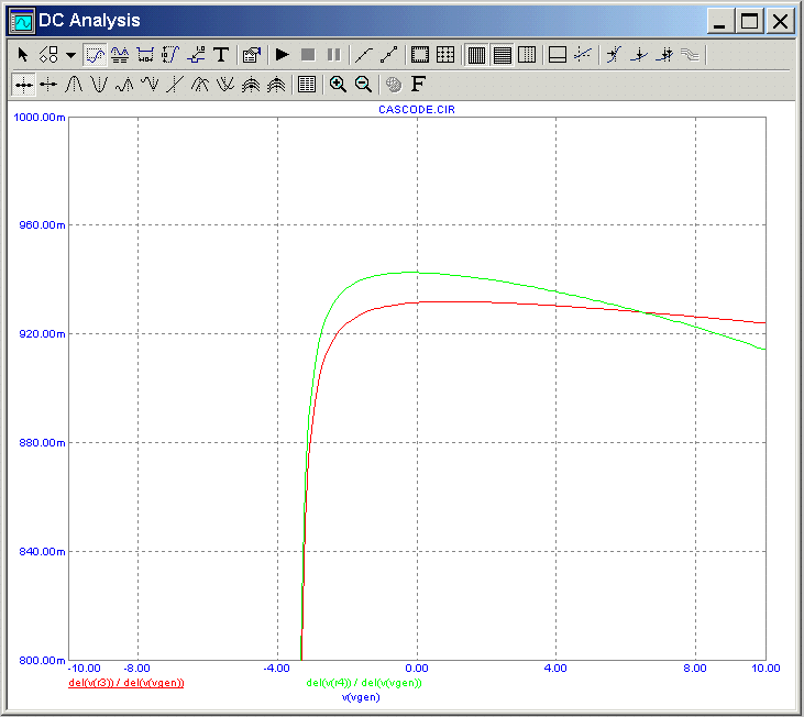

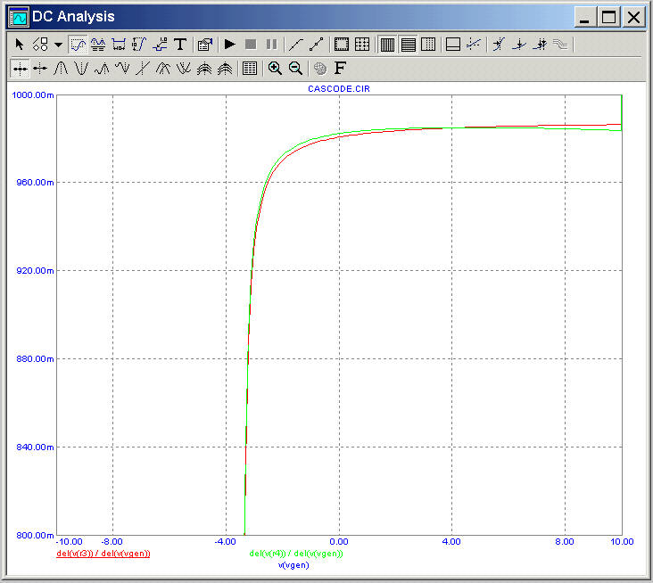

Hello Nelson,
Again, I partially agree with what you are saying and partially disagree. On the Pass Labs website, there is a white paper that shows a marked degree of distortion reduction by using a cascode on an emitter follower. I decided to go ahead and do some simulations to see if I could verify your results.
I used the same circuit and same voltages, although the output device used was the MJL3281 (since I happened to have a model for that handy). The graphs are in the form found in Douglas Self's books, where the output stage is swept between +/- 10 VDC to look at the basic linearity of the circuit. What I found was that there isn't all that much difference between the simple emitter follower and the cascoded emitter follower.
Using a generator impedance of 50 ohms, I got the following result, where red is the cascode and green is the simple emitter follower:
(continued from previous post)
So the cascoded circuit can seen to be flatter (more linear) in this situation. (Please note the drop off at the left side of the graph is because of the 500 mA current source specified in your article. You didn't specify a load, and I arbitrarily used 8 ohms.)
But if we change the generator impedance to 0 ohms, the situation is reversed:
